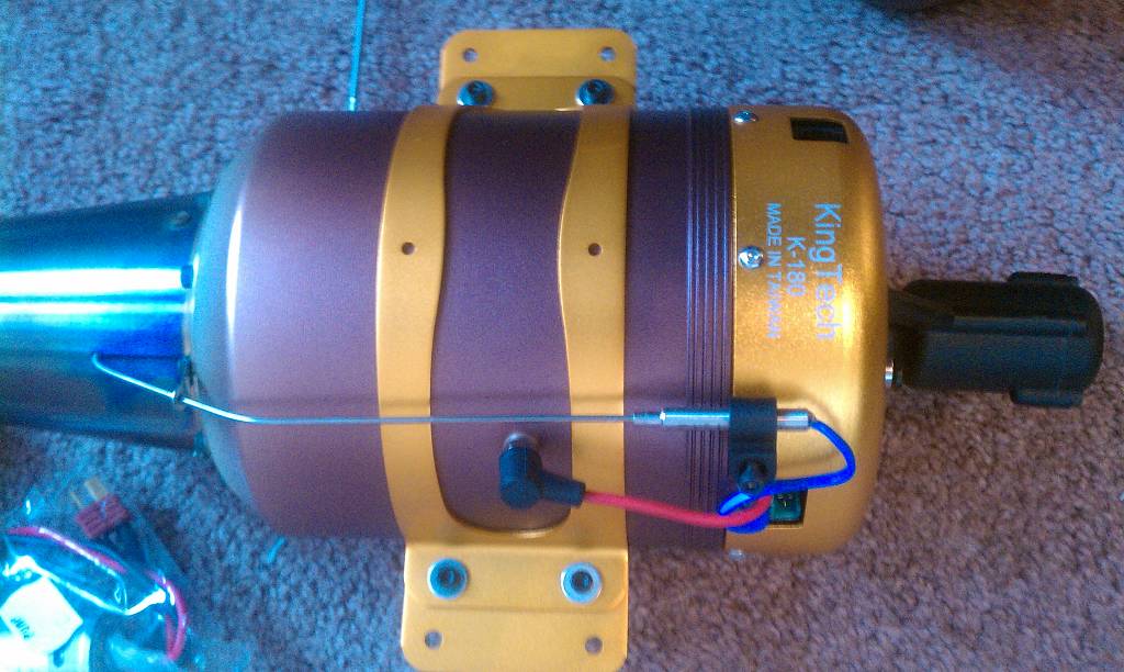

The new K-180 propane version tested and proven 38-40 lbs thrust @ 123k, Barry you the man [8D]

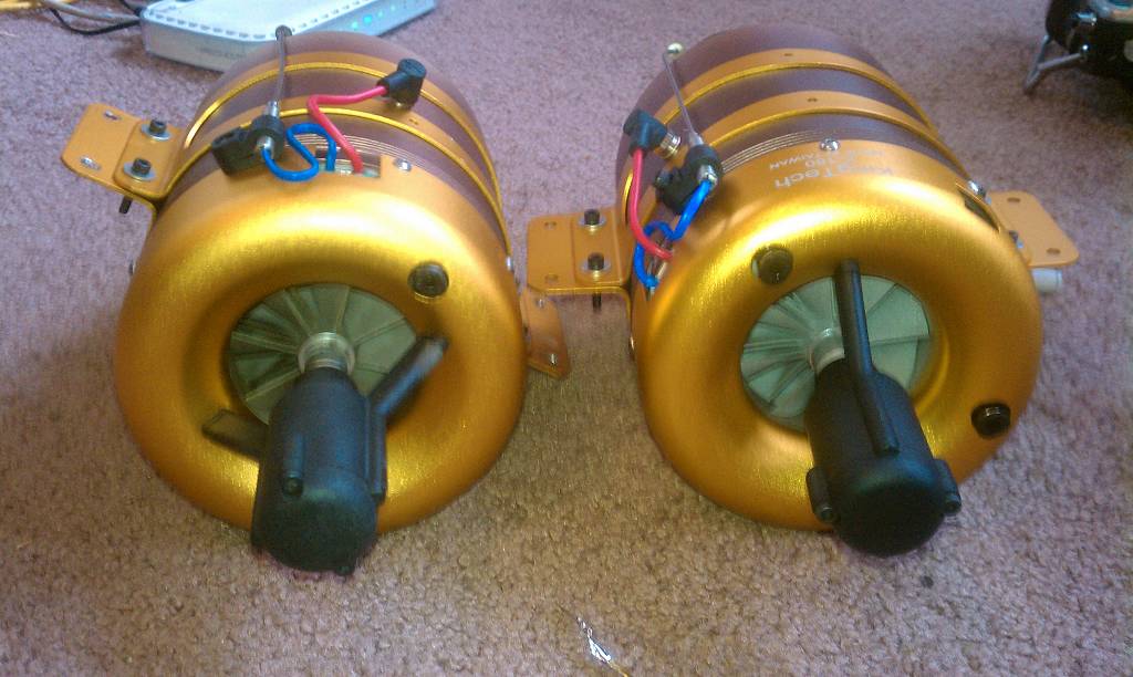

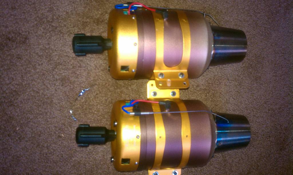

Looks the same, weight almost the same i think P.S at first I thought the k-180 was a turned up K-170 and almost get into an argument with Barry until he convince me to test the engine Wow what a power house

I was hoping for 45lb to 50lb for 1/5.5 f16. Need to rethink next jet

ORIGINAL: Wap4life
The 180 is a slightly optimized 170, so I'm not sure why you would expect 45-50lbs. You wouldn't get those numbers until the Kingech 2xx.

WOW! 780C EGT. Seems high to me.

ORIGINAL: T.Oertel
That's my fault If you look carefully my temp probe was not screwed down and was too far inside the cone, What amaze me was at full power the tail cone barely glow red

ORIGINAL: basimpsn
ORIGINAL: T.Oertel
We are trying to device something that will prevent the probe to go in deeper than what's required at 2mm into the cone. A 180 is running slightly hotter than a 170, but at full throttle shouldn't exceed 720C.
