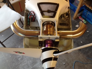

Hi all
Just thought i would post some pictures of my siai marchetti 260, I would like to thank Ali for all his help with the engine conversion!Like Ali said the conversion was not too difficult to do,
Mind you i would say that seeing as i ripped off his engine install :-)
Just a few more niggly bits to do then its ready for the maiden.

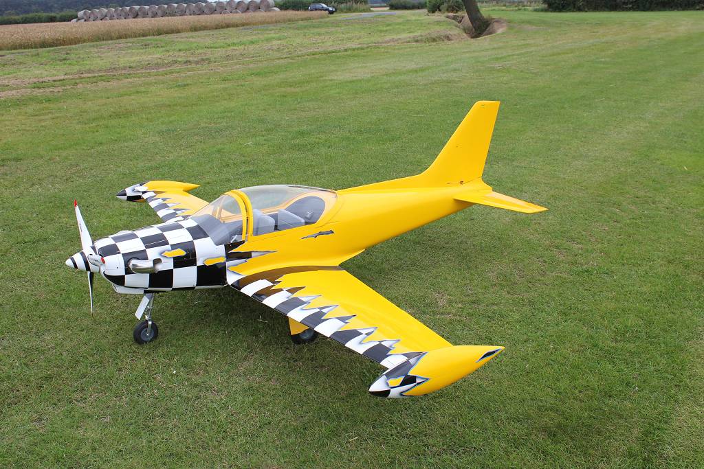

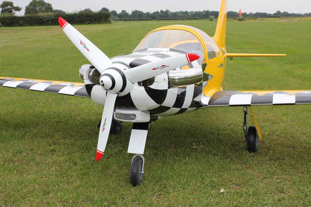

few pics of Ians Marchetti!

Old 08-12-2012 | 11:53 AM
  #41
Joined: May 2007
Posts: 43
From: leeds, , UNITED KINGDOM
Default RE: CARF Siai Marchetti
Hi
As the picture shows the installation of the TP is straight forward , you need to make 4 standoffs 118 mm long, a forward gear box mount
And on the inside of the fuzz you need to install 2 mounting brackets to bolt the turbine down.
Regarding the top vent this serve's two purposes it allows you to slide the turbine through the hole in the firewall and then to bolt it down
Onto the wooden rails, also it allows fresh air into the fuzz to feed the turbine
Hope ths helps
Ian
