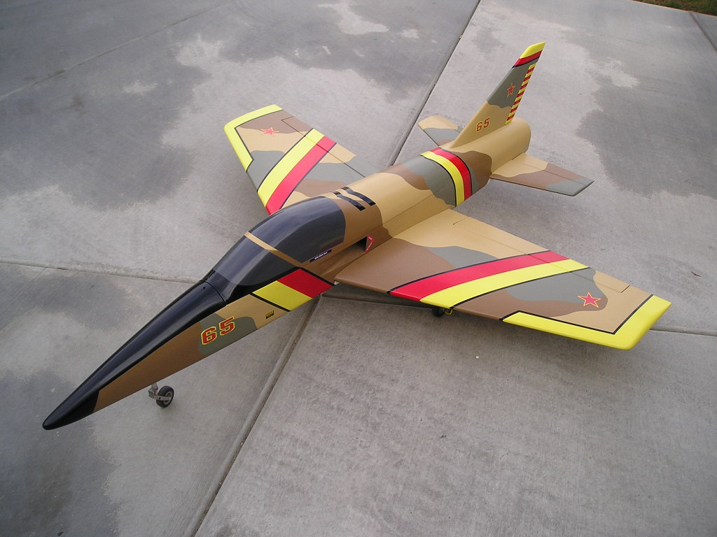

I have used flat latex exterior paint on many projects but I haven't used the SW brand, used the brand sold by Lowes. I have never used a clear over the latex because once it dries it is dead flat, very tough, can be wet sanded, is easy to repair, etc. In the photo below the grey colors are flat exterior latex. If you have any specific questions, I can try to answer them.
Nelson Hobbies and Warbird Colors sell a water based epoxy paint. I have not tried these paints yet.
Kirk

This sport jet was painted with Valspar Exterior Satin without a clear coat. Had an old part so I did try some Varathane Crystal Clear WaterborneDiamond Wood Finishin Interior Satin out of a spray can over this paint after a light sand out to get rid of the ridges at the paint lines and it did add a little more shine.

Lol, the electrons usually evaporatebefore I canwipe them off so it's all good there.
As far as kero,after the latex isfully cured it is fuel proof to gas and nitro. That's why the warbird guys use it. I haven't tested it with kero because the turbine planes I've had were pre-painted arfs but I have used it on several gas powered warbirds no clear coat.
