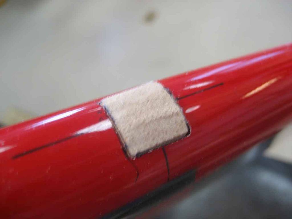

Those Skymaster hinges are poor/weak imitations of Robarts and have a history of failures. I would not risk using them. Do what Dave suggests and if necessary, cut away a larger area where the old hinge was and add a dowell or hardwood piece to drill and attach the new hinge. Here's a picture of how I did it on my Skymaster big Viper.
