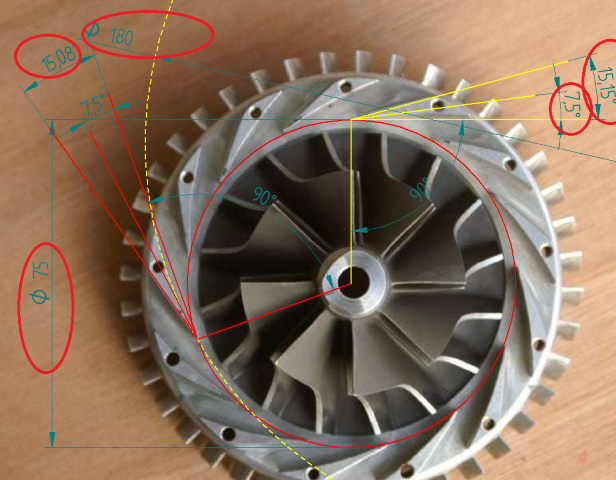

I would like to talk with you once more about your design of the diffusor. I have calculated the turbine on the basis of Thomas Kamps and there I get an angle of only 18.5° for the angle alpaha
Thomas Kamps also wrote in his book about “backward curved blades compressor“ and then to use an angle of 21° for angle alpha. For “vertical blades compressors” he recommends an angele of 18°. So the compressor I use is the same as you took.
Which amazes me is that you have even steeper angle of 22°? Or is it the angle bisector who counts?
Why do I ask? It's because I'm still fighting with rotating stall or surging when I make the compressor more effective by closing some holes and move the inlet closer to the compressor
Attached you find my drawing of your diffusor with additional angle information.
happy to hear from you
regards Lukacs

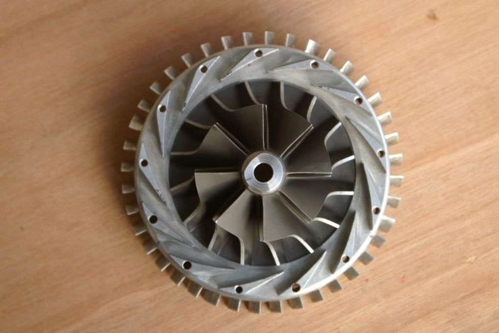

You should use the average angle of 17 degrees instead, this makes the angle quite flat.
You are absolutely correct, again, I do have to point out this diffuser has never been tested by me and was a retro fit of the older JG100 double stage diffuser. This particular compressor has a different retro curve compared to most compressors and also compared to the one Thomas refers to in his calculations. So you're in a trial and error zone here. The original JG100 diffuser has different angles as well, see picture below. As the outflow angles of the T04B compressor wheel seems quite critical I tried to adopt the angles from the older diffuser but again, never tested these. I was asked to release the plans anyway to do some own testing.
Here the JG100 diffuser using same compressor;
Compared to my GR180 which is quite different;
These diffusers are a bit of a black art within gasturbine engines and sometimes it's difficult to find the sweet spot in all rpm region where all angles coincide with the best compromise. If I would have the time I would gladly make a few diffusers with different angles and try them out. I however would be tempted to go even 1 degree flatter using this compressor to let's say 16 degrees and give it a go. If you have cnc equipment maybe make two diffusers, one +1 and one -1 and see the difference.
I hope this information helps in deciding what direction to go, I would be glad in assisting you on any thought you have.
Kind regards,
Gerald

Thank you for this photo. I don’t know if a blueprint for the JG100 diffusor exists. If one exists I’m very interested to get it.
So I did a little bit reverse engineering. I found a lot of interesting things…
The alpha angle is probably 15° or 7.5° that’s quit flat. Flatter than Thomas recommends for “perpendicular blades compressors”
Then there is a bigger “blade free zone” probably 75mm which makes the diffusor less aggressive. It looks that the JG100 diffusor is strongly oriented on Thomas Kamps
My quintessence: Maybe I should build this compressor
Regards Lukacs

I have no drawings for this diffuser, if I had I probably used this as reference for this engine as well... This diffuser is based on the KJ66 diffuser so outer blades would probably be almost the same, you have KJ66 drawings? I think the US built RAM1000 and the Australian TJT3000 from Chris Mounkley are identical so if you can find some info on those....
