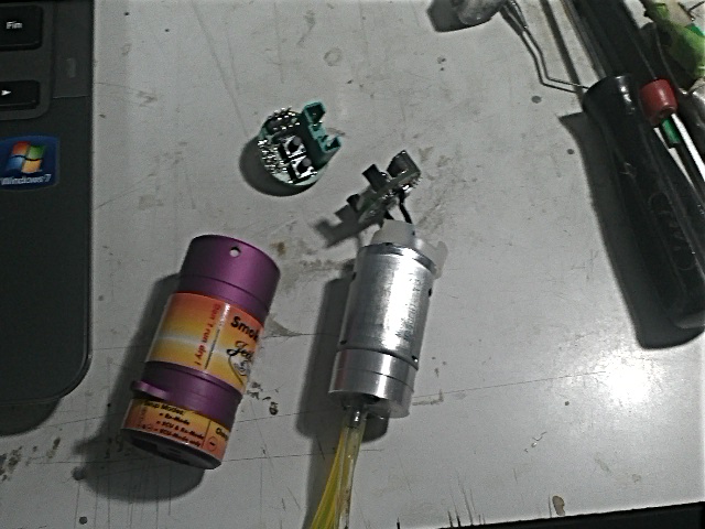

I just went through this with a Jetcat pump. I replaced it with a Skywriter.
Old 11-21-2012 | 08:24 PM
furloughed ual's Avatar
My Feedback: (31)
Posts: 1,575
From: VA
Default RE: Jetcat smoke pump
The pump is great...one of the best on the market for producing great smoke. The problem is the circuit board. Loosen the Allen screws on the pump casing and pull the pump and control board out. Look at the back of the board. Chances are there is a circuit there that you will see has burnt thru. U can reconnect it by soldering a small connector wire. That sometimes works. The other solution most do is to just use an electric motor ESC and connect that to the positive and negative leads of the pump and run it via the ESC. It will produce great smoke this way. I know it's a pain, but a much better and cheaper solution to throwing it in the trash and buying something else.

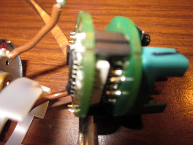

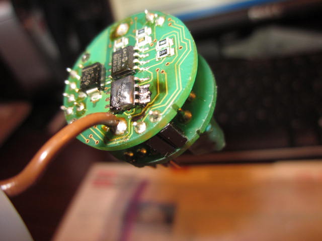

HI:
I dissasebled the pump and found a microchip broken. Where exactly should the small connector wire be soldered? I tested the pump connecting a battery directly to the + and - terminals and it works fine but without speed control
Attached are two pictures, The microchip broken is the one that is on topofthe two that are together
BRG

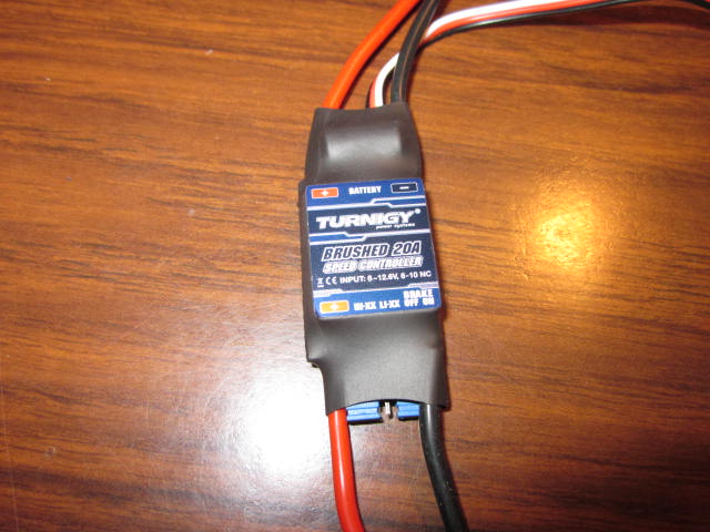

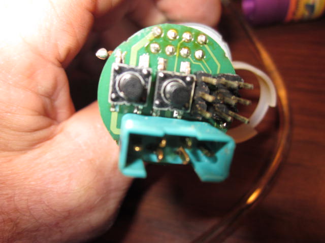

Old 11-23-2012 | 08:55 PM
rcpete347's Avatar
My Feedback: (251)
Posts: 2,461
From: Bolton, ON, CANADA
HI all, Afterburner 1 is right, Jetcat circuit boards are crap, replace with brushed 15-20 amp turnigy speed control, really cheap from Hobby King.

Old 11-24-2012 | 10:22 AM
Guillermo Ibanez's Avatar
Joined: Nov 2004
Posts: 977
From: BarranquillaAtlantico, COLOMBIA
Well, I took the pump to an electronic technician and he said that this microchip is a diode. He changed it for e new one but the pump did not work.
I am going with the RC Pete suggestion of installing a speed controller.

OK
I did the RC Pete suggestion:
Just one word

ORIGINAL: rcpete347
Rcpete
rcpete347,
Could you please give more details on how exactly did you install the Turnigy ESC (where was it soldered, what parts did you remove from the jetcay smoke pump and how does it all look after the mod.)
Thanks in advance,
Old 11-26-2012 | 01:42 AM
quist's Avatar
My Feedback: (198)
Posts: 3,327
Received 9 Likes on 5 Posts
From: Glendale, AZ
You solder the esc wires directly to the terminals on the motor.
Old 11-26-2012 | 06:24 AM
Joined: Jan 2004
Posts: 1,382
Received 14 Likes on 12 Posts
From: BeirutBeirut, LEBANON
Thank you. Therefore, all other electronics should be removed, correct?
