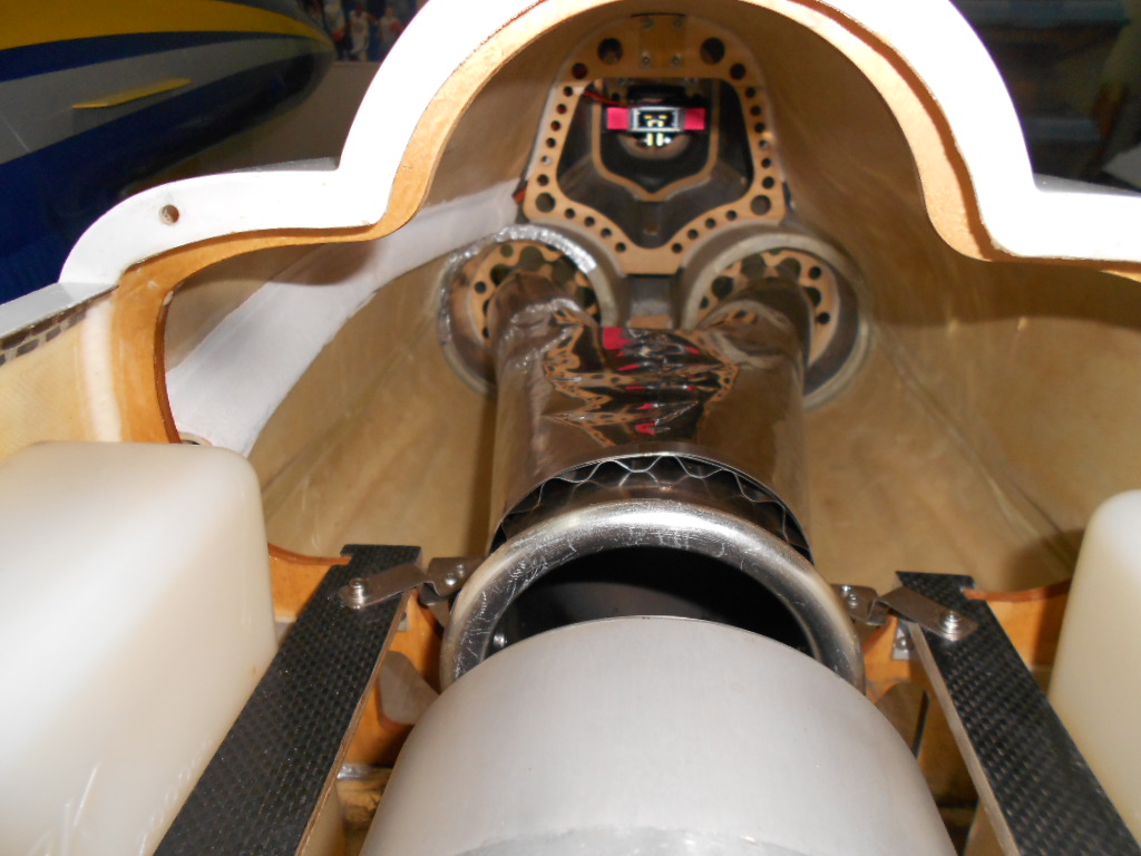

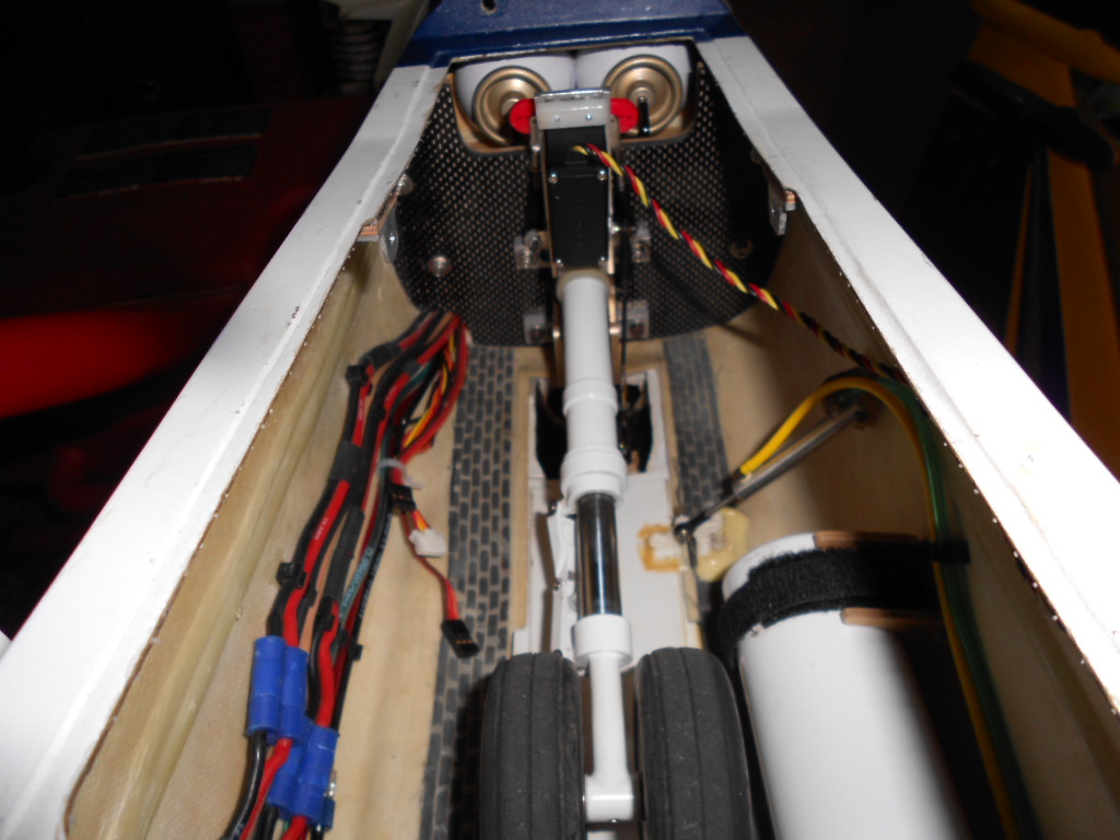

Old 04-30-2013 | 05:26 PM
Countryboy's Avatar
My Feedback: (25)
Posts: 2,657
From: Lawrenceburg, KY
Default RE: An Exercise in Install Practice....
ORIGINAL: GSR
I am with Jack- I will go with serviceability over pretty any day. Scotty
PS and that is not just an excuse for an ugly install
I'm not saying it's pretty, but I will take tidy over that spaghetti mess anyday... even if does make it a ;ittle harder to service.
