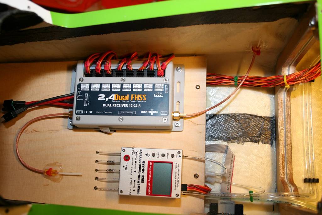

I don't understand how somebody hasn't come with the idea of making a video with a step by step buildup of a jet. There's a lot of us out there that could benefit of this kind of information and learn from the masters. For some people, servo installations, linkage, powerboxes, programming, etc could bee seen as an easy thing, but for sure for several people is not.
In other hobbies (like plastic model airplanes), there's plenty of videos available that will guide through the complete buildup and painting process. Those videos are very popular and sell very well. The important thing is that it allows somebody that is completely new to the hobby to come up with a nice decent model without having experience at all.
We are always talking about safety and a good assembly video could be a good way of making sure that people are aware of how things need to be done in order to prevent accidents.
Somebody wants to pick up the ball ?

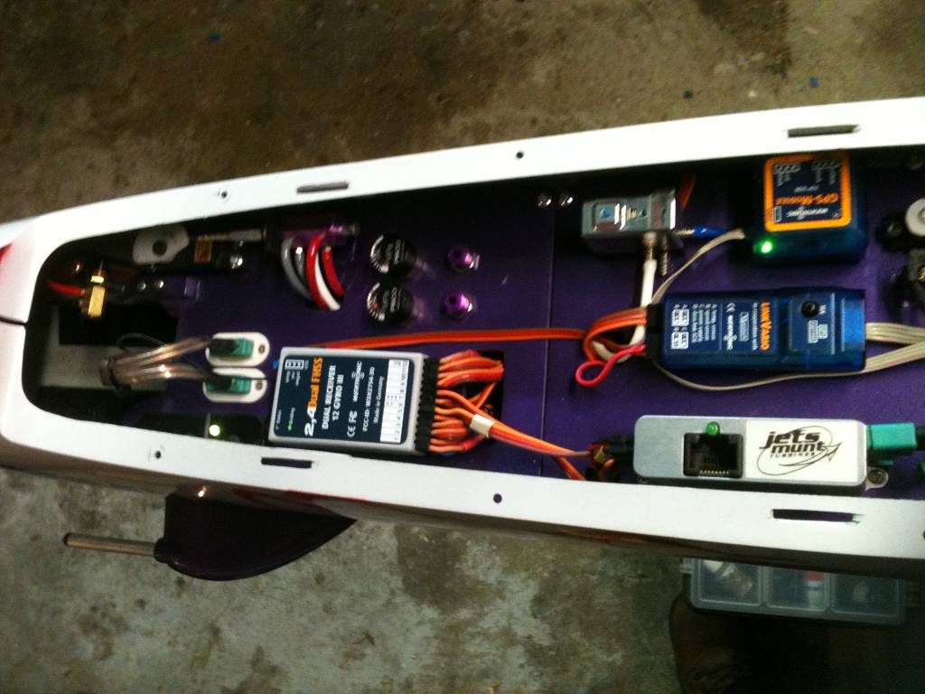

ORIGINAL: Carbon-Customs
This was my install in my former SM Hawk 100
As in that install is crazy nice!...
Z
I notice "Former" in the description, has it been lost?

ORIGINAL: lov2flyrc
Beautiful install Kasper! Very creative layout! That Carbon would concern me just knowing it could create an issue
I notice ''Former'' in the description, has it been lost?
yes. i made a landing i wassent sattisfied with, i took the desision to go again and make a better, but i forgot how short the grassfield was, i never made it, i ran down into a ditch in the end. and the fiberglass was dead. i wanted to make a new with just the fiberglass piece from skymaster, but they wanted 2600$ for bare fiberglass. so i sold the gear.

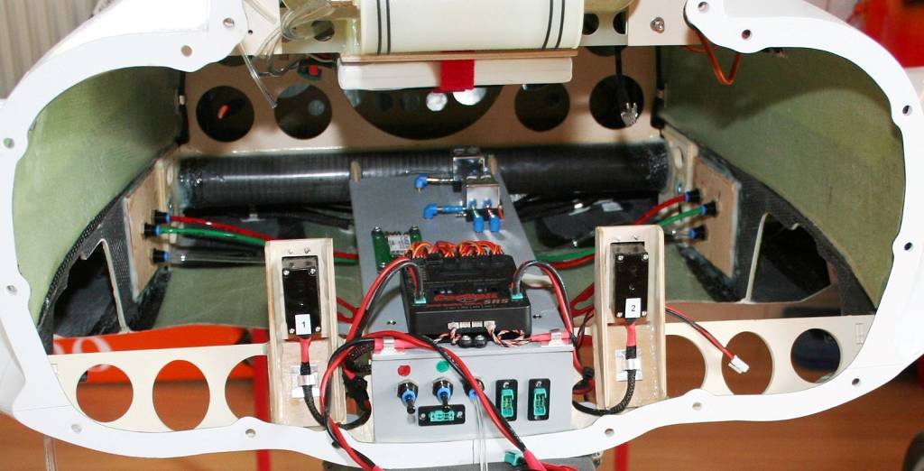

I personally have not experienced a confirmed static discharge problem, BUT, have had a receiver issue that might have been static related. I would be very interested in any practical advice on how to avoid it.
You suggest we should try to avoid crossing of wires and fuel tubing, or keep a few inches separation.
I think that this would be impossible on all but the biggest jets. (You would need a cavernous fuselage.) Certainly impossible with a Bandit or Flash. And it is obvious that most of the “Nice” installs in this and the other thread have fuel lines and tanks/UATs right next to Rxs, ECUs and their associated wiring. These jets obviously do no suffer from it.. Static discharge seems to be almost a randomly arising issue!!
My Bandit install below..
And FWIW, I put the shut off valve after the pump..
A
