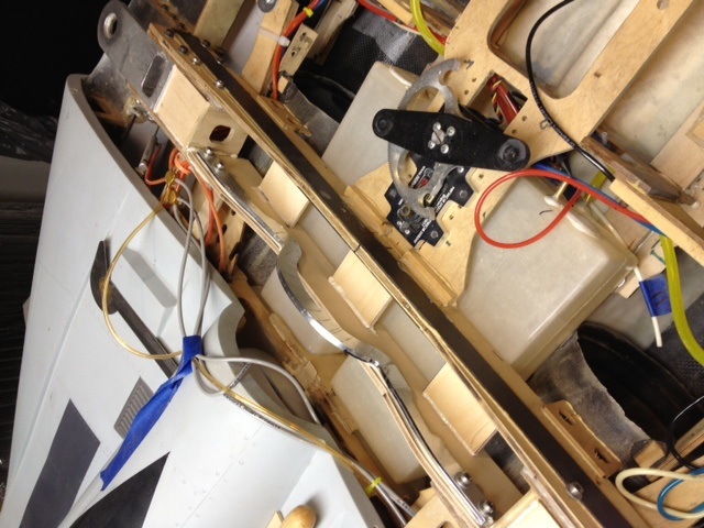

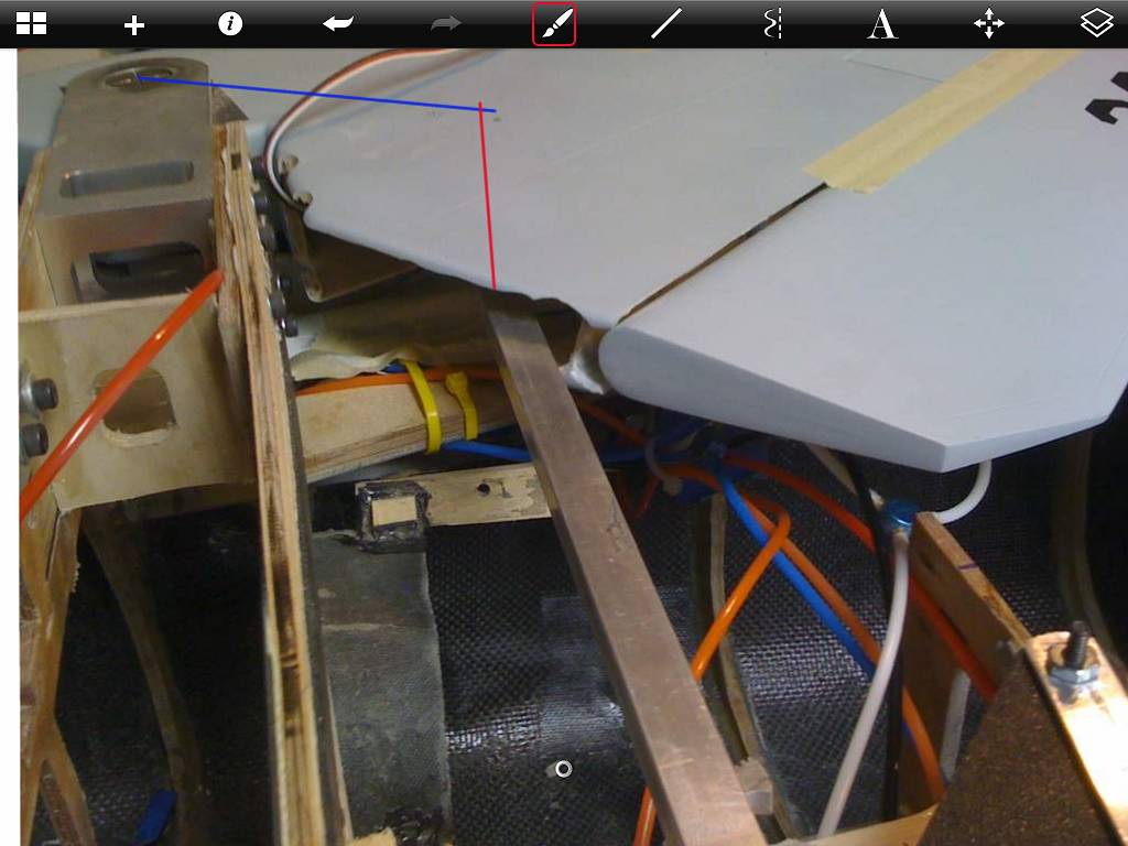

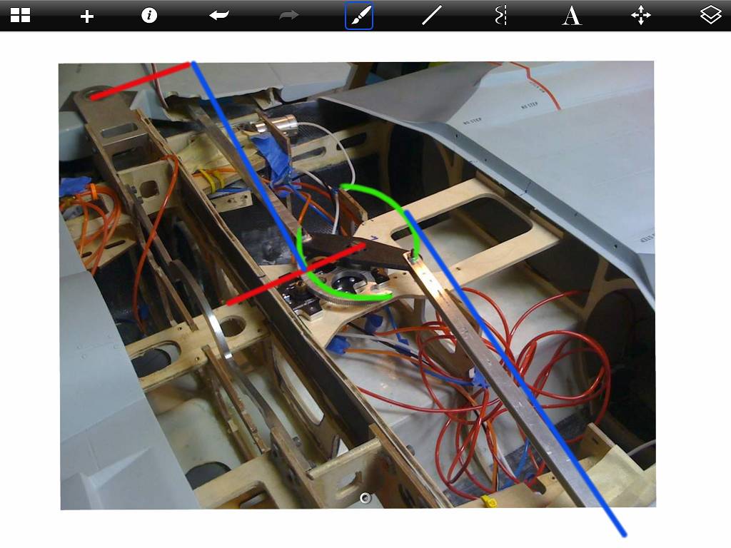

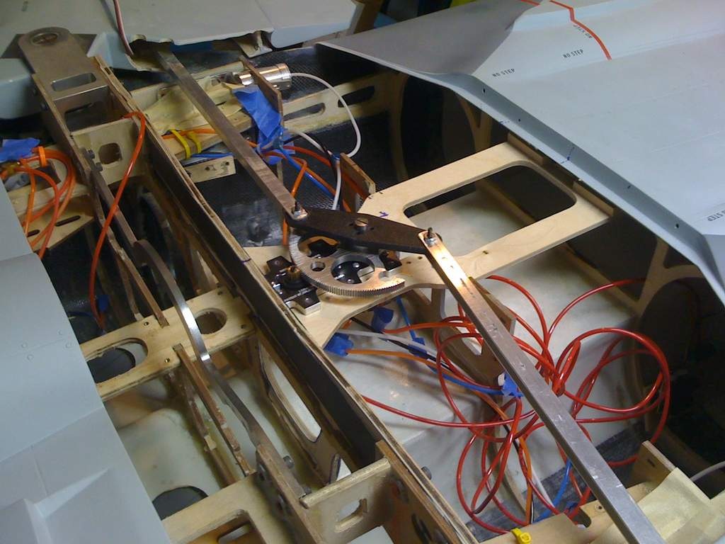

F-14 swing wing design. I don't have the demotions with me right now but will post tomorrow. Here are pics

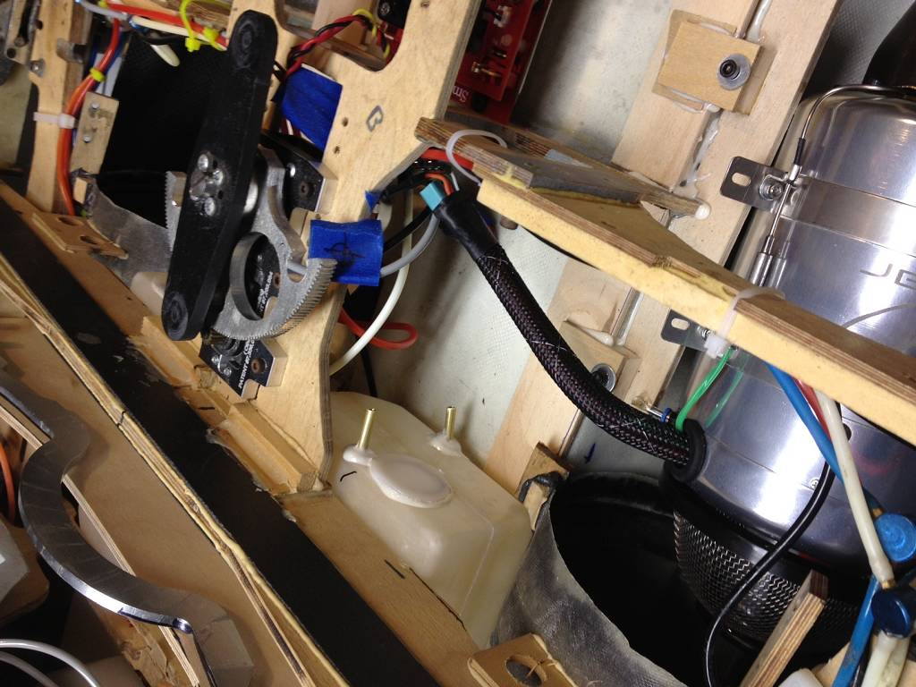

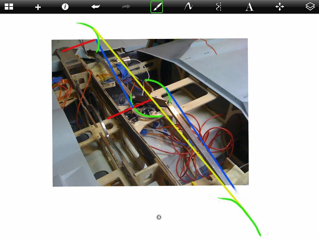

The geometry is identical on each side so they have the same rotation. the shaft in each wing is the same distance from the wing pivot.

Jim, your swing wing mechanism is robust and 1000 better than the stock mechanism! You should sell a retro kit for FEJ F-14s.
Yep I'm stuck with these planes so will make them work!

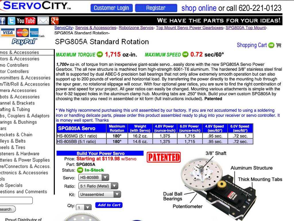

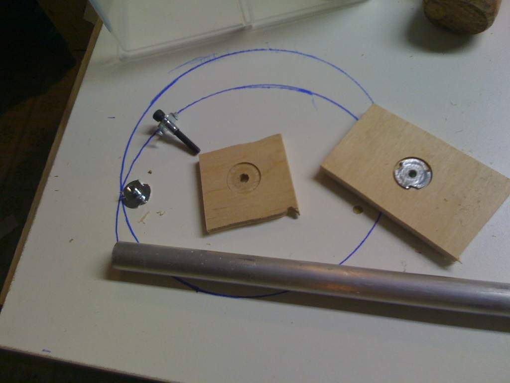

Main thingvwith the geometry is that All the green arcs are the same distance and are in line with each other along the yellow line. The servo is from servocity.com mine had a 15:1 ratio they are only selling 5:1 but you could talk to them to make anything you want.

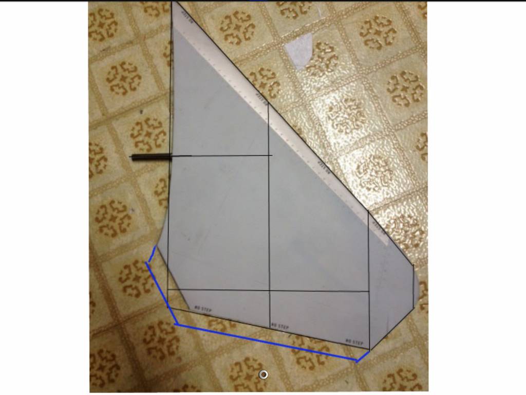

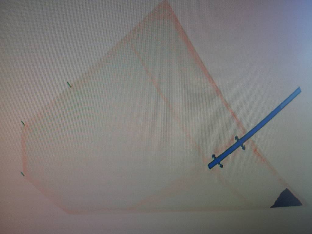

As calculated by me and others online the pivot point for the F-14 1/7 is at 25% MAC and to get 22.5 or 20% I can build a new stab would be fun to do but I have no time left before Kentucky jets or ... Just add some area with balsa and light glass skin to the back edge.

Old 05-27-2013 | 10:56 AM
  #91
Posts: 4,586
From:
Default RE: Redesign/build FEJ
ORIGINAL: EDFJim
Jim
You do the elevator set like my rudder set from my 1/8 scale.
That set up doesn't matter much with the pivot point.
Jim,
If you provide me some dimensions of your stab, we can see if the ones from mine couple be retrofitted to fit..

Ok will post exact dimensions

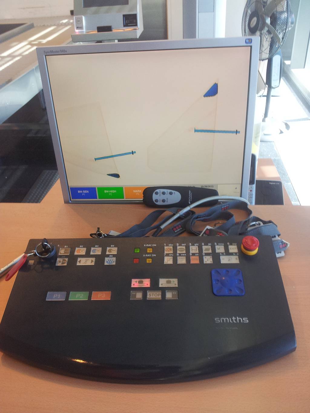

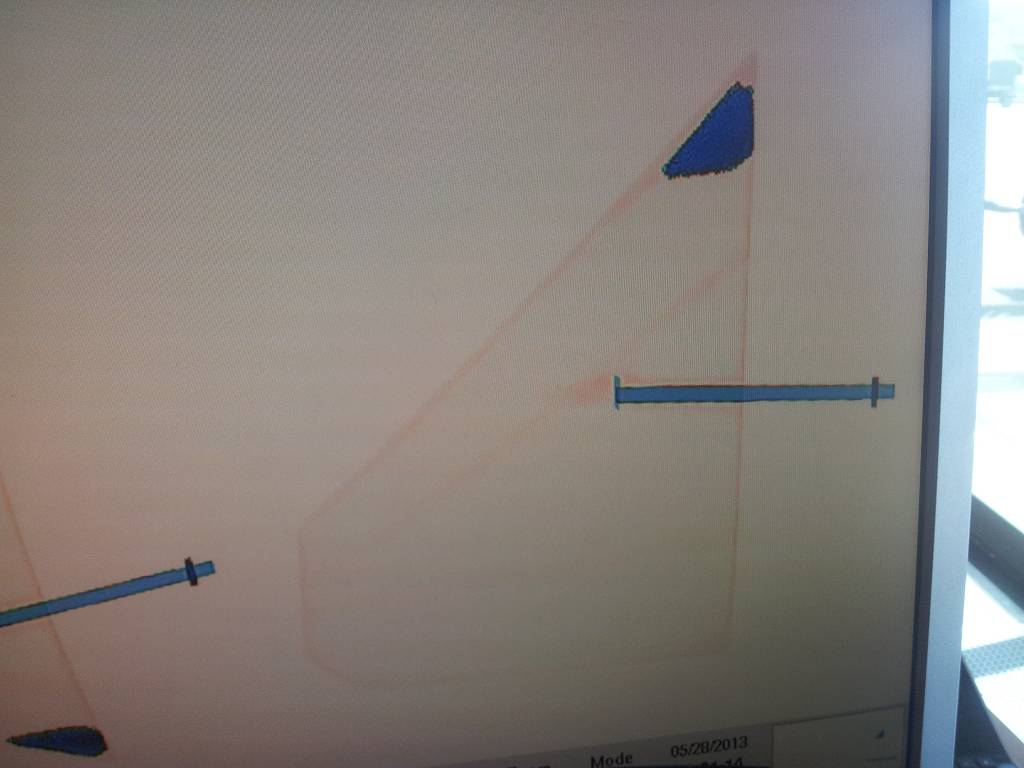

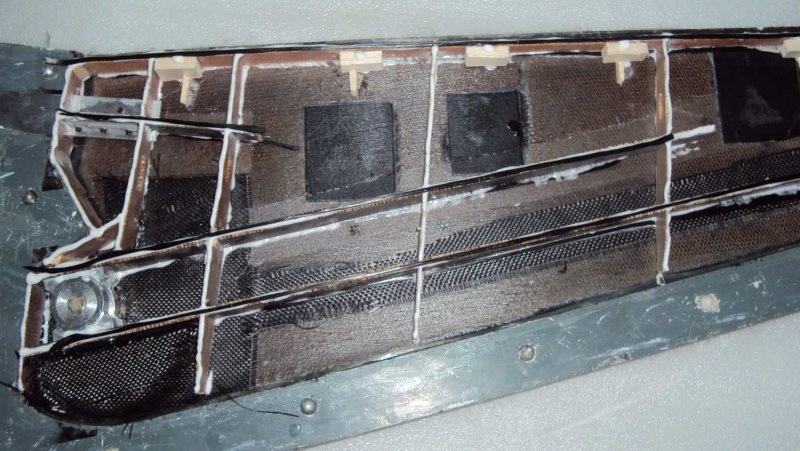

Visited security at work whith some elevators, and here are some pictures from the screen.
Those two are Skymaster 1:6 scale F-16 and FEJ 1:4,6 scale F-16.
Note the shaft, cross-pins and led for balance. FEJ is the one with two cross-pins inside.
FEJ elevator here:

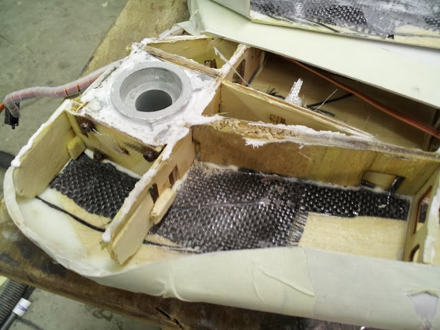

Did you have issues with your swing mechanism? Is the reason you changing it is to cut the weight down because you are changing it to electric?
Just wanted to check because i never had issues with the wing.

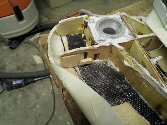

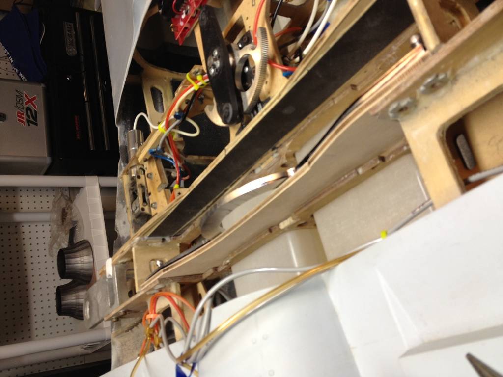

Weight savings and complex design of the FEJ system and that there jack screw goes right through the wing box. Trying to have new wings made for me but over 7 months still waiting for them, I should have made my own.
