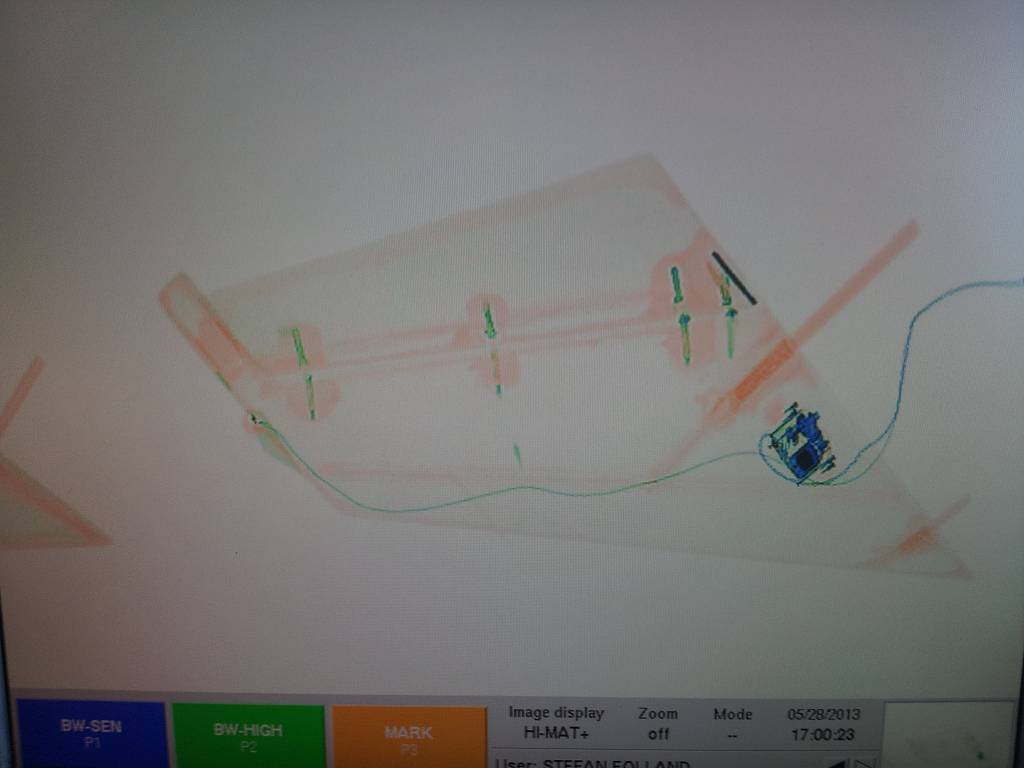

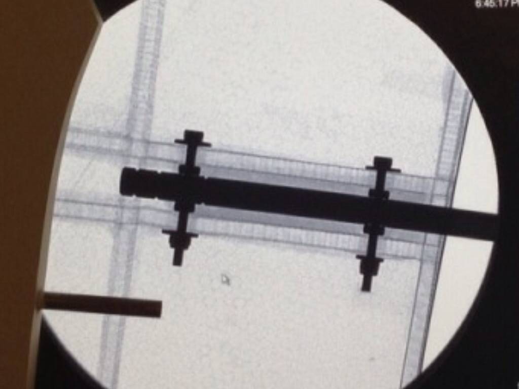

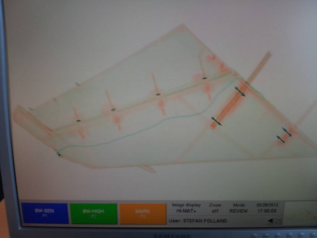

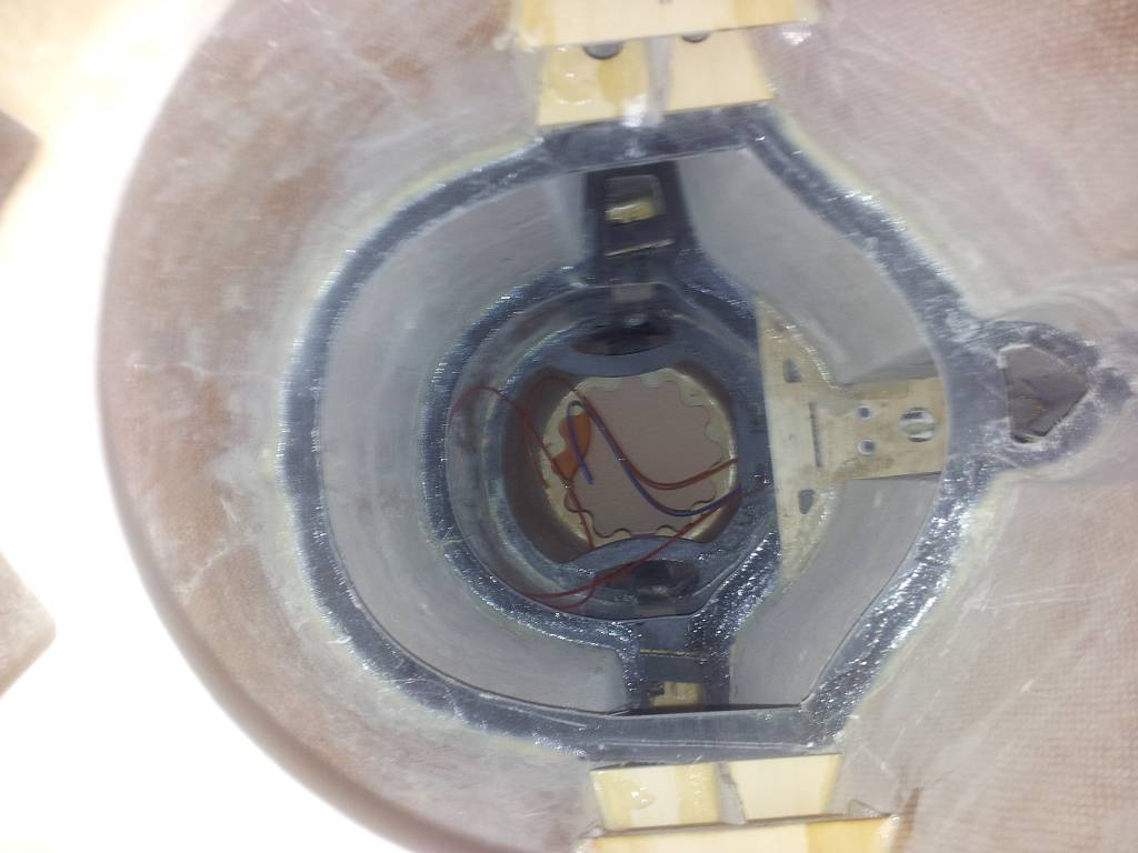

FEJ rudder and stab to the left, Skymaster to the right.
I have looked inside the elevators, and it`s hard to say if it`s HoneyComb or not.
If it is, it must me a thick inner layer on the inside, because I can`t see the pattern of the HC.
Have not checked the rudder/stab yet, and I probably won`t.
But it`s a interesting thing to see differences, how things this close in design can vary in "execution".
And a very simple way to get a X-Ray image, simply by asking security personell at an airport.
Anyway, hope it`s useful for someone.

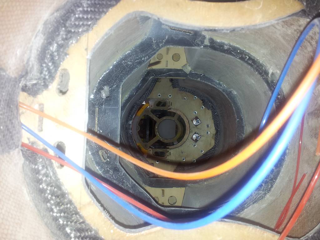

Inside my 1:4,6 F-16.
High quality and beefy ply-formers with carbon, correct amount of glue. It looks good to me.
I don`t know how earlier F-16`s is made, mine is the latest I think, really don`t know if anything is changed..
Are there HC formers in those earlier? How about yours, Ali or others?
In my oppinion, there should never be HC in elevators, formers behind TE of the wing, rudder-stabs or anything that`s ment to be beaten.
Btw, I drove up and down the 2200 meter runway with my balanced (slightly nose down) FEJ elevator today at +150 kmh, purely in my hand as before.. :-P
Dead stable, passed..

Not sure if we are looking at rudders or stabs but..
FEJ - sub-rib is good but no spar running length.
SM - no sub-rib for main spar but they have another spar member running the length creating a D box. But they should have added a sub-rib.
SM looks like they added more significant material for the hinge points and another spar in the control surface(FEJ provides nothing again) but neither is quite satisfactory to me. Again close, but no cigar.
Old 05-28-2013, 11:12 AM
  #107
Falcon 64
Falcon 64's Avatar
Join Date: Jan 2003
Posts: 1,172
Default RE: Redesign/build FEJ
Yes, agree. But somehow interesting to have a look inside.
The "funny" thing is to me that FEJ have locking-pins on a shaft that`s not ment to give and resist torque, while Skymaster have "no" such things but a tiny tad at the tip (elevators). And Skymaster have all the torc centered in the shaft. That`s why I thought this was useful info to those who plans to do a push-pull instead of the direct drive.
FEJ does so even in the rudder/stab, cross-pins.
How come? I don`t know.. Better safe than sorry is one way of putting it :-P.
But I really can`t see anything in my F-16 that is off limits, the way I received mine. The way it`s now, after 180 grams in each elevator.
Other oppinions?

You might wanne be carefull zapping the servo, electronics are very sensitive to radiation and can get erratic.

Thanks for the info, I will despite mye cellphone have survived a hell if it`s the case.
I have plenty of suitable servos.
But never heard of electronics that can`t take an X-ray, hmm :-)...
How come we willingly expose them, I mean, it should be a problem other than with servos.. :-P
A reference to it for us?

ORIGINAL: dbsonic
But I`m sure we are looking at an essence, rigidity is one thing.. There is so much into it, and the other thread will sooner or later reveale how things are, and should be.

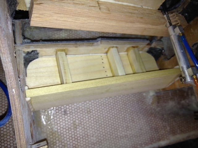

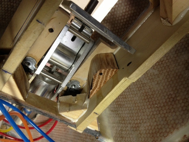

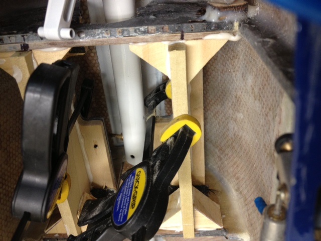

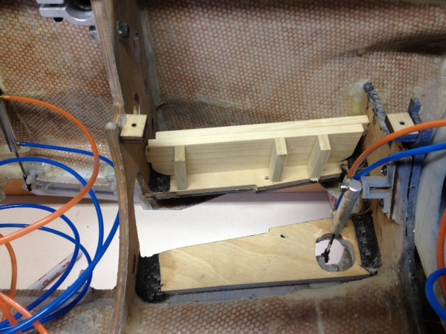

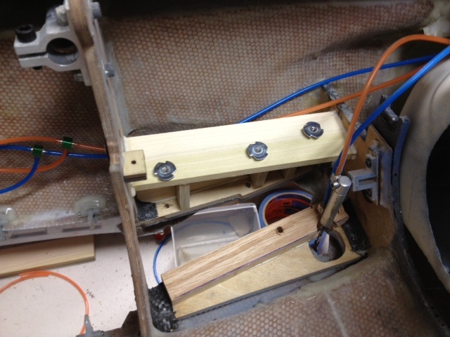

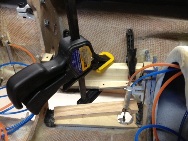

F-18F build.. Here is my build up of the main gear support a basic I-beam that transfers the load to the two wing bulkheads... The weakest point now is the bulkhead to fuselage joints or the gear bending.

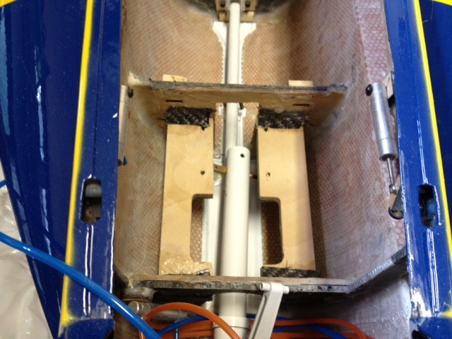

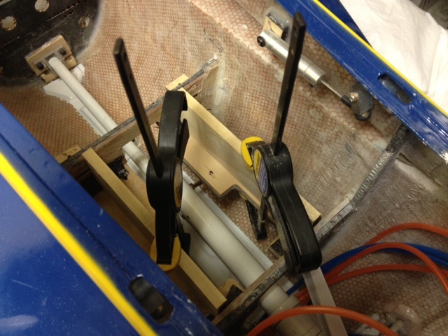

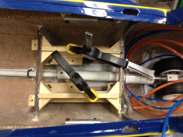

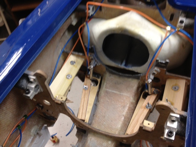

Nose gear support

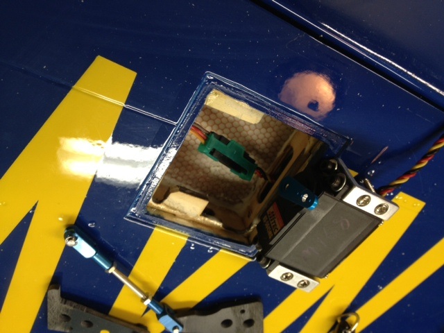

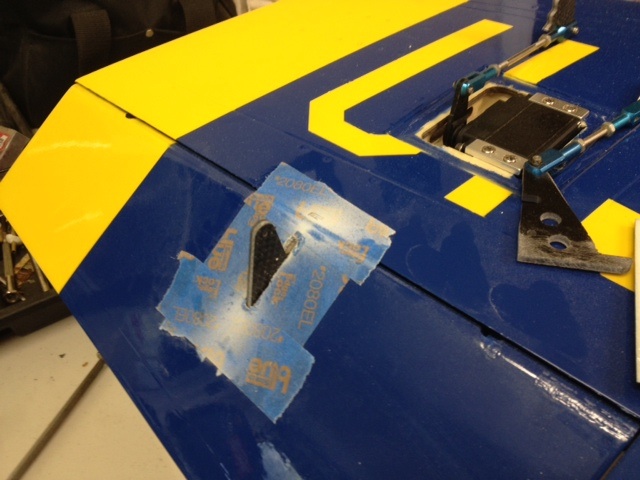

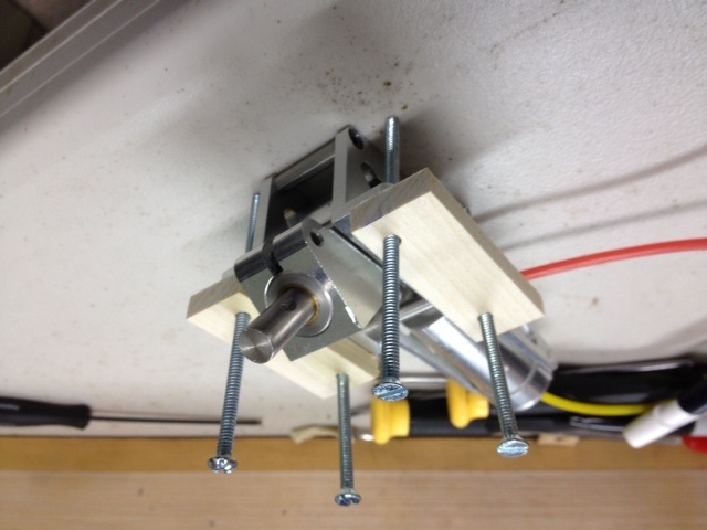

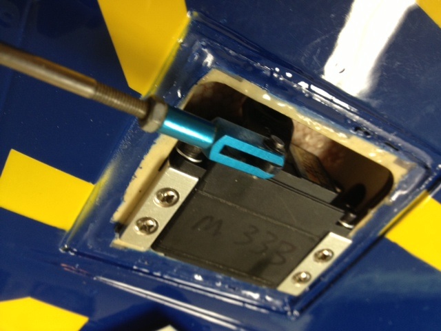

Wing servo install.. This is one major improvement that FEJ has done. On my last f-18 I had to build my own supports for the wing servos in the 2010? Early honeycomb kit ... Now they have the servo boxes in they are strong enough and the contro surfaces have balsa blocks when the CF control horns are put into place.

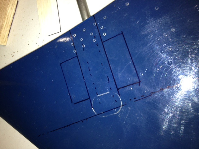

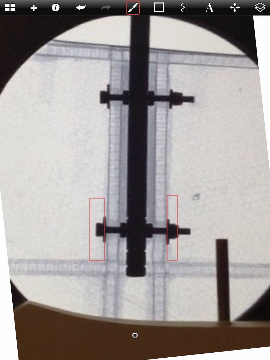

Some poor design in the stab of the F-18F 2010? Early honeycomb the bolts only go through HC bulkhead and some scrap wood under the bold for support... I put 20 hours of hard flying on this model and had the stab shafts start to come loose anyone who has this design should open them up and add support for rotation of the shaft

The new 2013 F-18F stabs weigh more and more internal structure and stiffness ... Hate to do it but I am going to cut into them also and see what FEJ has for structure and add support if needed.

ORIGINAL: EDFJim
Wouldn't you have to do this anyway because of he incorrect rod pivot point?

Actually I'm thinking off adding some area to the trailing edge to move the pivot forward a few % on the mac on both the F-14 and F-18
