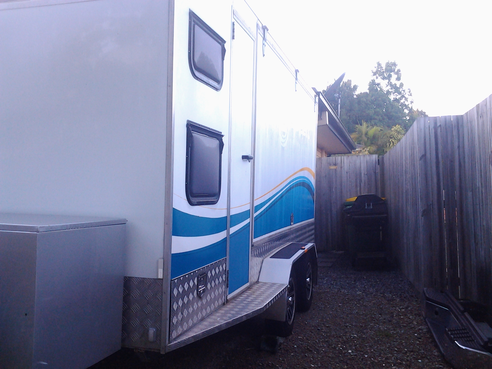

Yes is set up for sleeper cab with tv bed and aircon and also Wifi as well I will post some more pictures of it for you
Damo

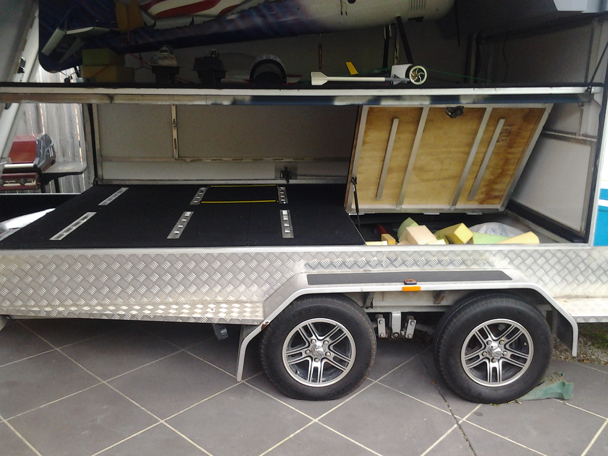

Here are some more pictures of my trailer.
Damo

Very nice

Thanks still a work in progress change things here and there plus there is more storage under the sleeper cab as well
Damo

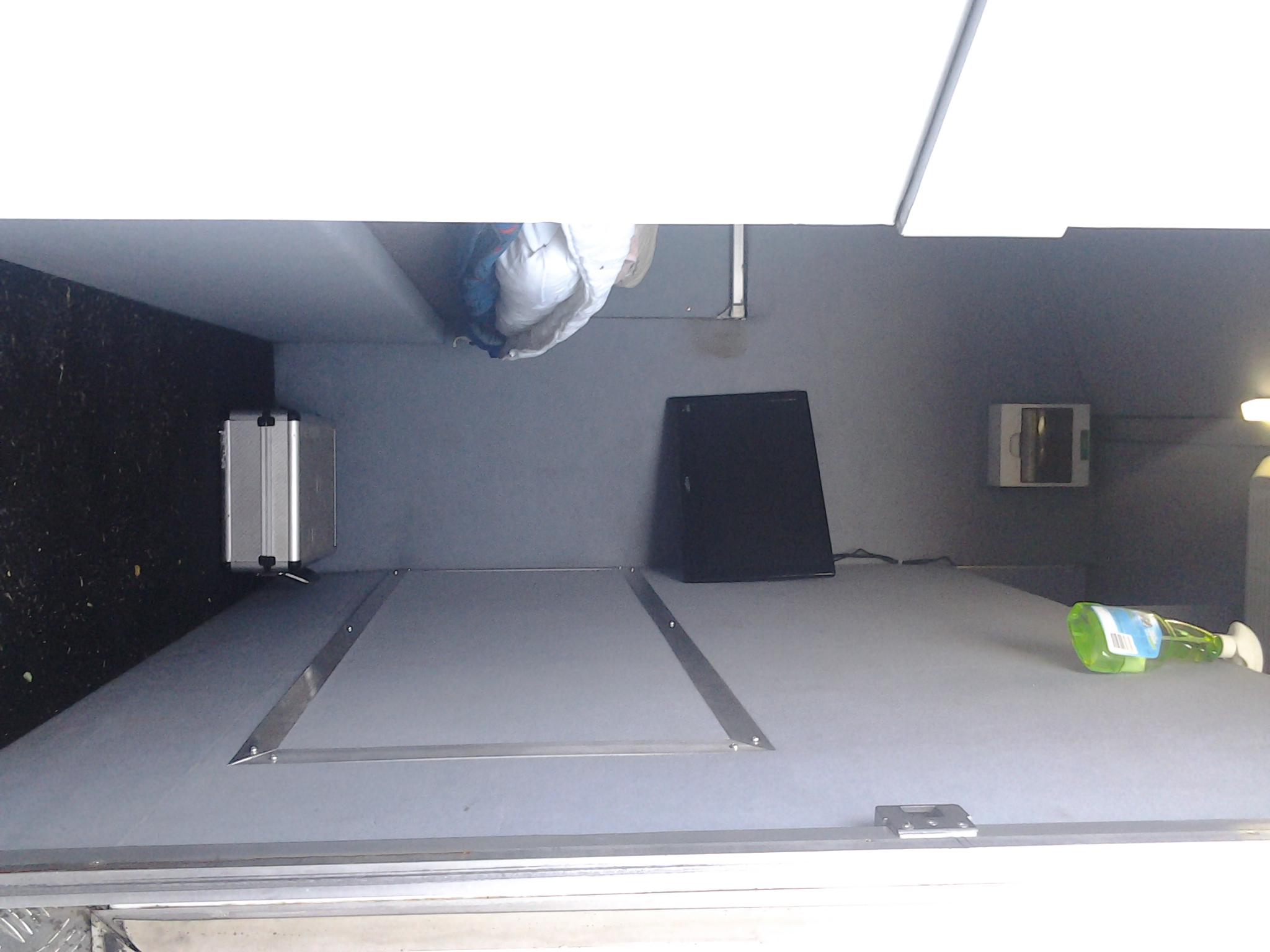

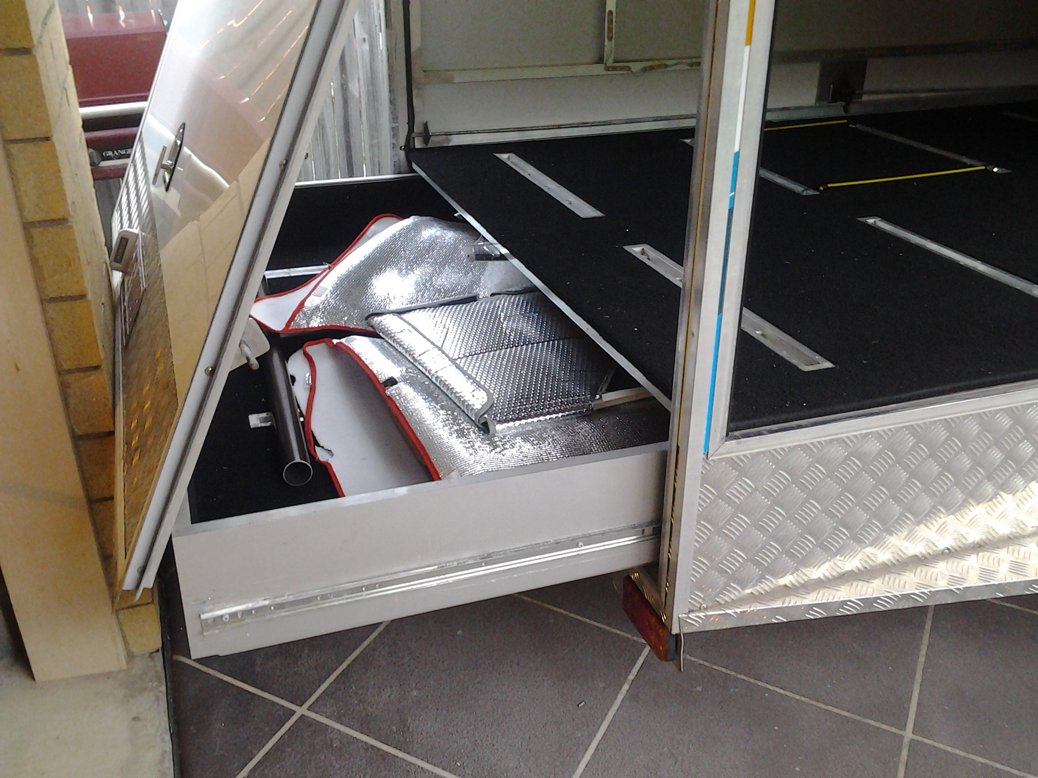

Here is few pics of the inside and draw were the wing go.
Damo

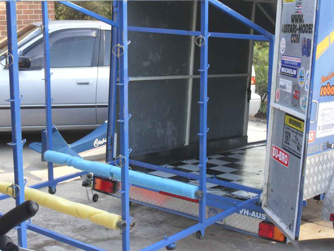

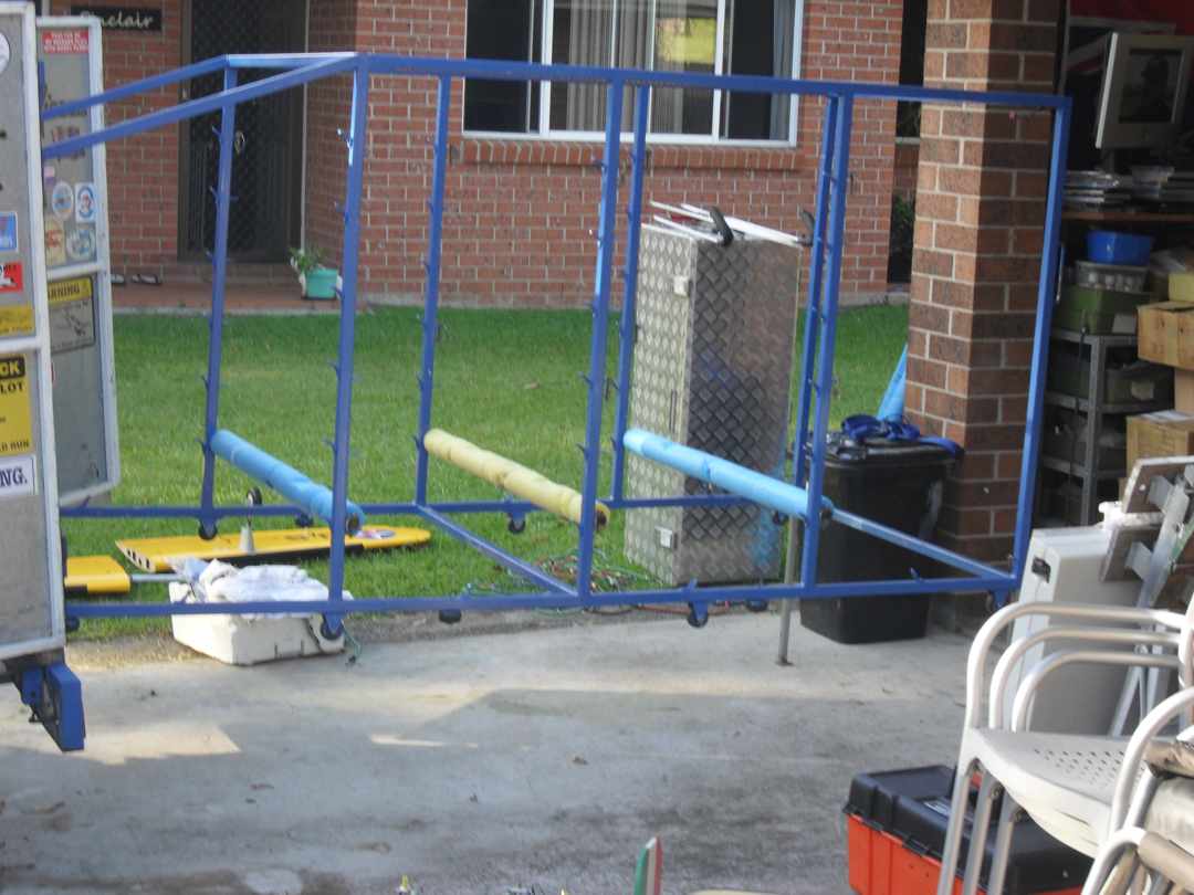

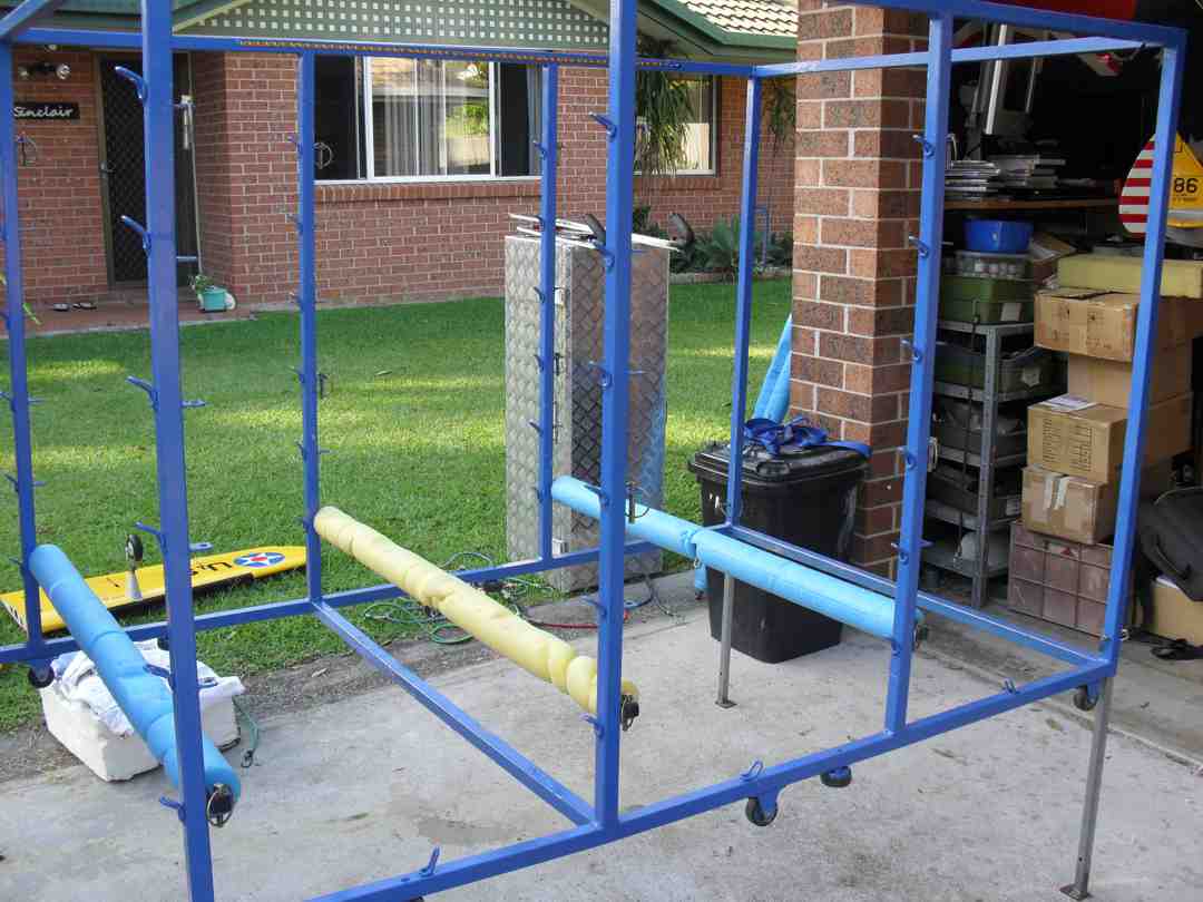

Can't wait till my one is all finished with the bike at the back of it going to the island, and with a plane going flying.
So I take it it has to do both jobs, plane carrier & bike carrier?
Finally got some pics from Big Marty of the rack I mentioned in post #12.
The whole lot slides out in seconds leaving a totally empty trailer & your models still on the rack.

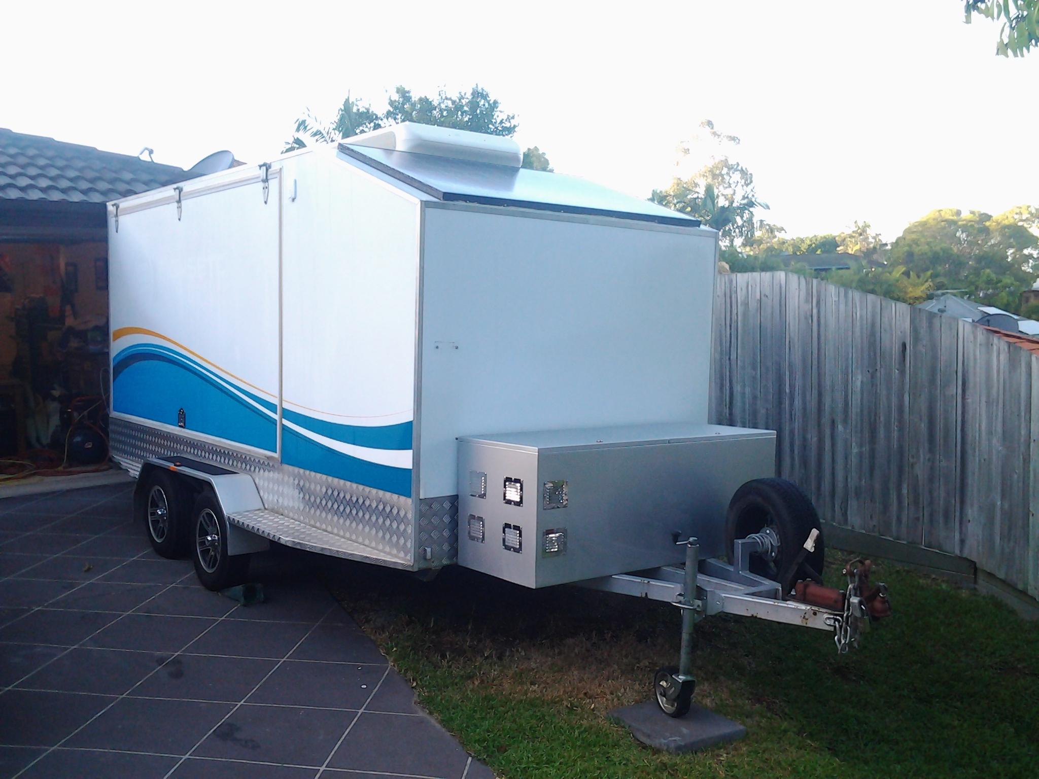

Default Here is my trailer
Hi guys,
This is my second RC model trailer. It is 3.6 meters long x 2.250 meters high x 1.9 meters wide. The door openings are 1.5 meters high and the height under floor is 280mm. Both floors are height adjustable and can slide out sideways. When the doors are open a shaded all round verandah can be had with two triangular canvas pieces added between the side and rear doors. The main frame construction is steel and everything else is aluminium. The power panel is dual 12v DC and 240v AC - powered by either a 125ah battery and 80watt solar system or external AC power - all used for either 12/24/240v charging up to 4x5amp load. The trailer has LED lights through out and a wireless reverse camera which can be viewed from my driver seat. The total weight is 850 kgs and has brakes fitted. Here are some photo's showing models and wings stored for transport. The front drawer is used for model stands, folding table, charger and other boxes. The rear quarter under floor areas are used for fire extinguisher, overnight marque and 40 litres of extra jet fuel. The front storage area is used for field fuel station, field tool box and other field requirements.
Hope you approve.
Cheers,
Jan

Arhh Jan,
You left us hanging with just one pic!

Jan, Is that trailer available commercially? Really like it! Half the battle with the enclosed trailers is access, your "enclosed" trailer opens up very nicely.

DrScoles, although I can't answer the specific question about Jan trailer you can get any trailer you want custom built. The biggest problem is finding the rite person to do it.

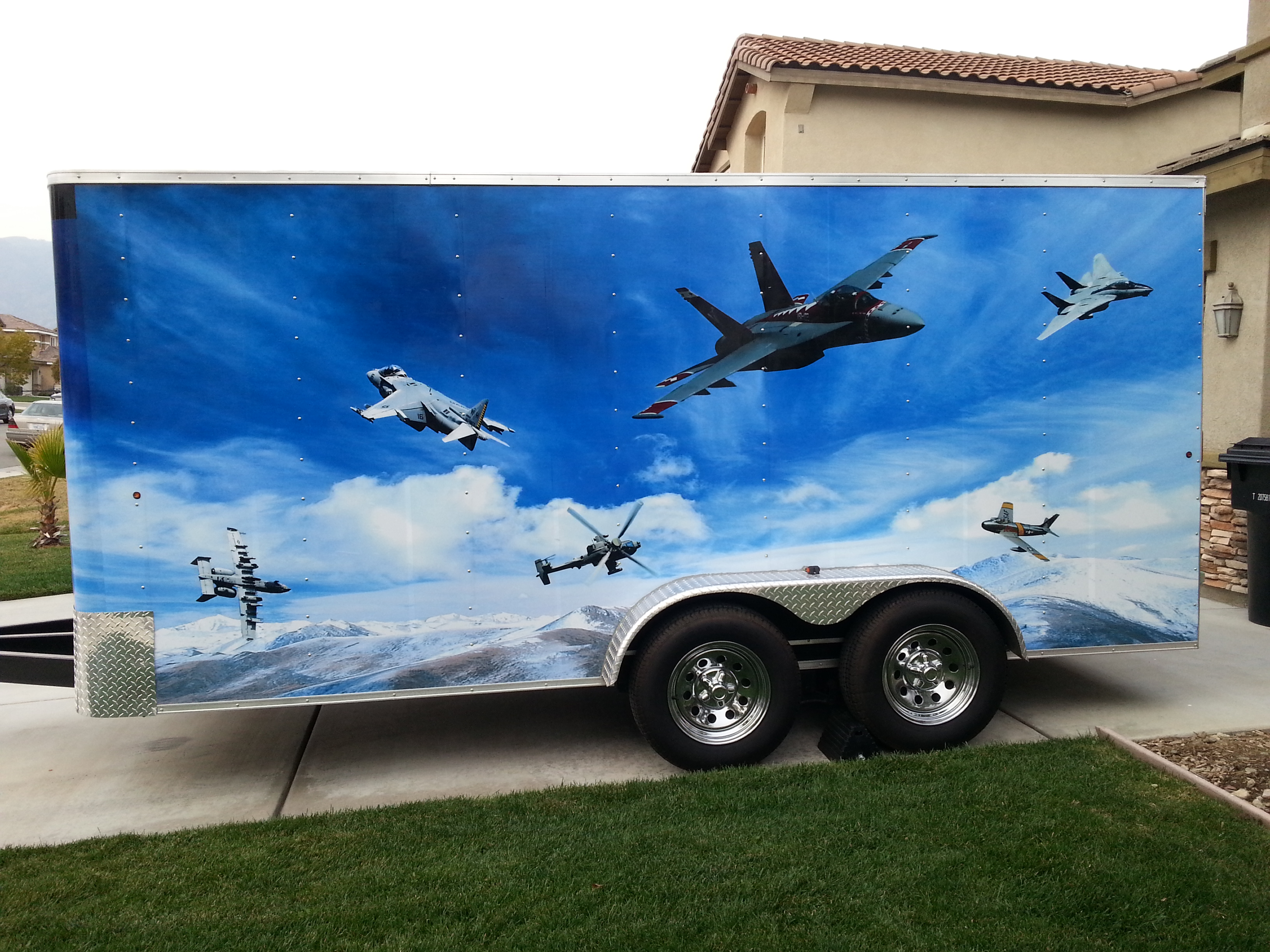

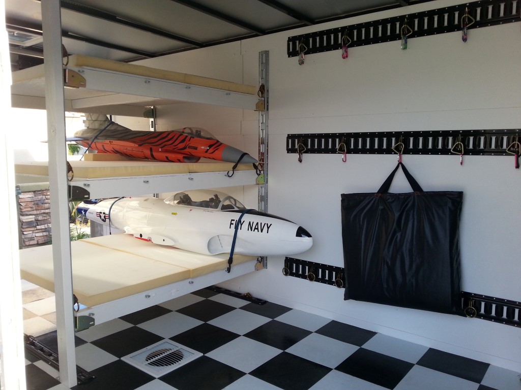

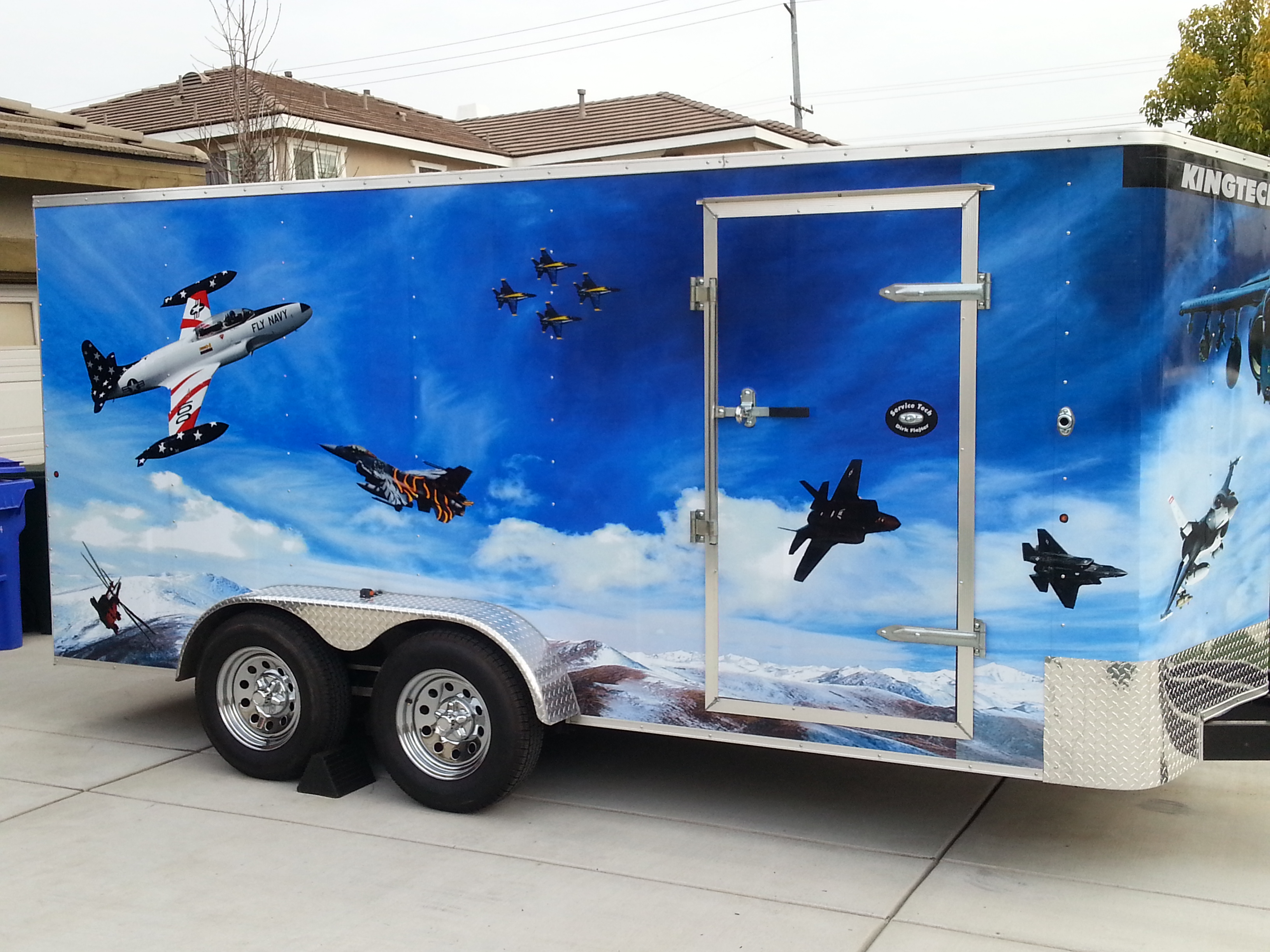

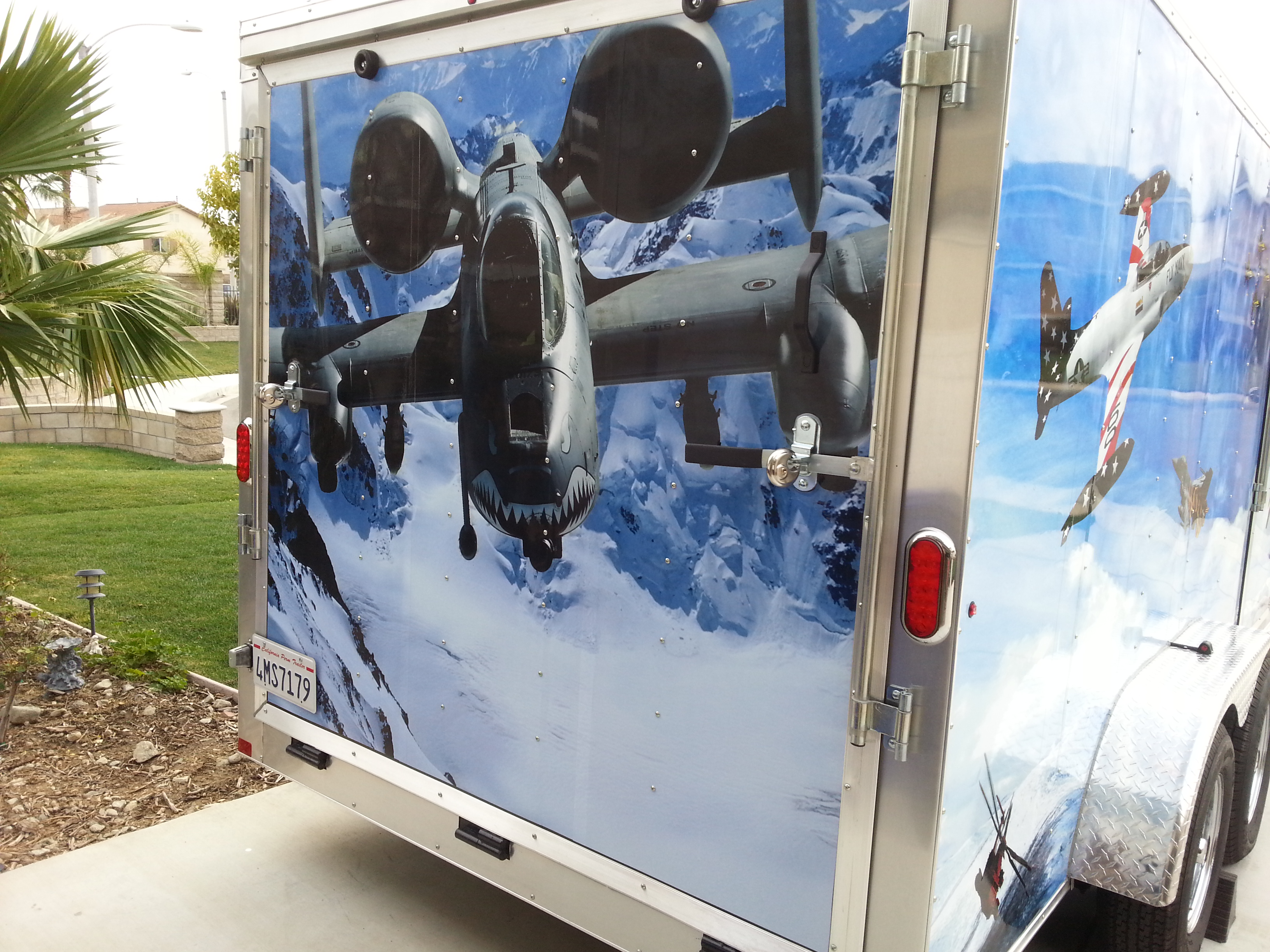

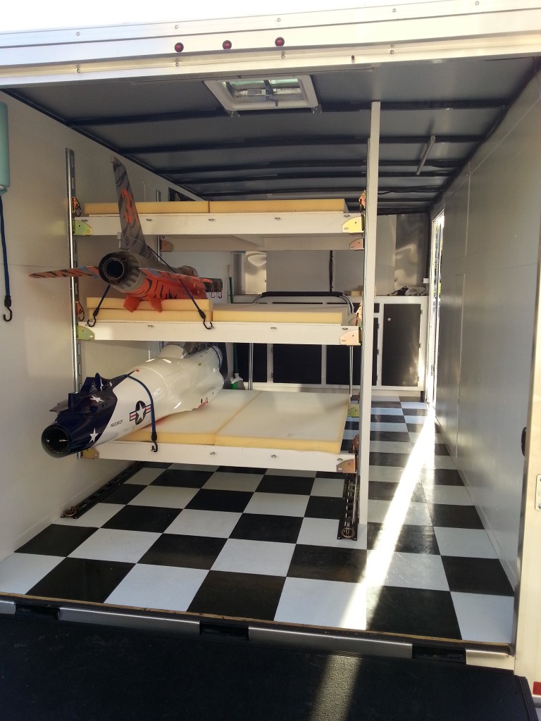

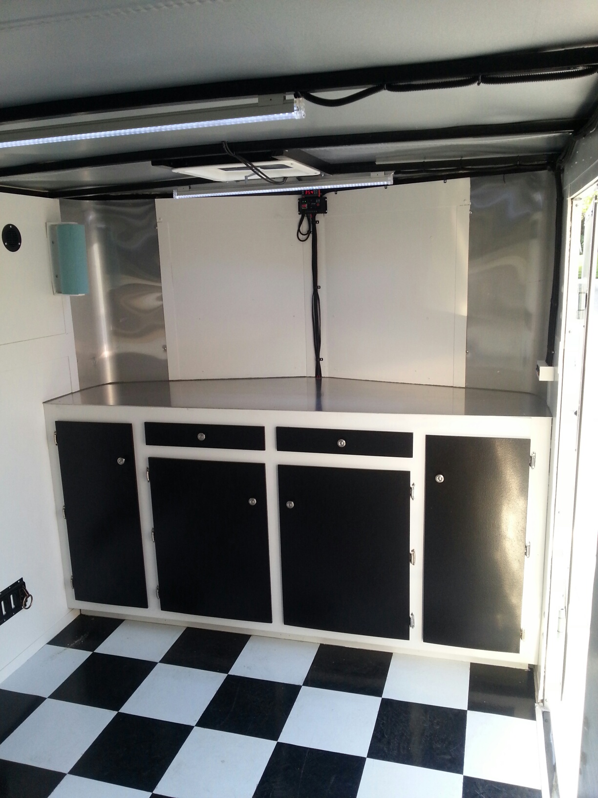

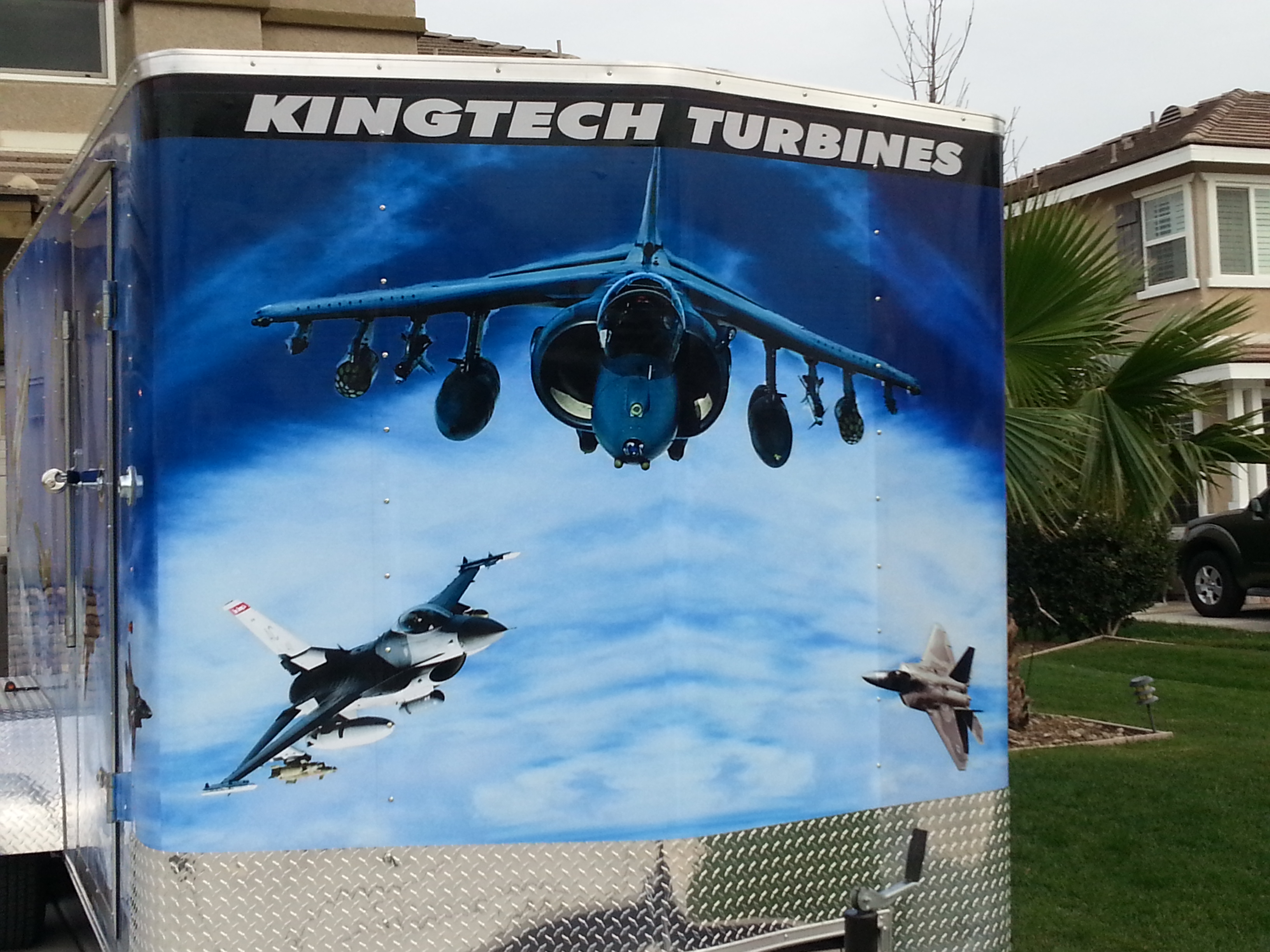

I have a 16' tandem axle that rides pretty smooth. I installed a work bench, 2-14" pop up vents, 2-7" electric fans in the floor to keep the heat from building up, an Interstate deep cycle marine battery, alarm system, and a 100W solar panel. I installed a rack system that you can walk past the 1 side as it is easier to load bigger planes without having to go around the front to grab it while someone holds it from the rear. I used 2" upholstery foam so the planes have a comfortable ride to the field. I installed 4- 30" 12V LED interior lights that take little to no power to run. My panel will keep up with running 2 fans all day, full time alarm system and a 500W power inverter and lights at night. I also gave it a little wrap job!!

Magnificent. Did you do the airbrushing yourself or are they decals.

It's vinyl wrapped like a big bill board. I picked the planes I wanted and a buddy did the rest.
Mate, no I designed it and had it built. As I said, it is my second model trailer and I learned a lot from the first one. Things like; open it up as much as possible, separate wings and fiddly bits from fuselages, don't put all the extra weight in the front, make floors adjustable and (re)movable. I wanted a trailer that would take 4 large models including one large turbine heli (not the one in the photo).
Glad you like it.
Jan

flejter, I like the back door of the trailer the best!! The rest is nice also...
