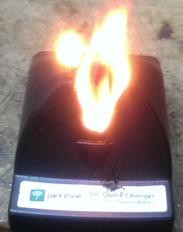

Even small batteries can go up when my back was turned in same room
