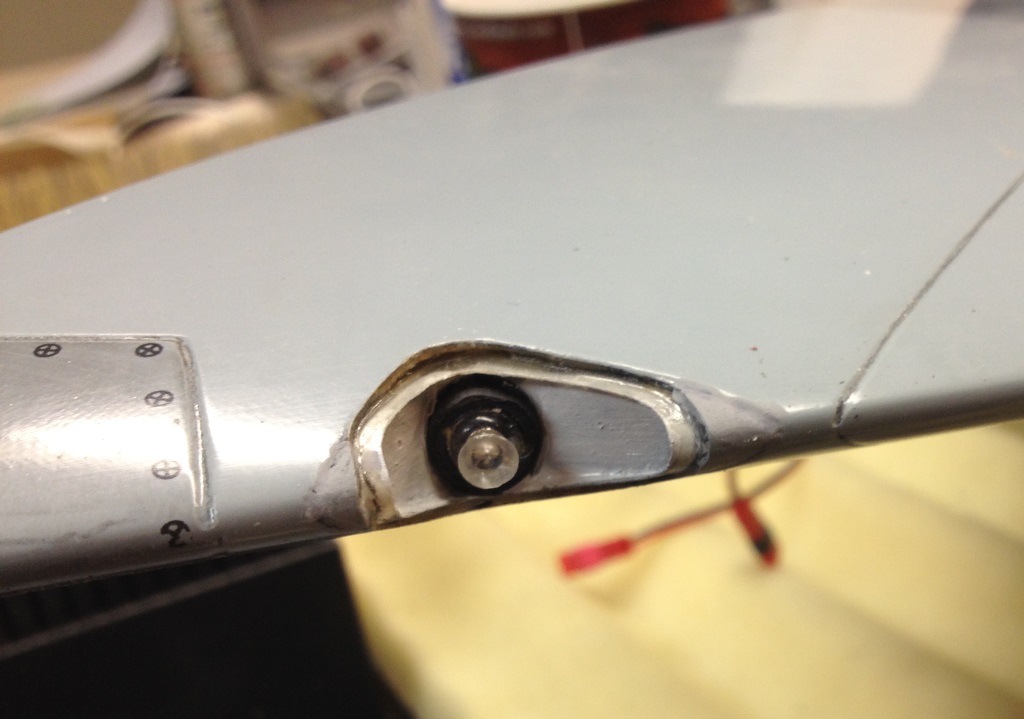

Great lights, but how in the heck do you install/mount these things?
Any tips, suggestions, pics, etc. will be most appreciated.

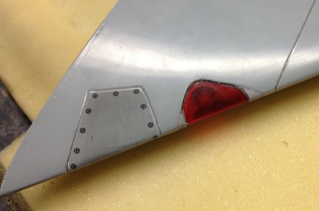

I simply cut a hole in the leading edge, installed pieces of light ply inside the wing, drilled a thru hole, and glued the LED in place. See photos below. Sorry I missed you at TG.
Note: The lights come with a wire lead which is about 36" long. At the mid-point in the wires, there is a piece of heat shrink around a small circuit-card board. If you want to shorten the wires, that is OK, but make sure you still install the board as it has a surface mount resistor installed.
Regards,
Jim

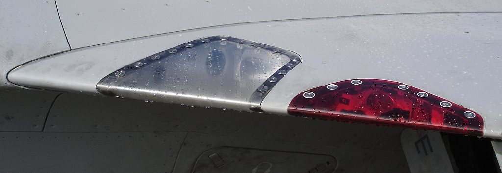

Thanks Jim. Your method seems like the way to do it, just wanted to make sure I wasn't overlooking something.
The wingtips on my Viper already have recesses/clear covers, so that install should be pretty straight forward. However, installing the upper and lower fuselage anti-collision beacons seem a bit more challenging. I bought a couple of the clear sheets of the various shaped beacon covers - http://www.electrodynam.com/store/product260.html - but I'm scratching my head over how to attach these things and not make it look like a child of 8 did the work (which is usually what my builds look like indeed did happen.)
I also got the landing light with the intensifying lens (wow, does that gizmo work!!), but figuring out how to attach this apparatus to the nose strut is also an engineering hurdle to be cleared.
