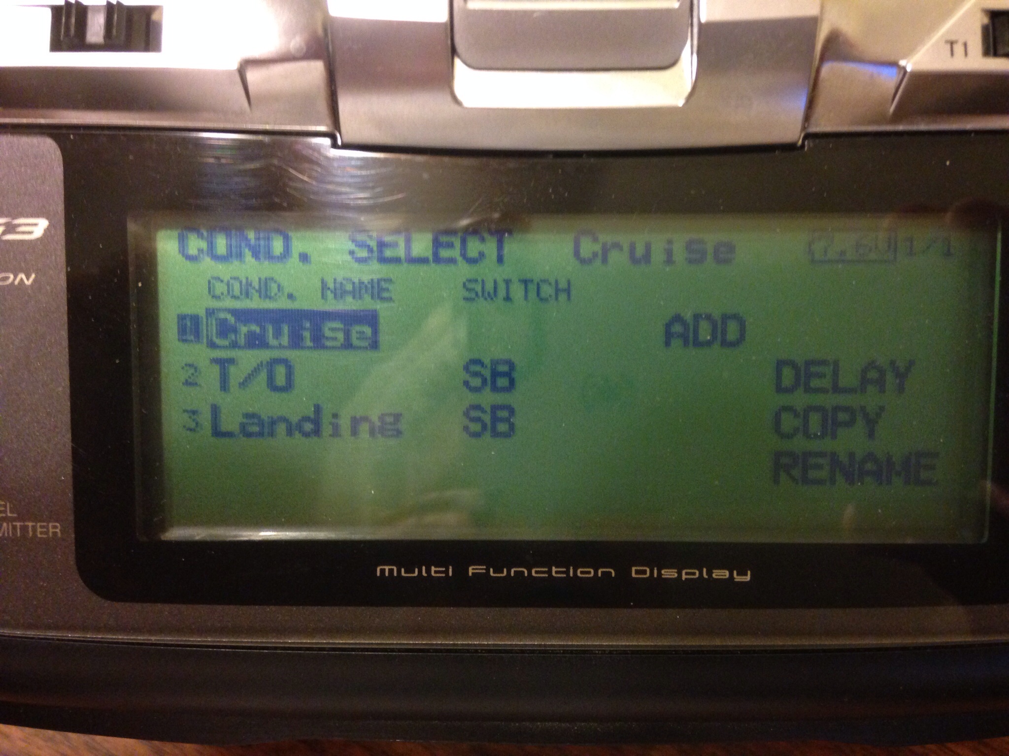

I tried a search but couldnt find an answer. Ive got conditions set up on a jet and I would like to slow down the speed at which a servo moves from one condition to the next.
I have up elevator programmed upon flap deployment. My flaps are slowed down so I would like my pre selected elevator position to slowly move and stop at the same time my flaps do as to not upset the airframe so much during the transition.
I can do it on a p mix by slowing down the in and out speed on the elevator servo, but cant figure out how to do it when switching conditions. BTW this is on a 12FGA. Thanks

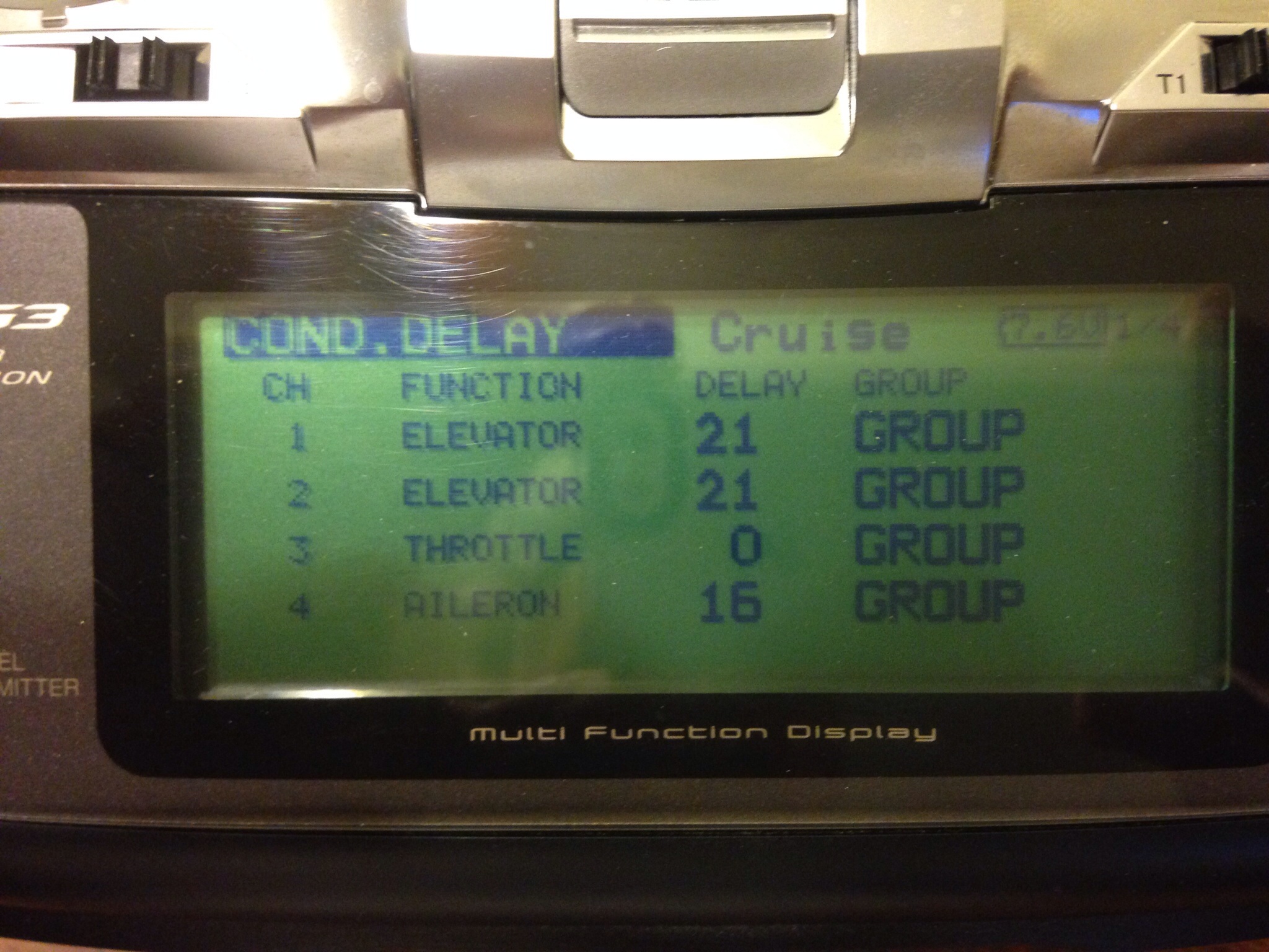

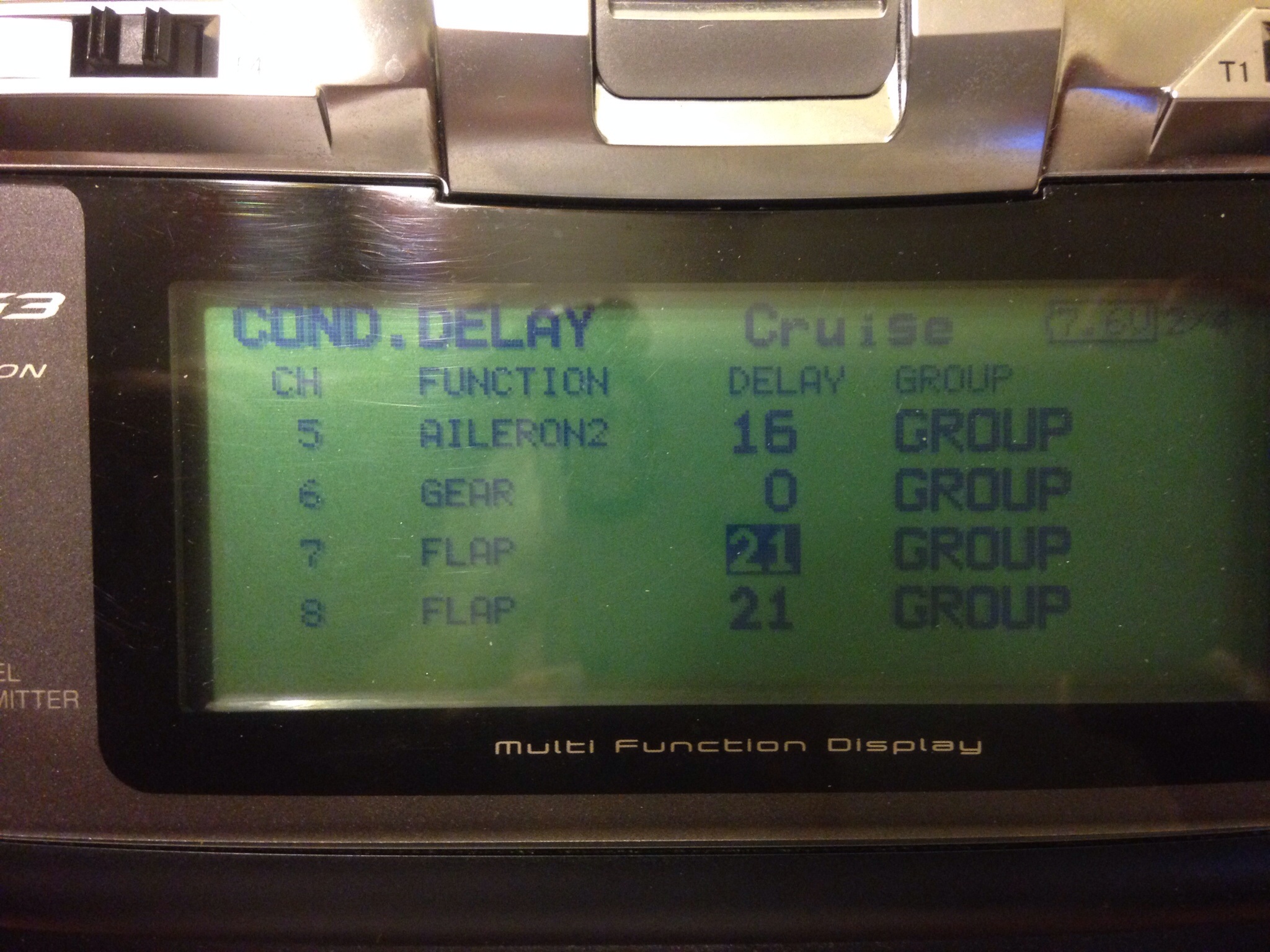

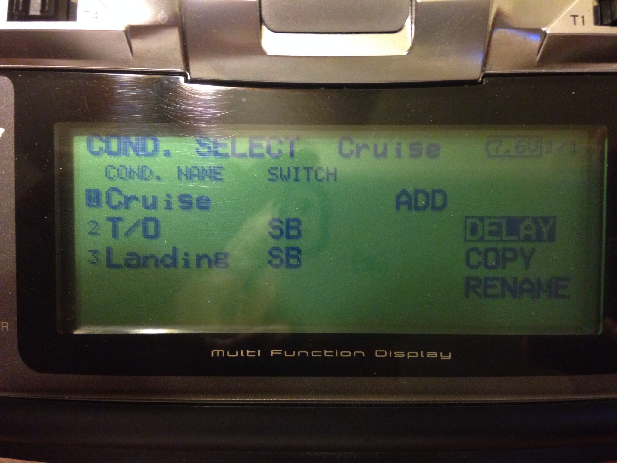

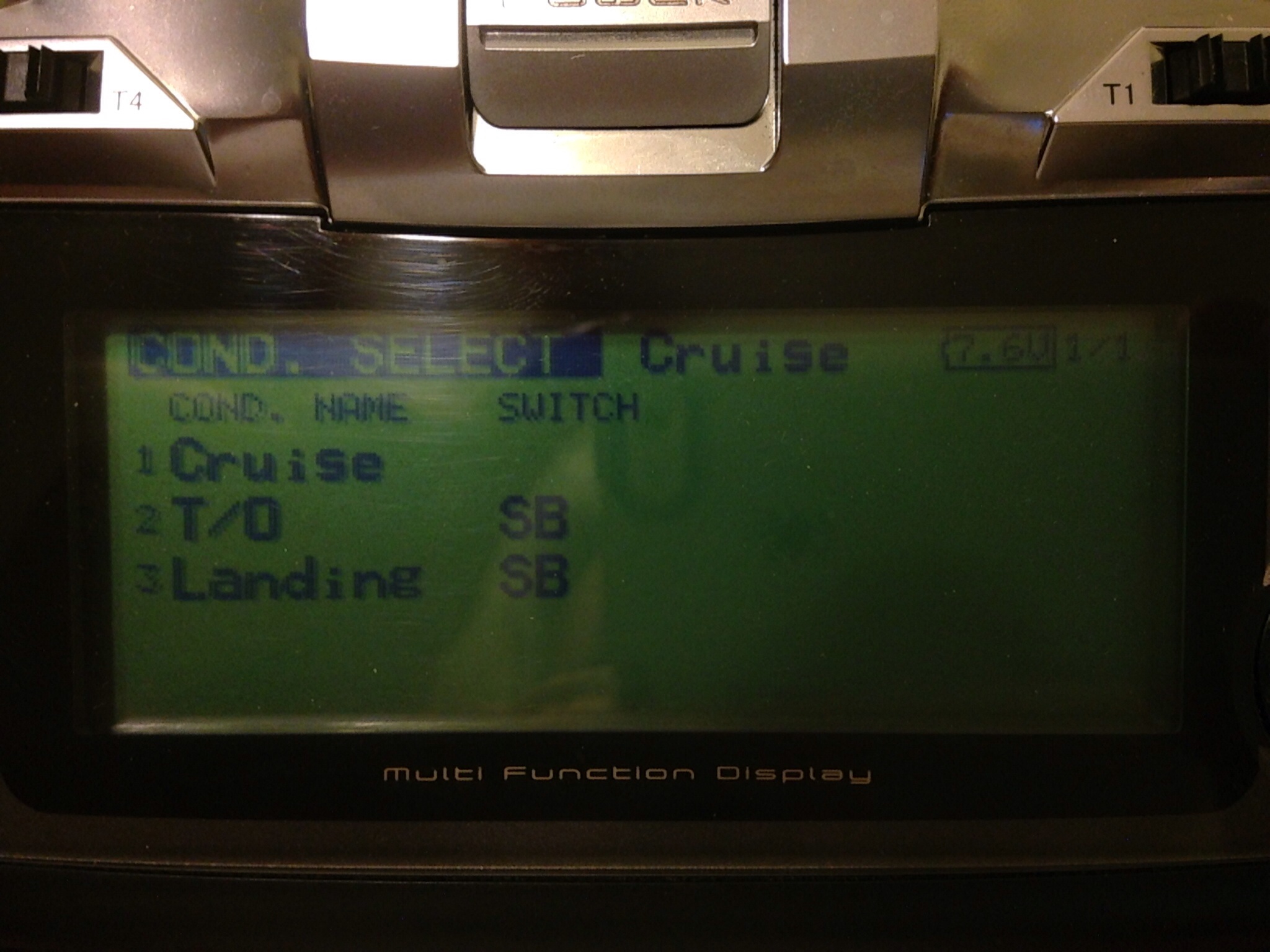

Joe you will find in your condition menu a delay setting, set your elevator and flap delay there. Once you have your first condition setup, there is a copy function that allow you to copy the settings to additional "conditions". The 12FGA has incredible programming capabilities.

Joe it sounds like you set the current delay in the end point menu so be sure to remove the delay there

Bob_B you nailed it man thanks a bunch. My flaps were slowed via the AFR not on the end point page. But the delay in the condition select menu accomplished exactly what I was trying to do. Thanks again, It makes me love this radio
more and more every time I fly with it.

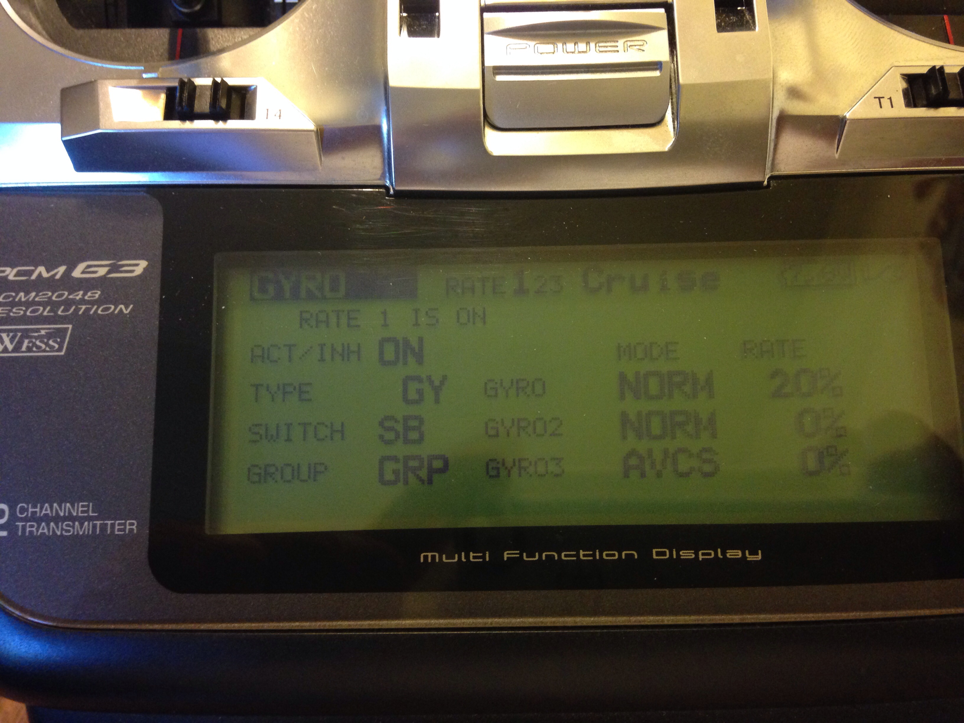

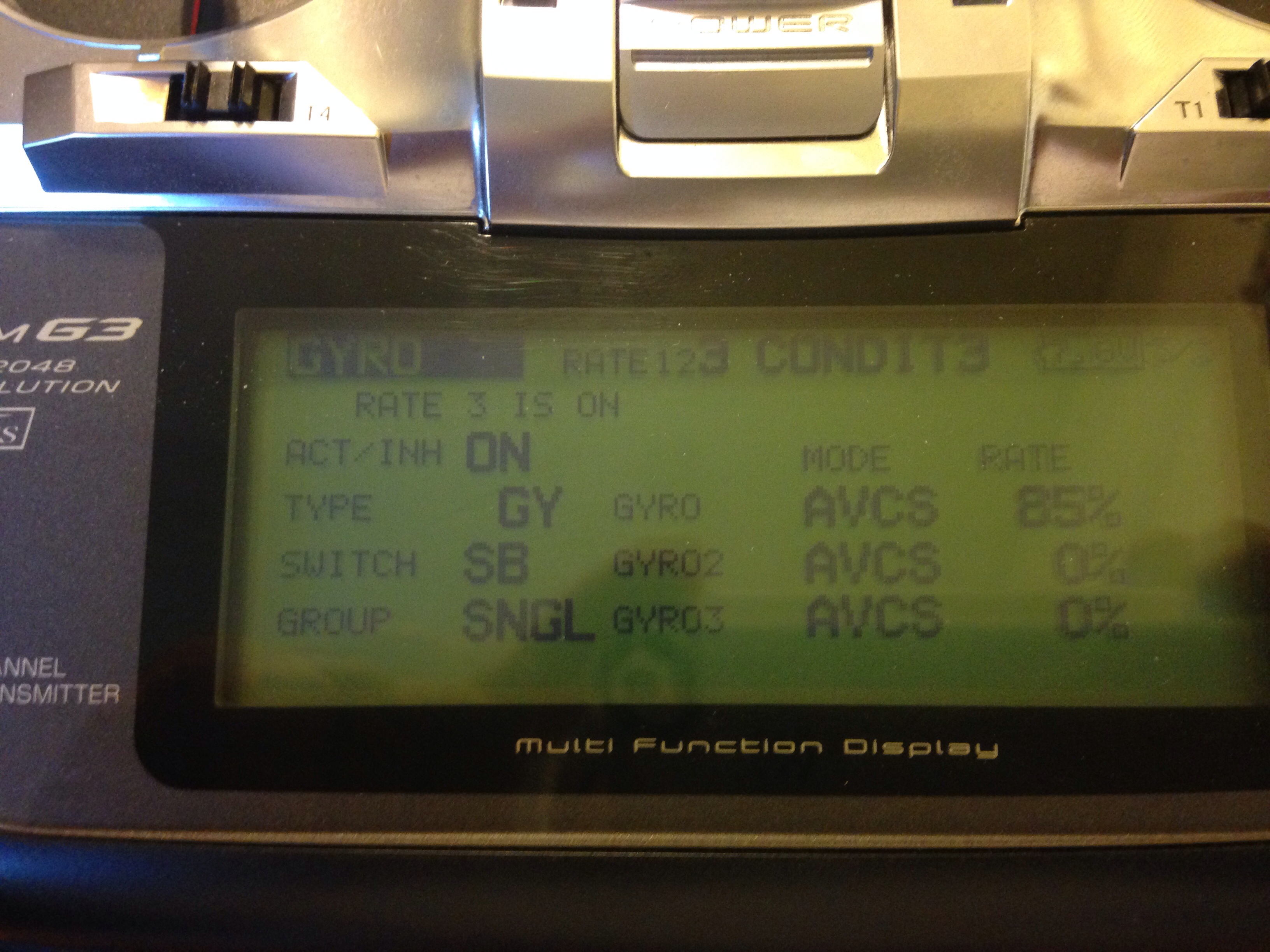

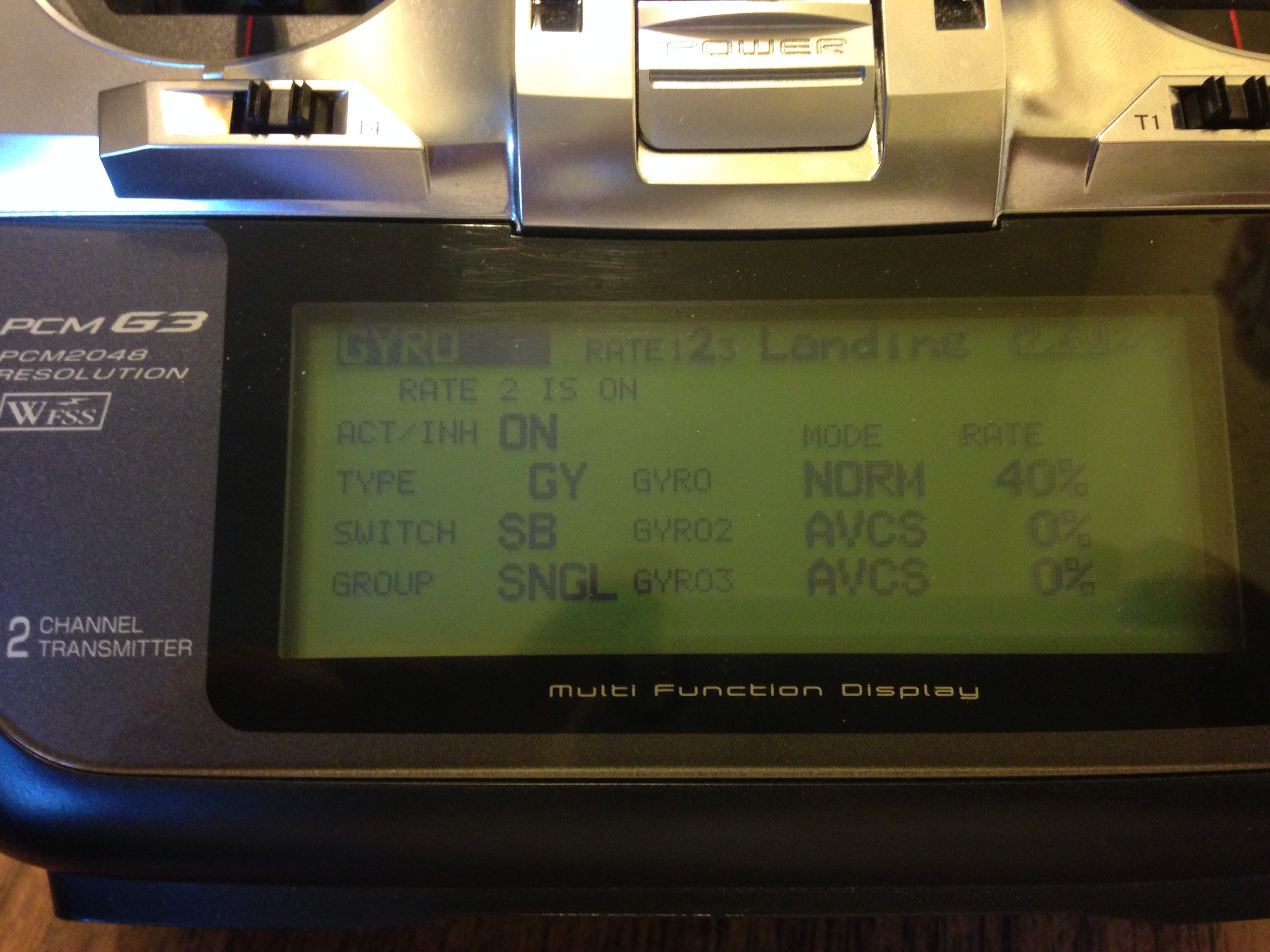

Before you try this i suggest you copy your model to memory and experiment with the copy.
Gyro menu settings for your initial flights. This setup features an off position.
photo 1 shows the settings for the off position
photo 2 shows the settings for low gain
photo 3 shows the settings for high gain
for this setup select a switch OTHER than your condition don't worry it is easy to reassign the switch later

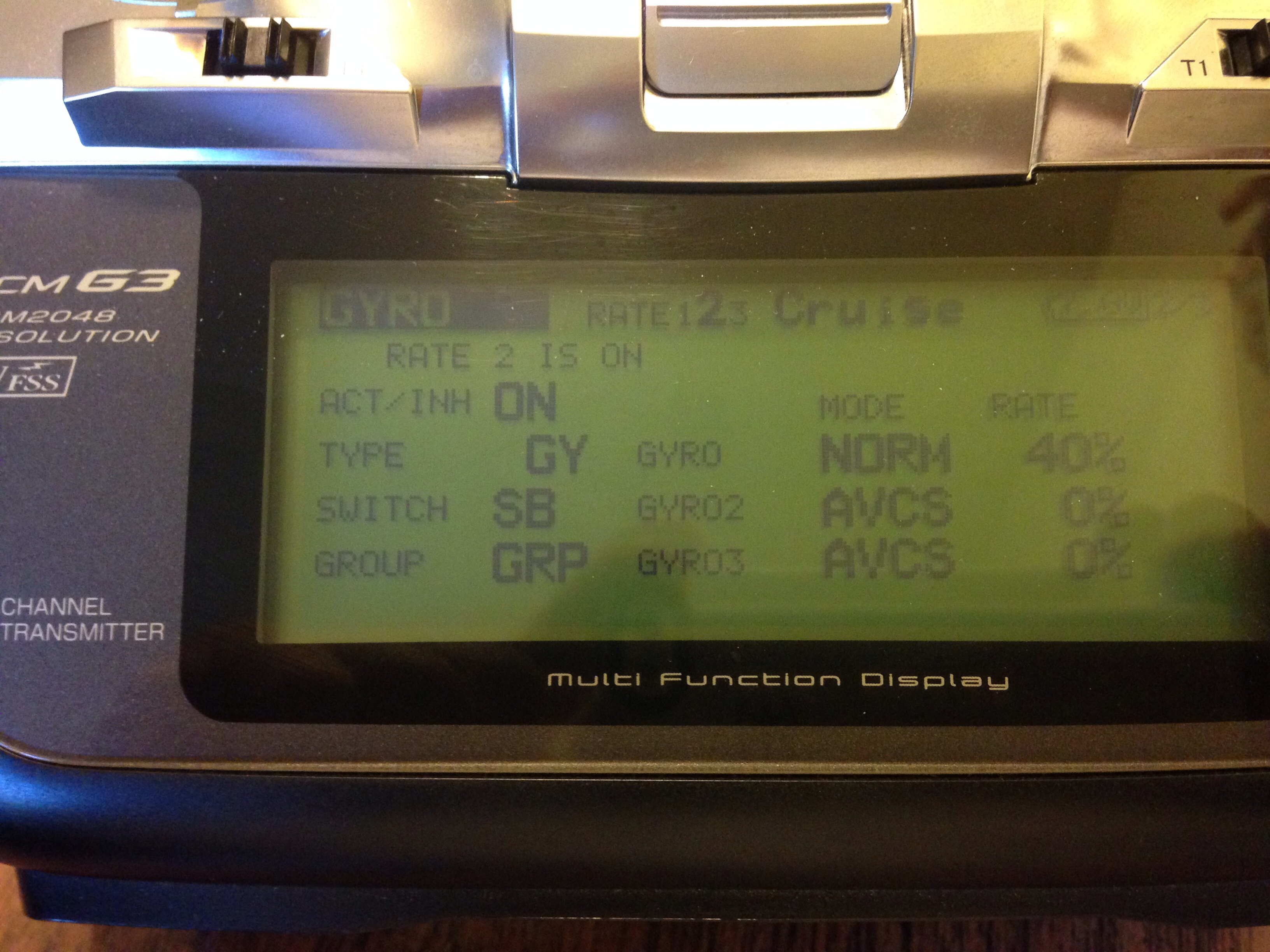

These photos show an advanced setup with three rates on your condition switch and the highest gain changing to bank two. You need to change from group to single
Photo 1 is low gain
photo 2 is mid gain
photo 3 is high gain switched to bank two this was by changing the type to AVCS
