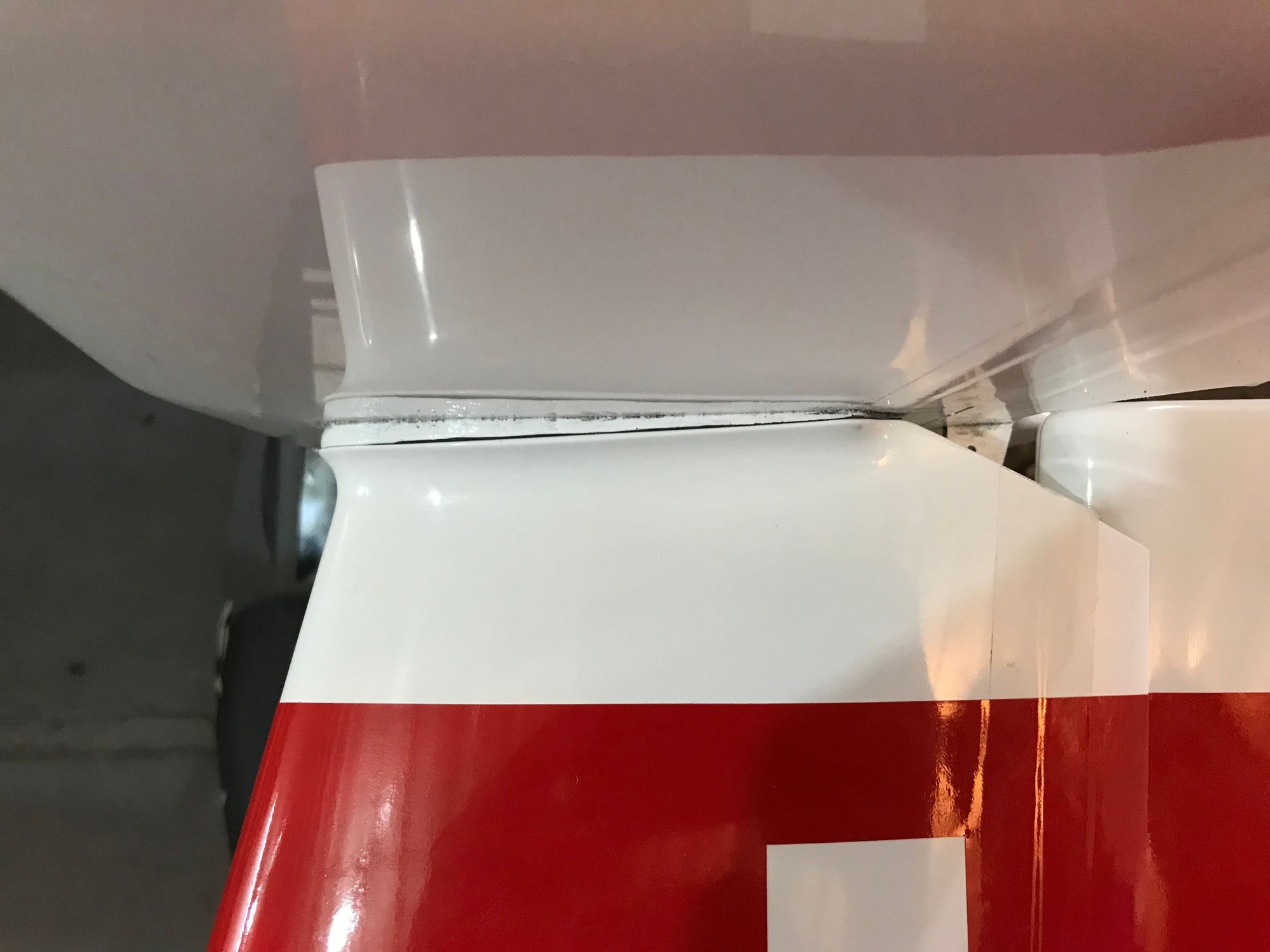

Not the best pictures and maybe not the best sanding, but this is how in looks. In the closeup pictures the sanding doesn't look great but when you see the glider, it looks OK.
Old 05-14-2018, 12:46 AM
  #109
wing13z
Join Date: Feb 2006
Location: Daytona Beach, FL
Posts: 100
Originally Posted by Gonzalo38 View Post
Wing13z:
did sanded my stab last week because it doesn’t have the red dot as they mentioned in the manual, and later on I did email CARF to get more info.
You can see how it looks now, and take a look on the CARF email. I believe that manual is screwed up!!

Thanks for the info. My plane was an early model (been seating on a warehouse for a long time) so I think mine needed the sanding.
Too bad CARF didn't send a new replacement part and asked owners to sand, leaving a not very nice looking part.

My DG-800 purchased almost two years ago and it didn’t had a red dot on it which make it not update it one as they mentioned in the manual!! and that email message I got from CARF it just confusing!!
The question is why CARF did not updated their manual since then!!
