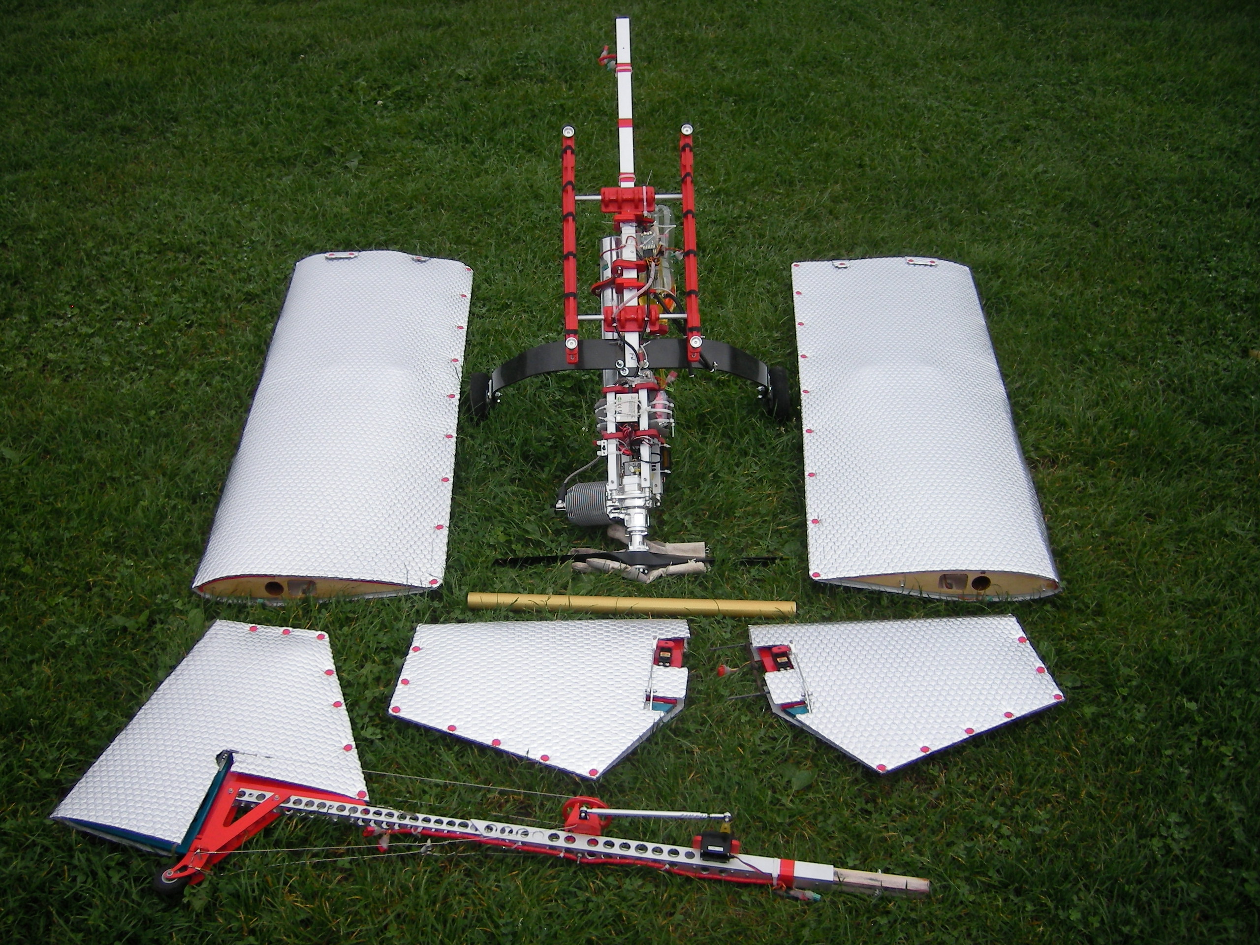

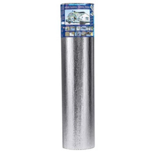

Menards the have 3 sizes ,just made some covers for my blanik jet glider.

Look for the laminated flor underlying material the have blue aluminum foil with blue rubber foam.

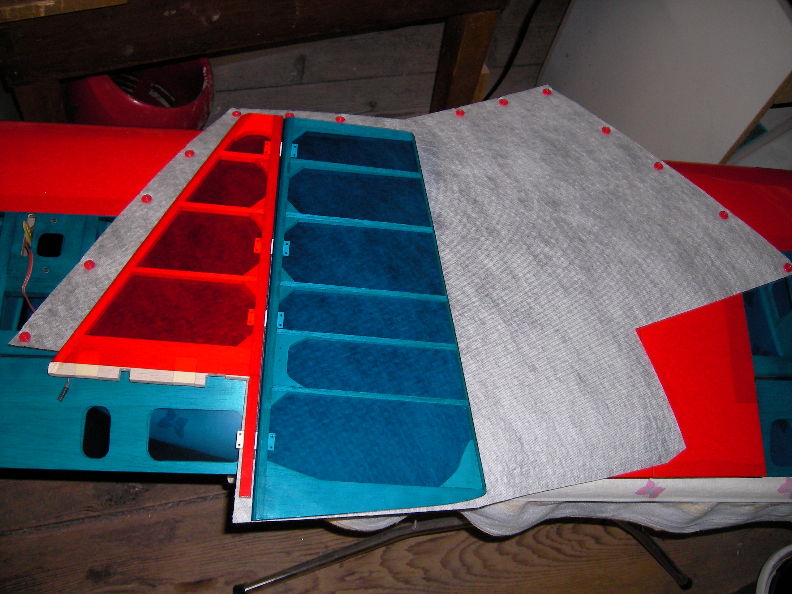

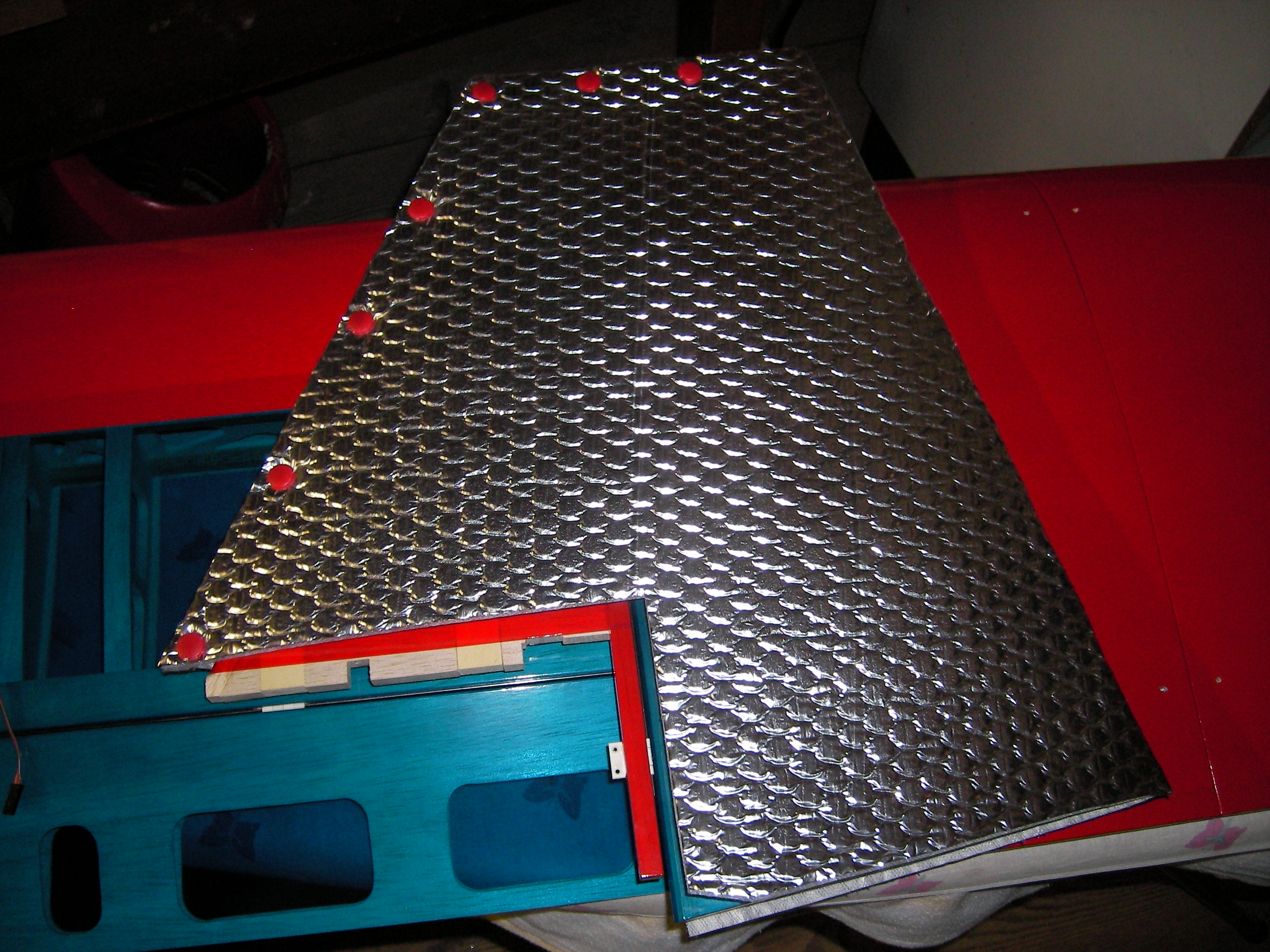

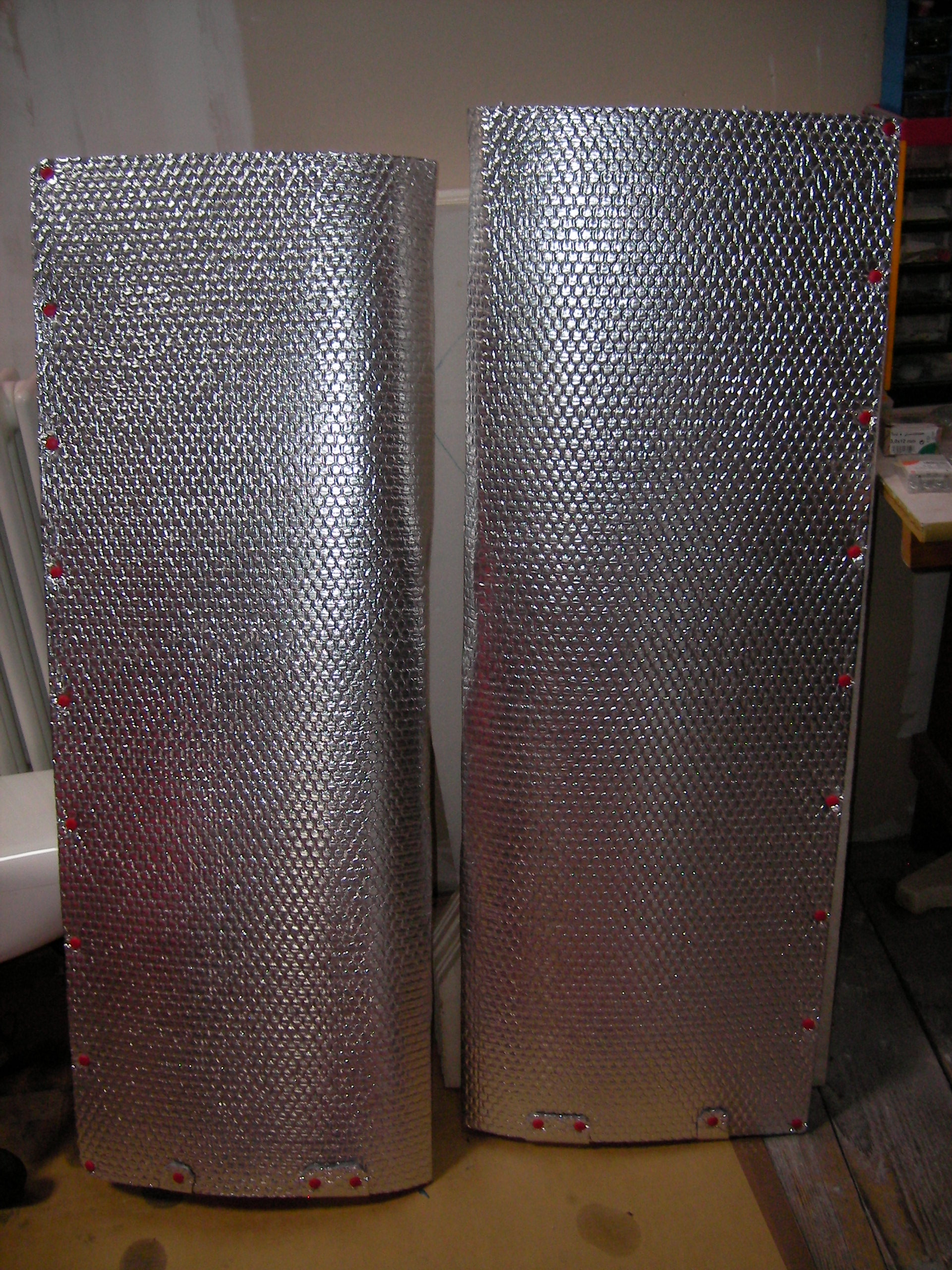

Hi Mark,
I can only give you my german source for the material I prefer. Not sure, if this is what you are looking for.........
The distributor is EMC-Vega, and they ship their products also outside from Europe. Their homepage can also be switched to english.
example pics.....
The material has no bubbles inside, but a soft foam also made of plastic. Some pilots told me, they found kinda bubble design on their planes, when they used the other type with bubbles inside and out.
If you are afraid of getting little scratches on your plane, you can order those plastic pressure buttons from "Snaply Nähkram".
No need to slide the bags on, you can open and close them ..... also interesting for cleaning and drying

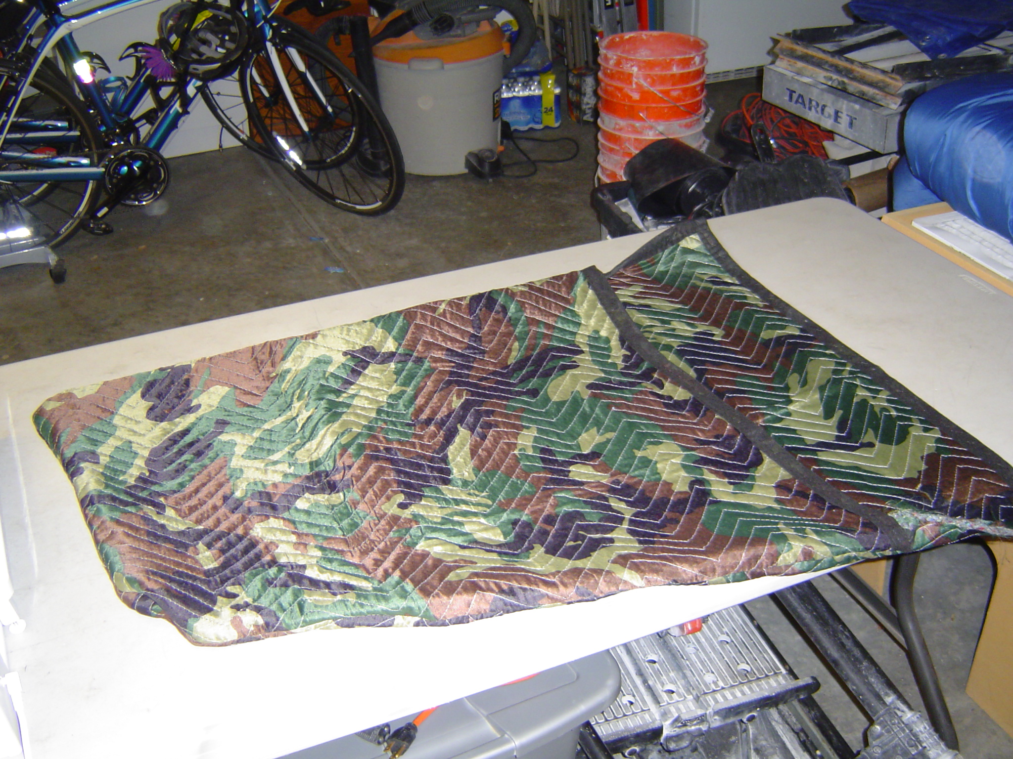

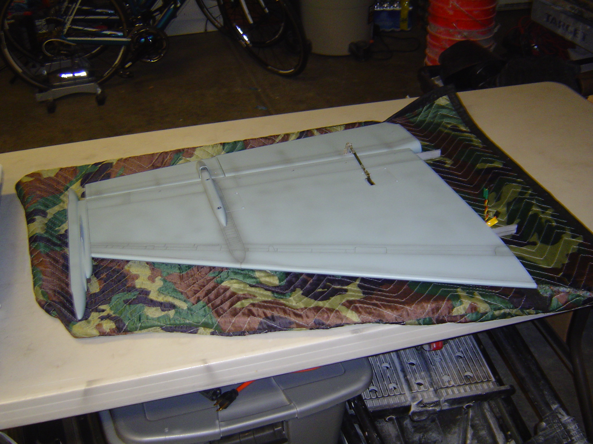

I went by harbor freight the other day and picked up a couple moving blankets, the are $8.99 a blanket.
Came home and cut it to fit my yellow twin f-18 wing, with one side larger to make a flap. Pulled out my wifes sewing machine and made a pass all the way around the edge....pulled it inside out to hide the ugly seam, slapped out velro and bam wing bags made in about 20 minutes... not bad for $8.99
one blanket made the two wing bags

Ron 101,
Been doing the same thing for years with UHaul moving blankets. Hard to beat the price and I personally think they provide better protection than the foil bags.
I have an old Sailrite sewing machine that will sew through about anything and sometimes add some 1 inch binding to make things look more finished.
Really like your Camo bags though
