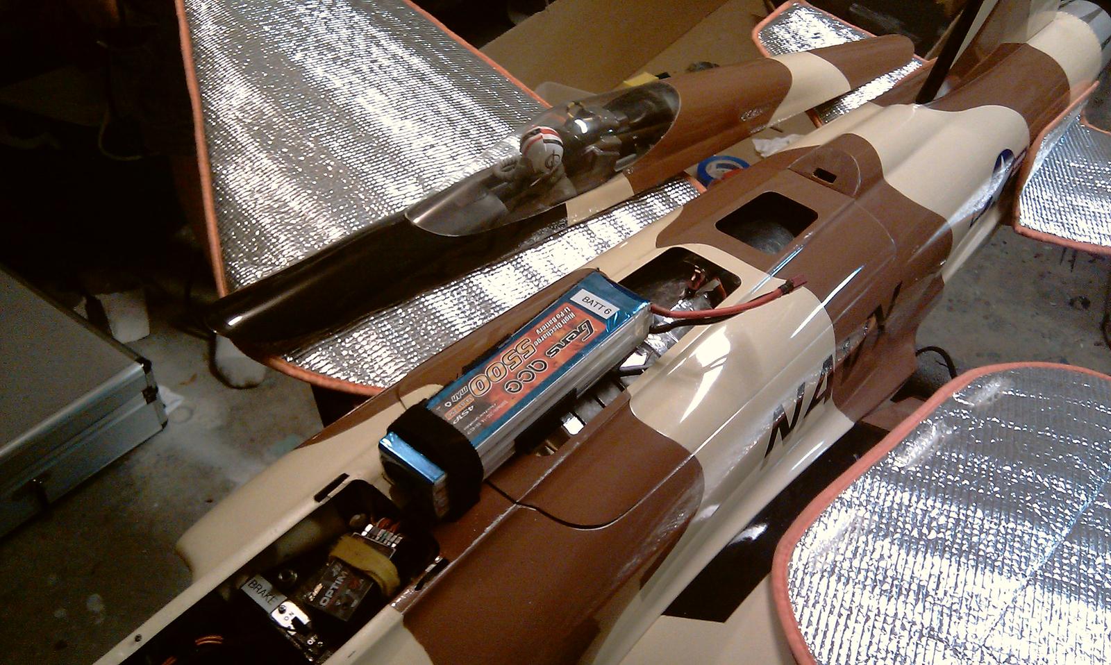

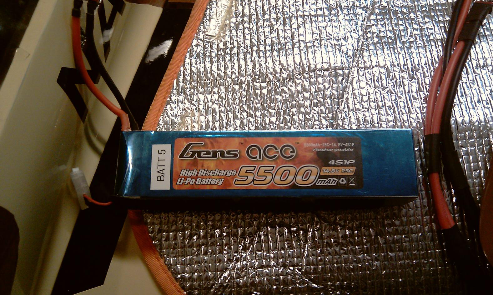

Try going with 3 4cell packs. That is what I used on my electra so I could charge them all at once. Had one in each saddle location then one on top of the inlet.They where gensace 4 cell 5200mah packs if I remember right.

Found some pics of my electra before it died rip with the battery install. Not sure if these batteries are still sold I have not done EDF in a while. But I would parallel charge the 3 4 cell packs for faster charging. These batteries lasted allot longer then my old 65C thunderpuffs.
