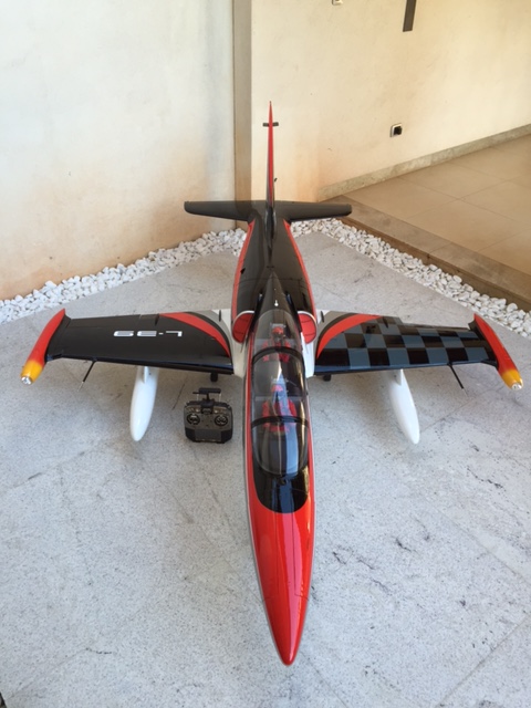

Joined: Jan 2008
Posts: 26
From: Campo Grande, BRAZIL
Originally Posted by madmodelman
Hi Mark, Ian's was the first in the UK, mine was the second although it did fly first!
Overpowered with a 180 imo though.
Hi,
the mine is almost ready, what throws are you using?
ID:	2165041   Click image for larger version

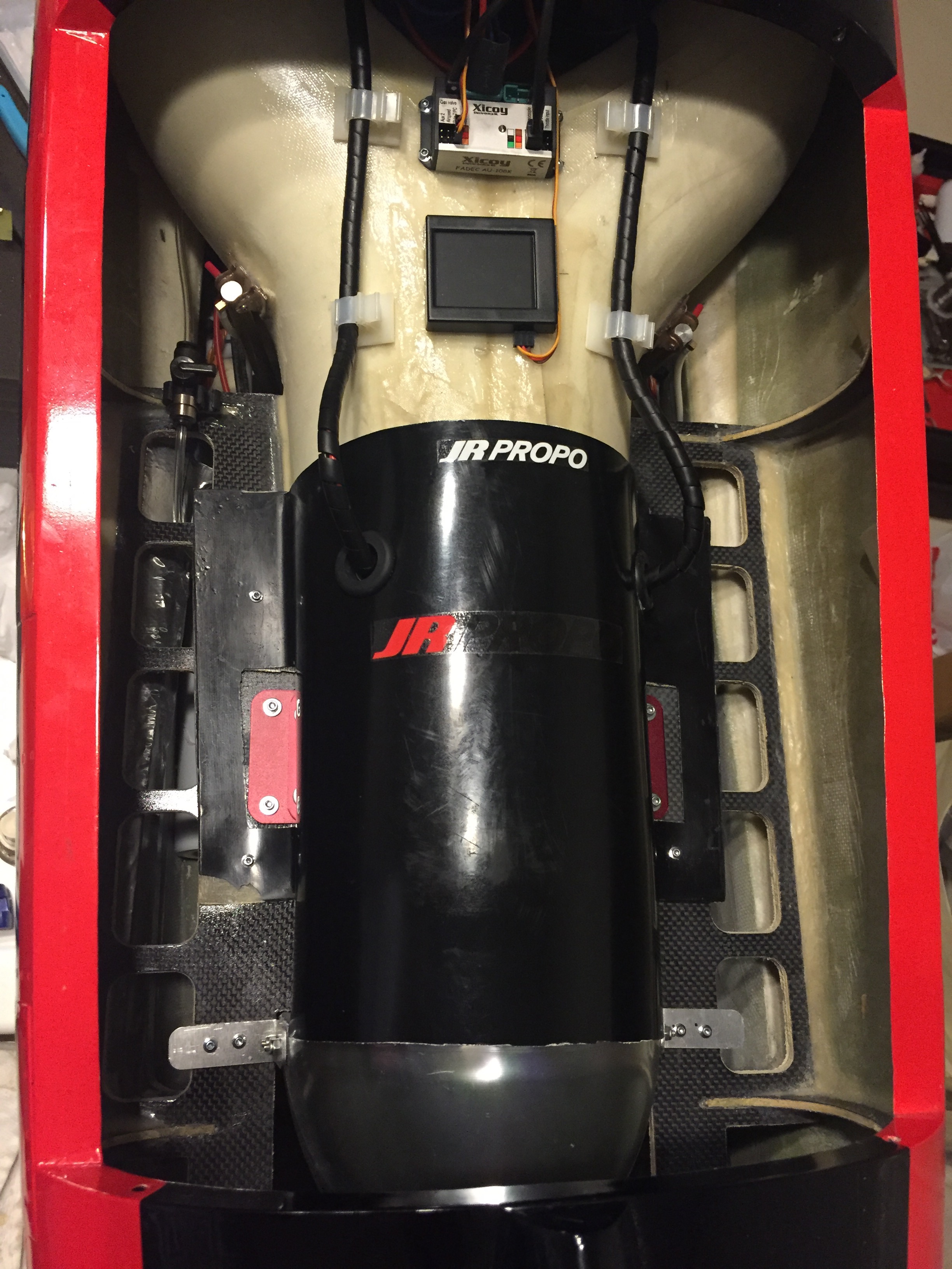

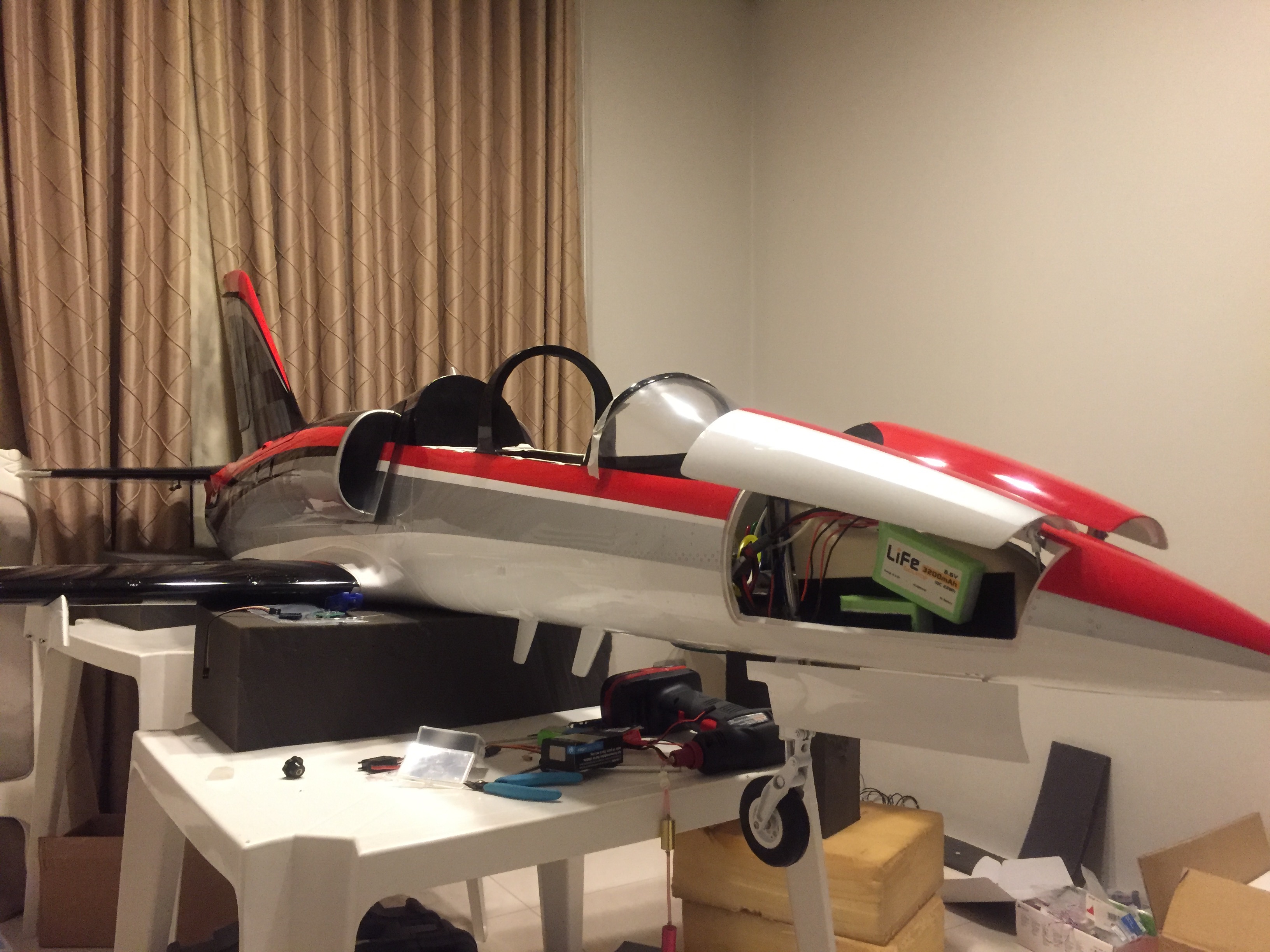

Old 06-15-2016 | 12:17 PM
  #39
Joined: Jan 2008
Posts: 26
Ready to fly, 19.53kg dry + 6L querosene, kingtech K210G turbine, JR28X guidance.
CG 160mm

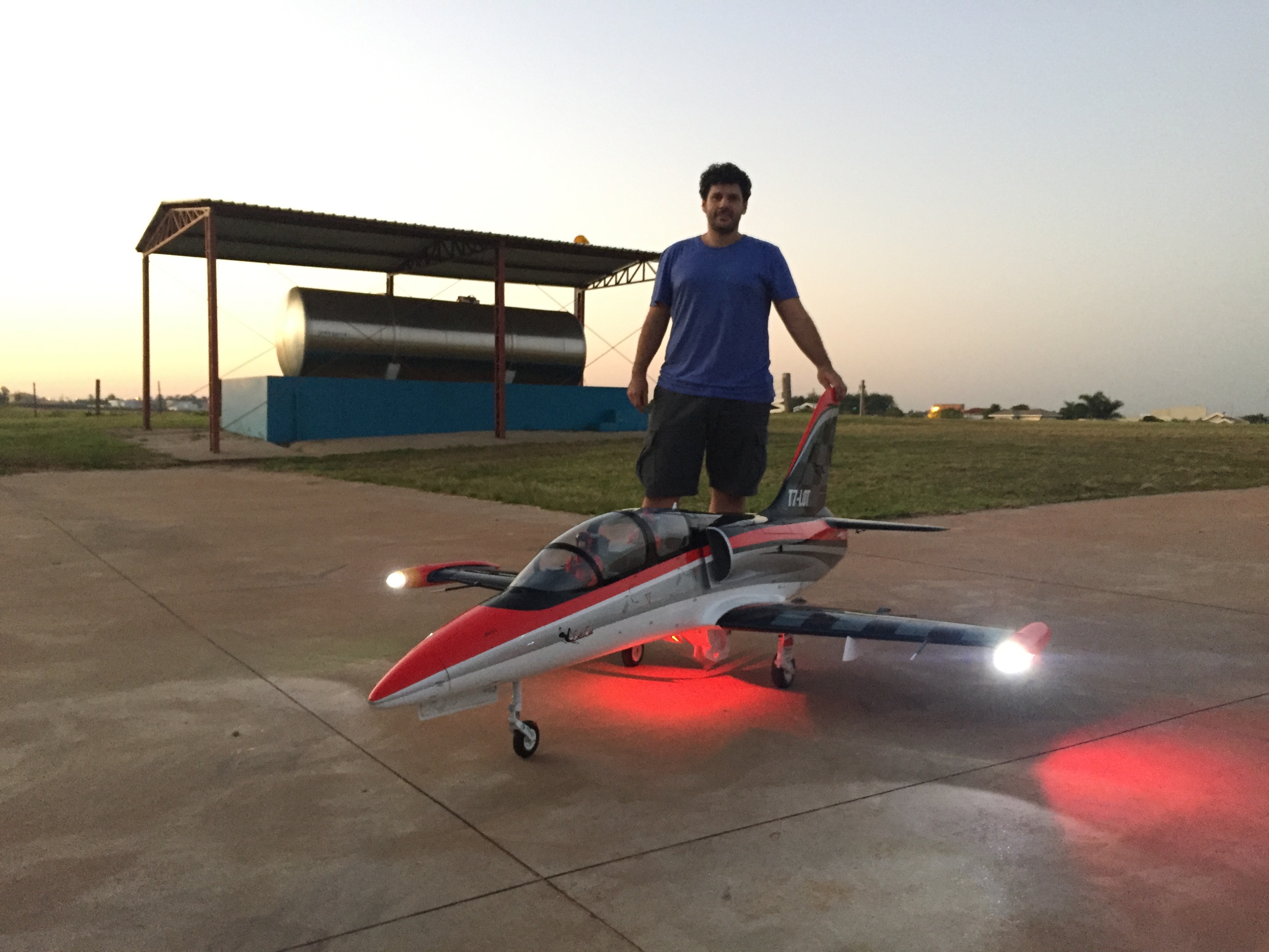

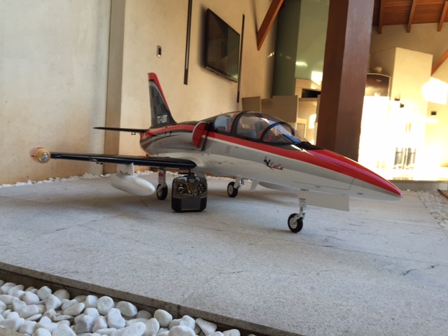

Old 06-21-2016 | 06:35 AM
  #41
Joined: Jan 2008
Posts: 26
Hi all,
I maidened on last saturday, It was good, 3 flights to put the CG on the right place. The best one was 170mm.
K210G is to much power, half power in all flight except on verticals, after 8 min. left almost 1/4 of tank.
ID:	2168871   Click image for larger version

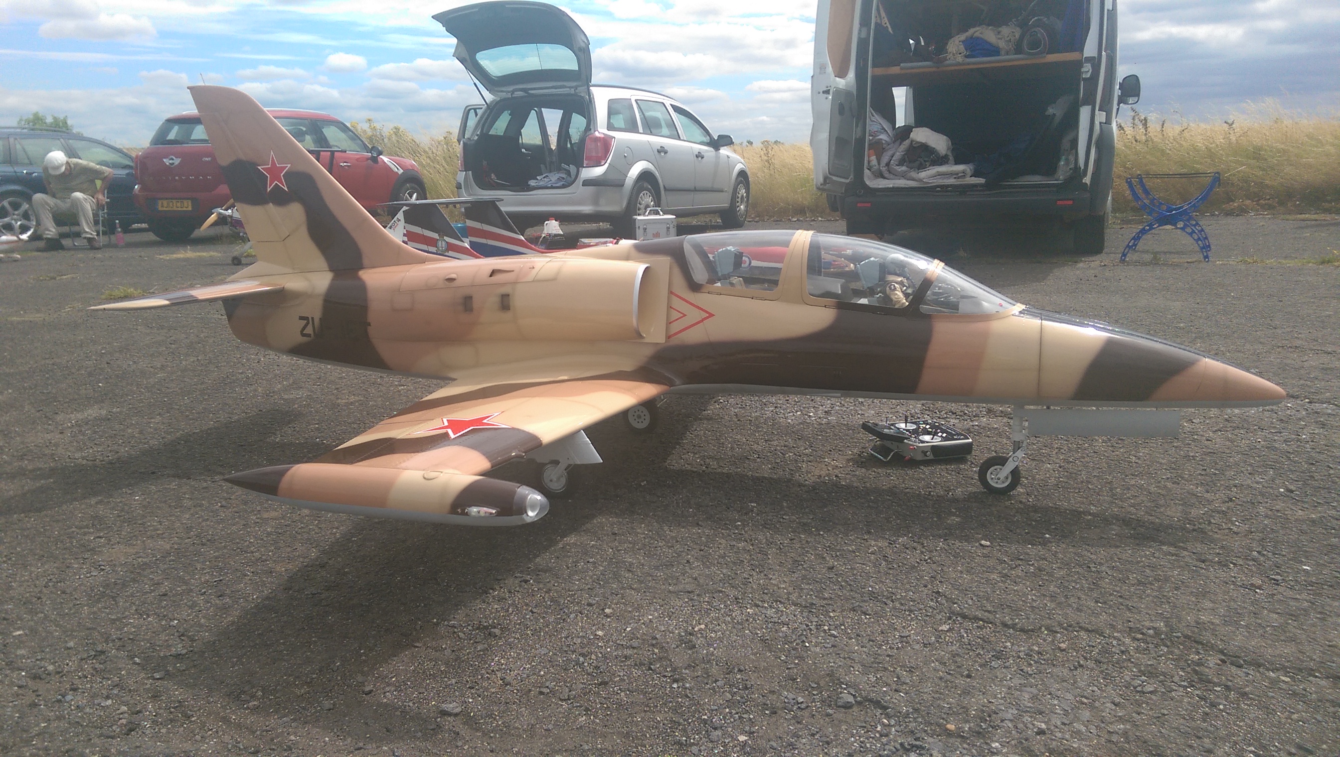

Managed a test flight today with a new set of wings and new factory springs.
I have to report that these new springs are a 100% improvement, thank you Catherine at FB Jets, good job done!
As usual she flew awesome! (The Albatros, not Catherine)
Gary.
