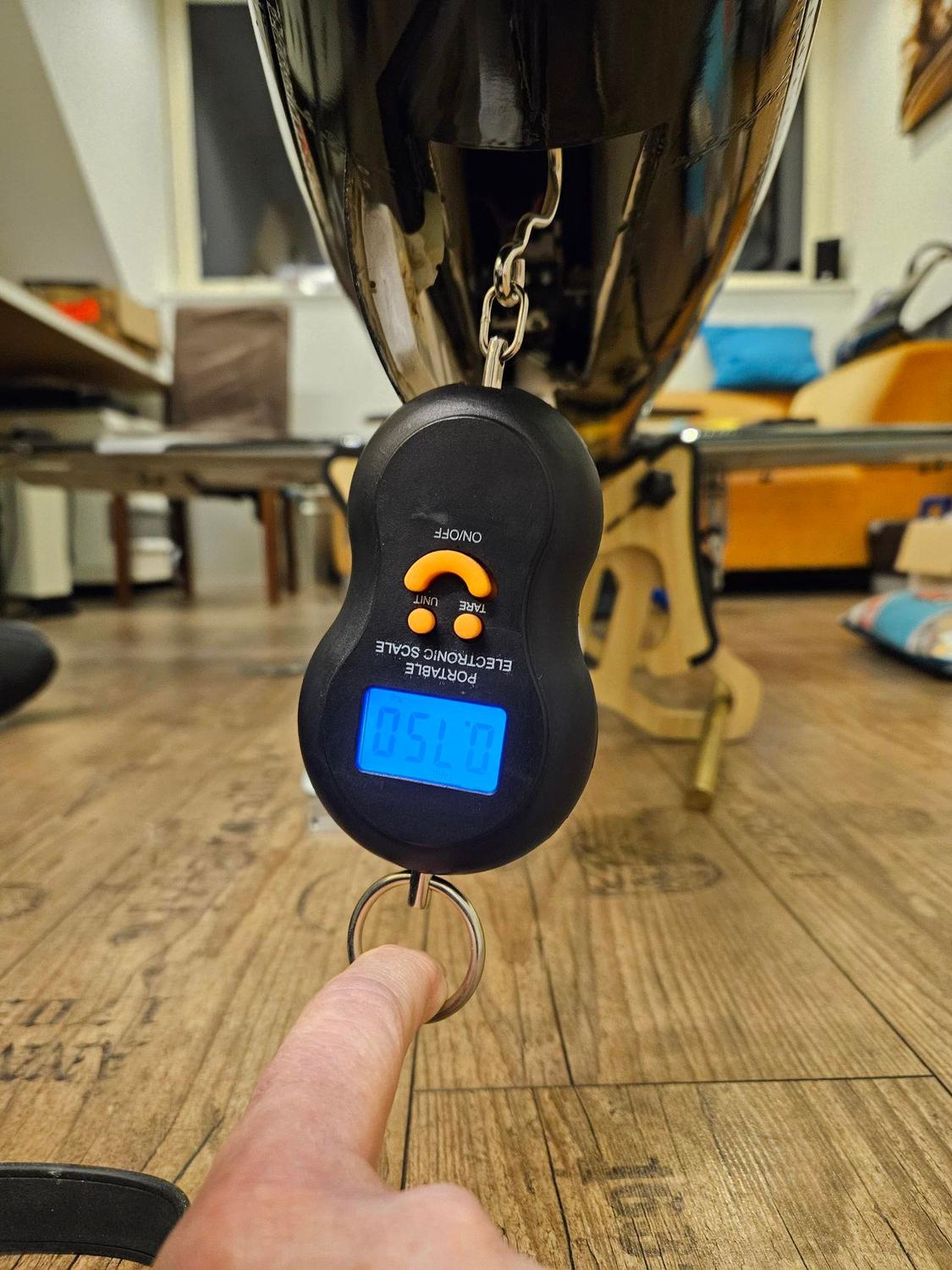

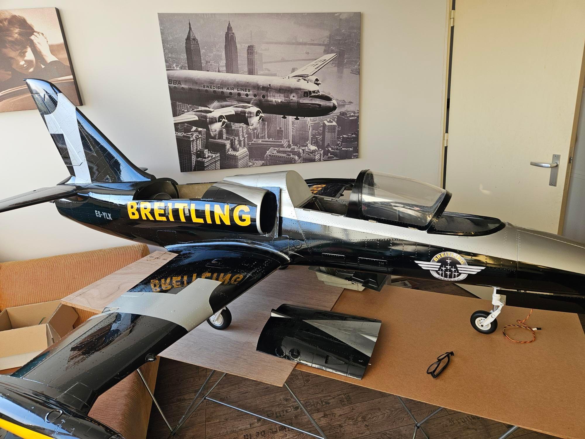

Hello Guys ,
I,m struggeling to find the correct CG around 150-160mm from leading edge I have to add 1400 gram ( 650 Lipo's + 750 Lead ) in the nose.
my setup and can't find more option to decrease the extra weight :
Engine:1700 gram ( with original tube)
Hopper+ Pump +ECU ( when move to front I safe 100-150 gram)
Airtanks under the turbine
Powerbox installed near front.
I read that CG is somehow between150-170mm, any suggestions what I could change or extra weight is common for size of model ?
add some pictures
add 750 gramm to find CG
