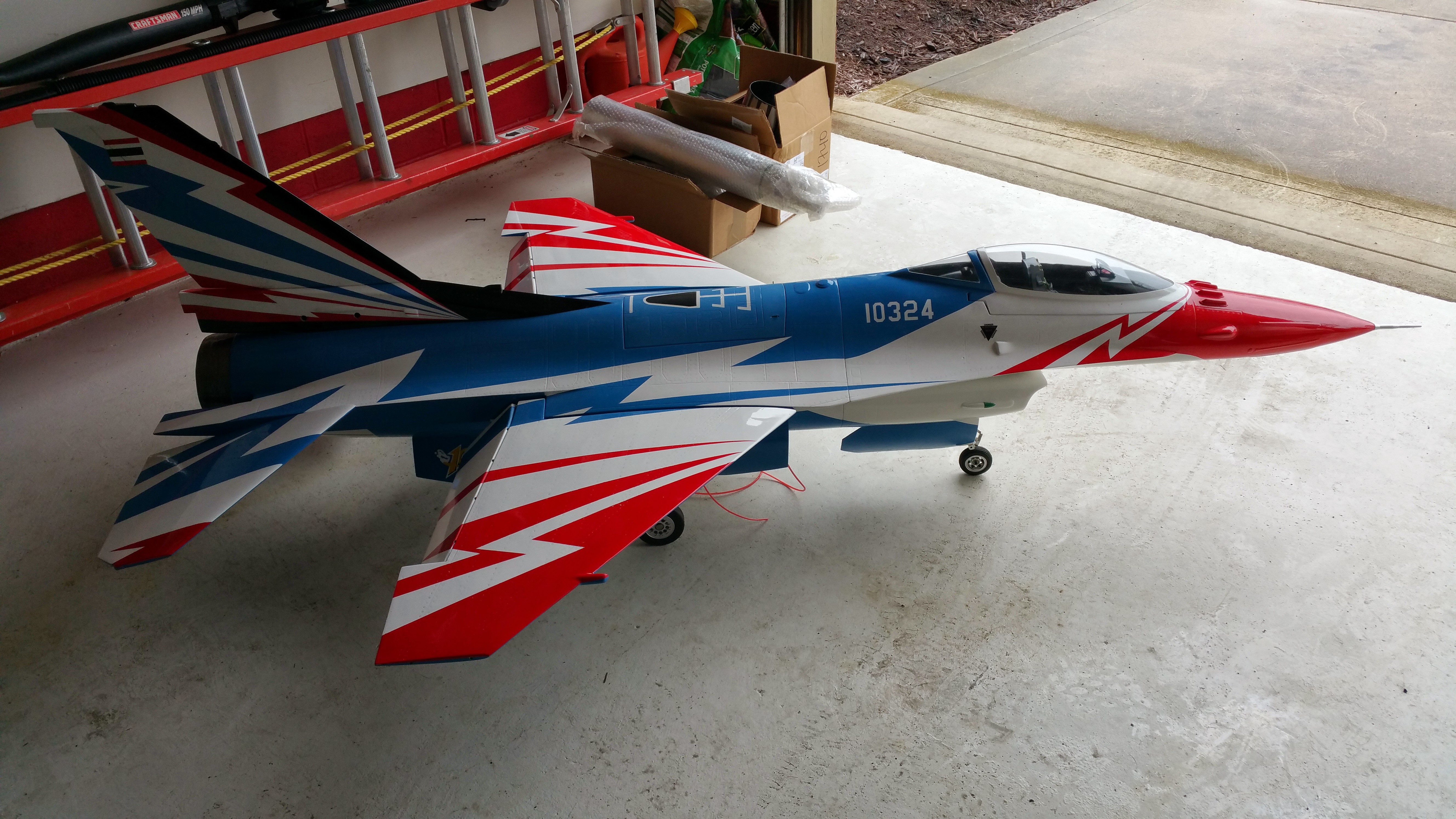

Old 08-18-2015 | 05:57 AM
  #38
My Feedback: (34)
Joined: Oct 2010
Posts: 1,988
Received 22 Likes on 18 Posts
From: , OH
Ill be honest I was very worried about putting to much money into this beast, but I cant belive how much better the Cortex Gyro made this jet fly
Old 08-18-2015 | 06:11 AM
  #39
FalconWings's Avatar
My Feedback: (57)
Posts: 6,998
Received 15 Likes on 13 Posts
From: Fort Worth, TX
What a beautiful model. Ill buy it from you for $15. Thats an ifinite profit! LOL
Old 08-18-2015 | 07:16 AM
  #40
yeahbaby's Avatar
My Feedback: (21)
Posts: 6,564
Received 59 Likes on 48 Posts
From: FT Worth, TX
Cool paint scheme
