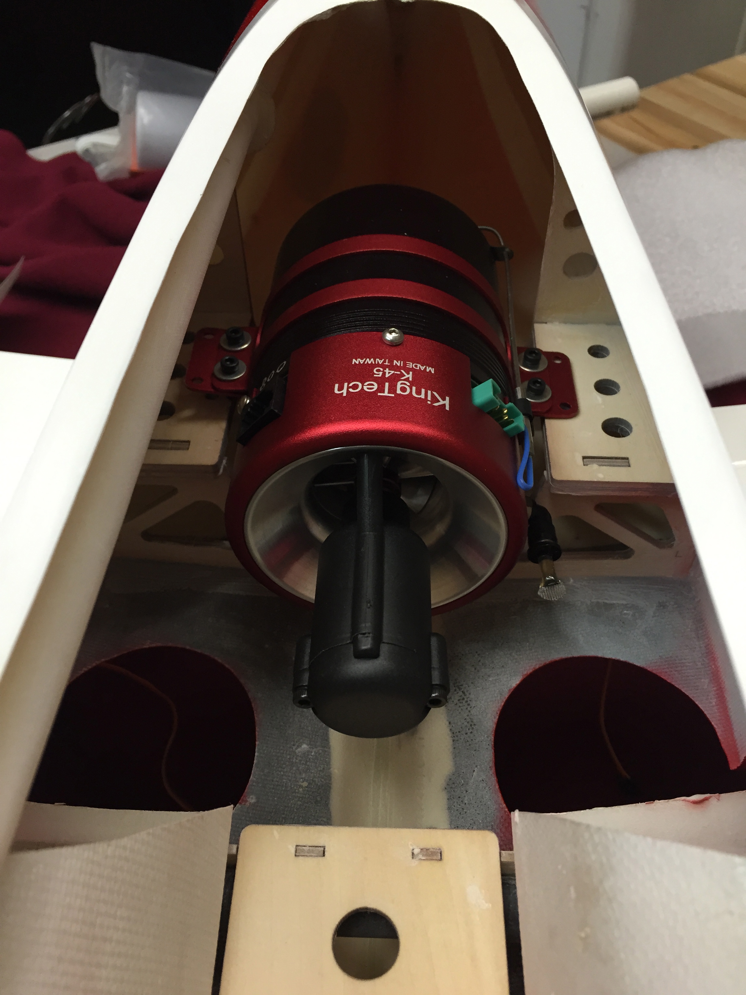

I'll try to steer it back on course. I got mine on Tuesday. Here is a pic of it in the mini Avanti. It is going to weigh about a pound and a half more than the P20 version including 30oz of fuel. I will start a build thread soon. It will fit in the rails with just a little bit of adjusting for the lock nuts on the turbine mount, pretty sweet :-) Just waiting on a few more trinkets from dream works.

NIce! I did a weight comparison between a 8S 90 mm setup and this turbine, with fuel the turbine version would be about 2-3 oz heavier, of course the landing weight of the turbine would be about 1 lbs lighter!

Very good point Bob, don't know why that didn't come to mind. I know that with the Ultra Bandit I had, you were advised not to land with a full fuel load. I think the airframe will be fine, with this motor. We'll find out soon ;-)

Are you using the stock tail pipe which Seba sells, or using a pipe rated for around 45N of thrust?
would you know if the stock pipe is strong enough for turbines above 30N?

I talked to Ilja at grumania, he told me the 20N pipe is not strong enough. He is making me one. I did not ask him if the stock one is good for 30. I'd drop him an email. He made the prototype pipe for the avanti, not sure if he is making the production ones.
The turbine looks at home in this plane, rails are perfect size. I know the P20 needs tabs to move the rails more towards the midline.

Don't forget Wren makes a pipe for the 44 which is the correct size for the K45. It is available in single and double wall from Ron in the USA.
P20 version... which weigh in at atleast 1lb more then with another small engine. That makes it probably 3lb heavier with K45 then if I would have set one up to my preferences. Looking forward to seeing those two versions flying along side :-)
