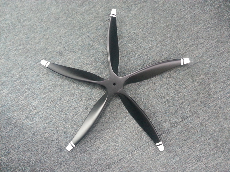

Originally Posted by David Jackson
Kirk, I have not found a five-blade prop with the pitch/diameter suitable for the K-60TP. However, Gerhard (Aircraft International) sent me an email stating that Biela Propeller could make a three-blade 24x22 prop. Waiting for cost info.
What about the 5-blade used by SM and shown on the website?

I got the SM prop on the way, but not sure of the diameter, or pitch. Would like to get the max performance from the K-60tp, so looking for other available options.

That skymaster prop is huge. When I had the K60 at Florida jets it had that prop on it and it was a beast. I could not believe that little engine could spin that huge prop.

Originally Posted by George
What about the 5-blade ...
Got the Skymaster five-blade yesterday. The numbers on the prop indicate that is a 24x23.5. The prop seems a bit heavy, but pretty much balanced out of the box.
Wow, that seems like quite a load, but apparently it works...Are you planning on using it or the one you ordered?

That's a lot of prop

My current plan is to use the 24x17 SEP three-blade prop for the maiden flight. If the performance is decent with this prop, I will use it for the remainder of this flying season. I may just save the Skymaster prop for the K100 TP when it is released

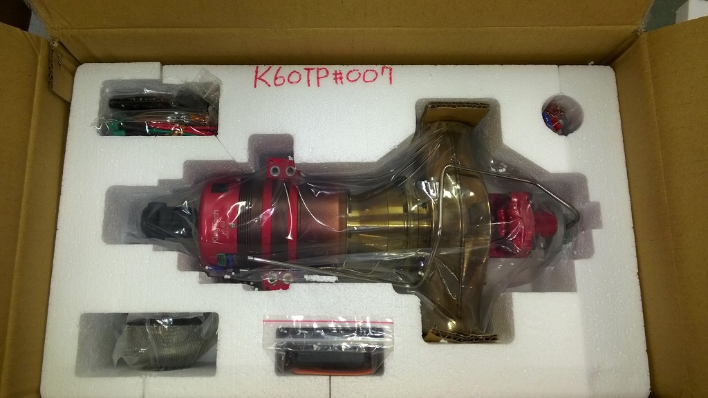

Serial #007 has arrived

Congrats!

That turbine looks great. How it comoRes to the SPT-5 in terms of power ?
I have 2 x SPT-5 in CARF airplanes. One moves with authority a Marchetti and the other one is only OK for the Tucano. The Tucano is an older model and a heavier one so it would benefit of more power. I've been thinking on a SPT-10 but this new Kingtech looks like a good alternative.
any my reports on performance in the future would be appreciated.

The suggested prop for the Kingtech 60TP is a 24x20, or a 24x22 three-blade prop. If I remember correctly, the suggested prop for the SPT 5 is 24x12, or 24x14 three-blade. Started my K-60 TP for the first time this past weekend using a 24x17 three-blade SEP prop. Only ran the engine for a short period, but never above
1/2 throttle. I was impressed by the power of this little jewel. (Manual states power is 7.3 kw at 7000 rpm)
