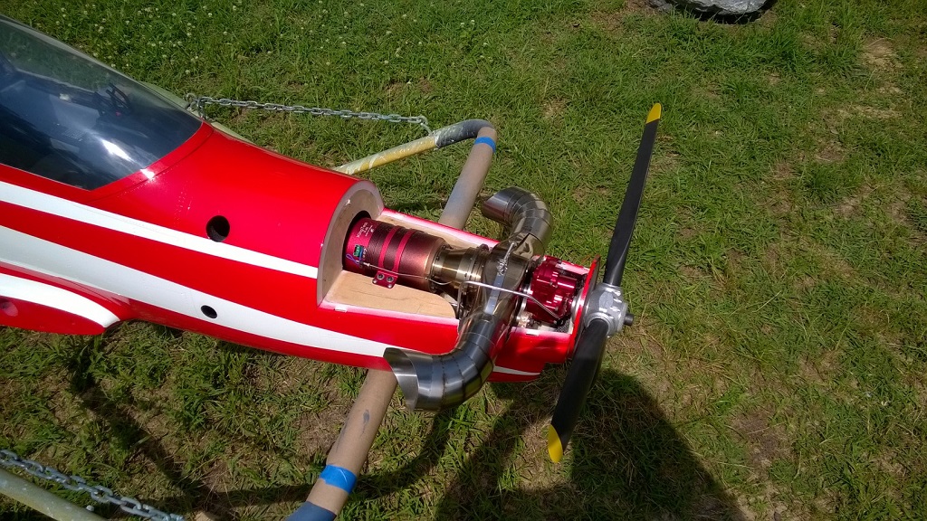

Thanks for the info David. I have a 3 blade 22 inch solo prop with Corsair profile blades. I'm going to do initial runs with that prop. The pitch can be adjusted from 0 degrees to 24 degrees and the blades can be individually replaced.
Kirk
