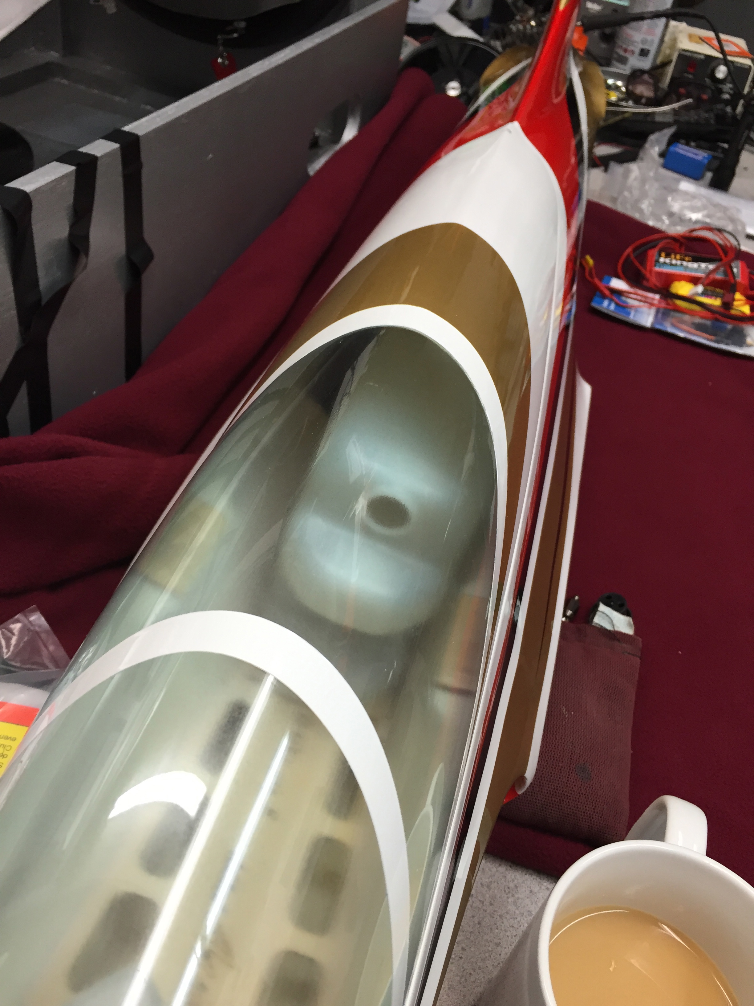

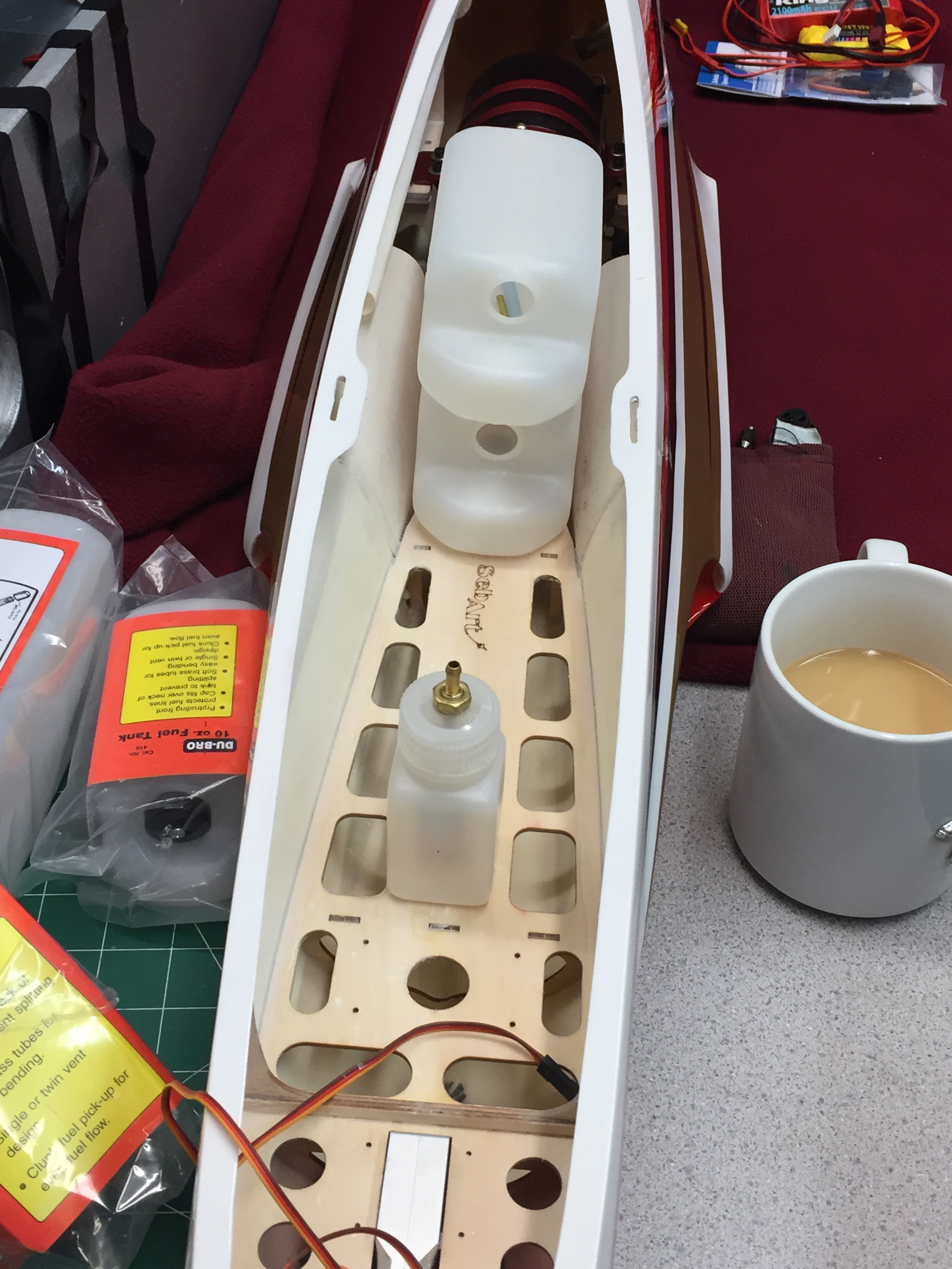

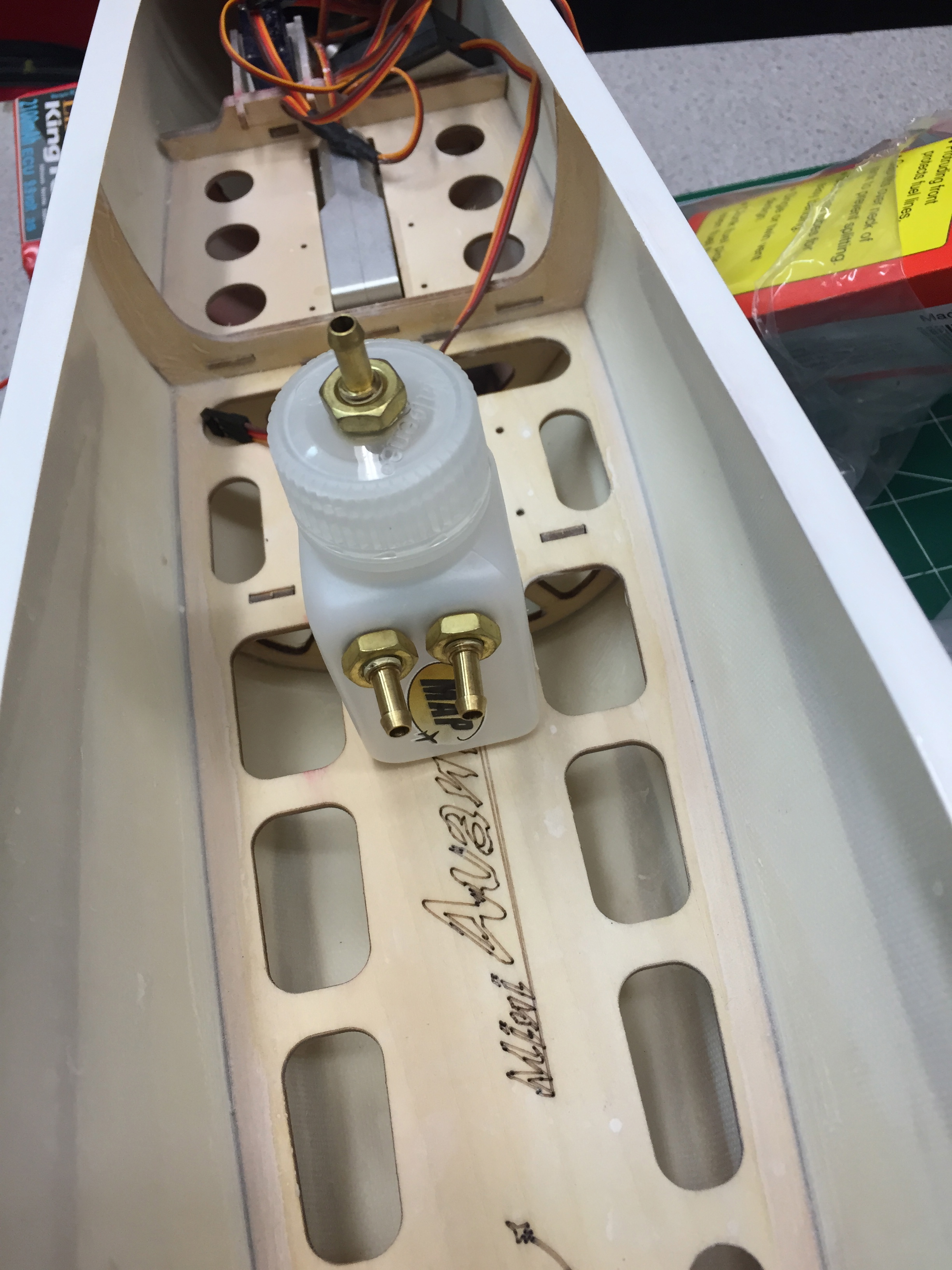

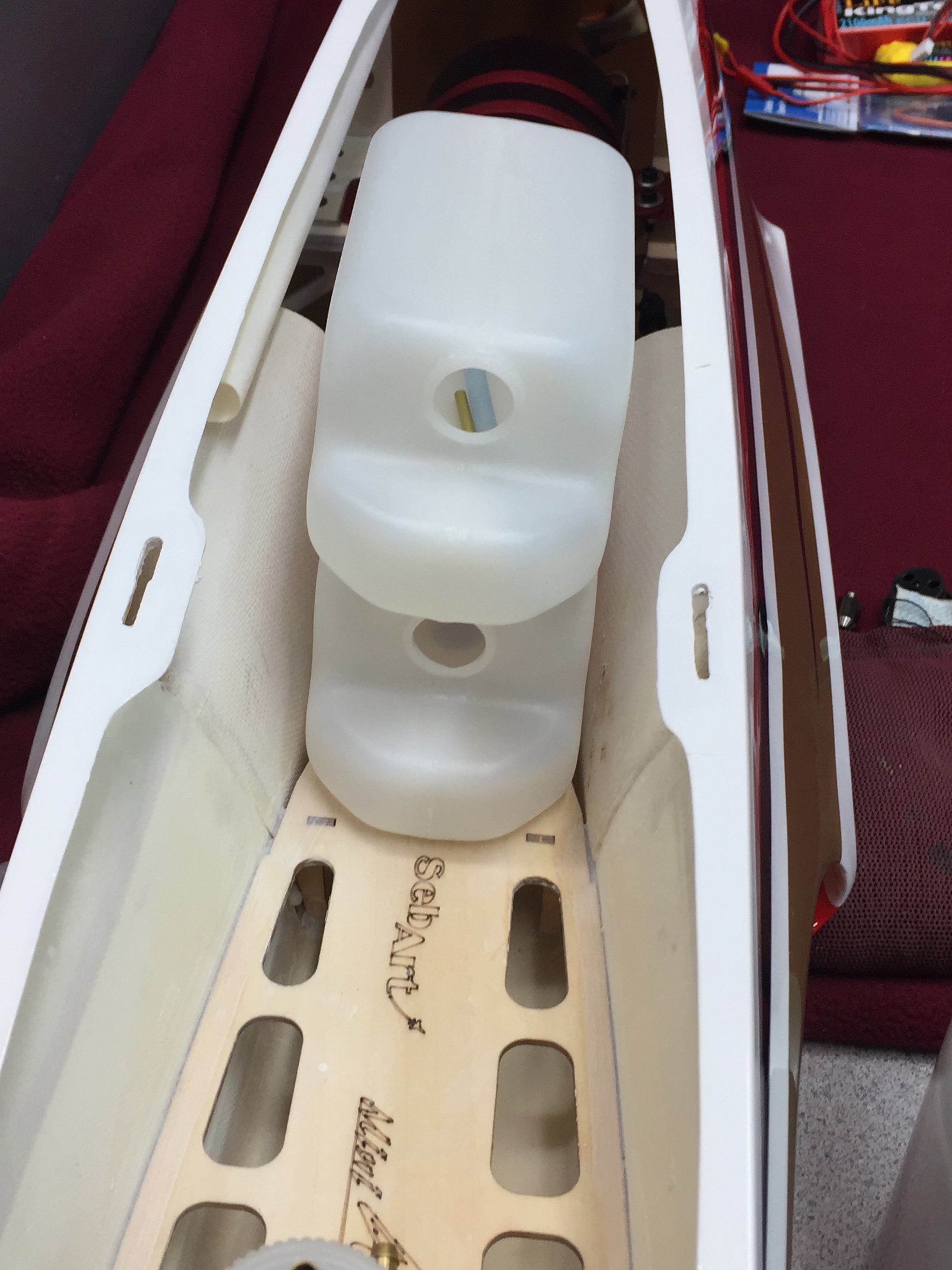

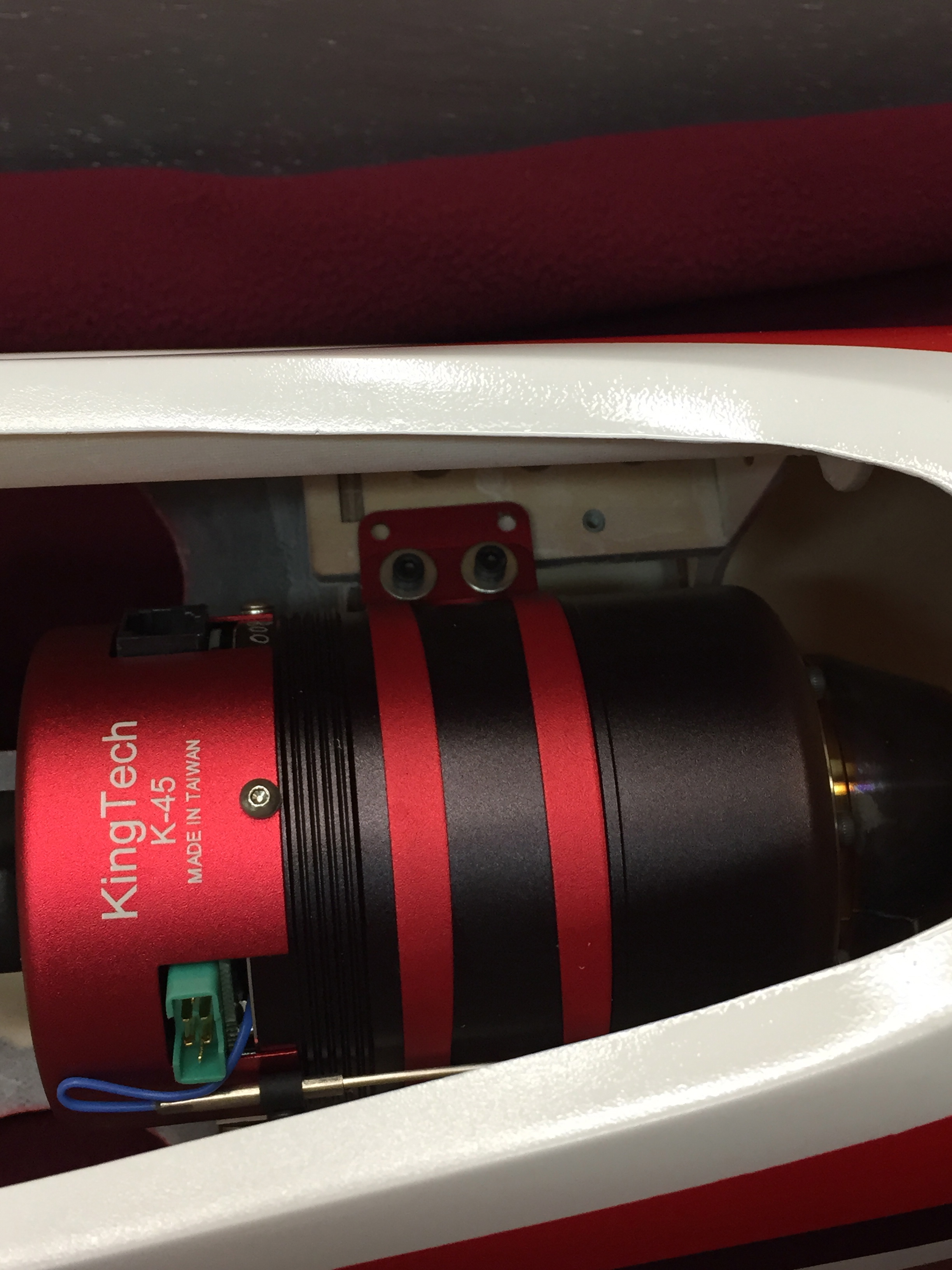

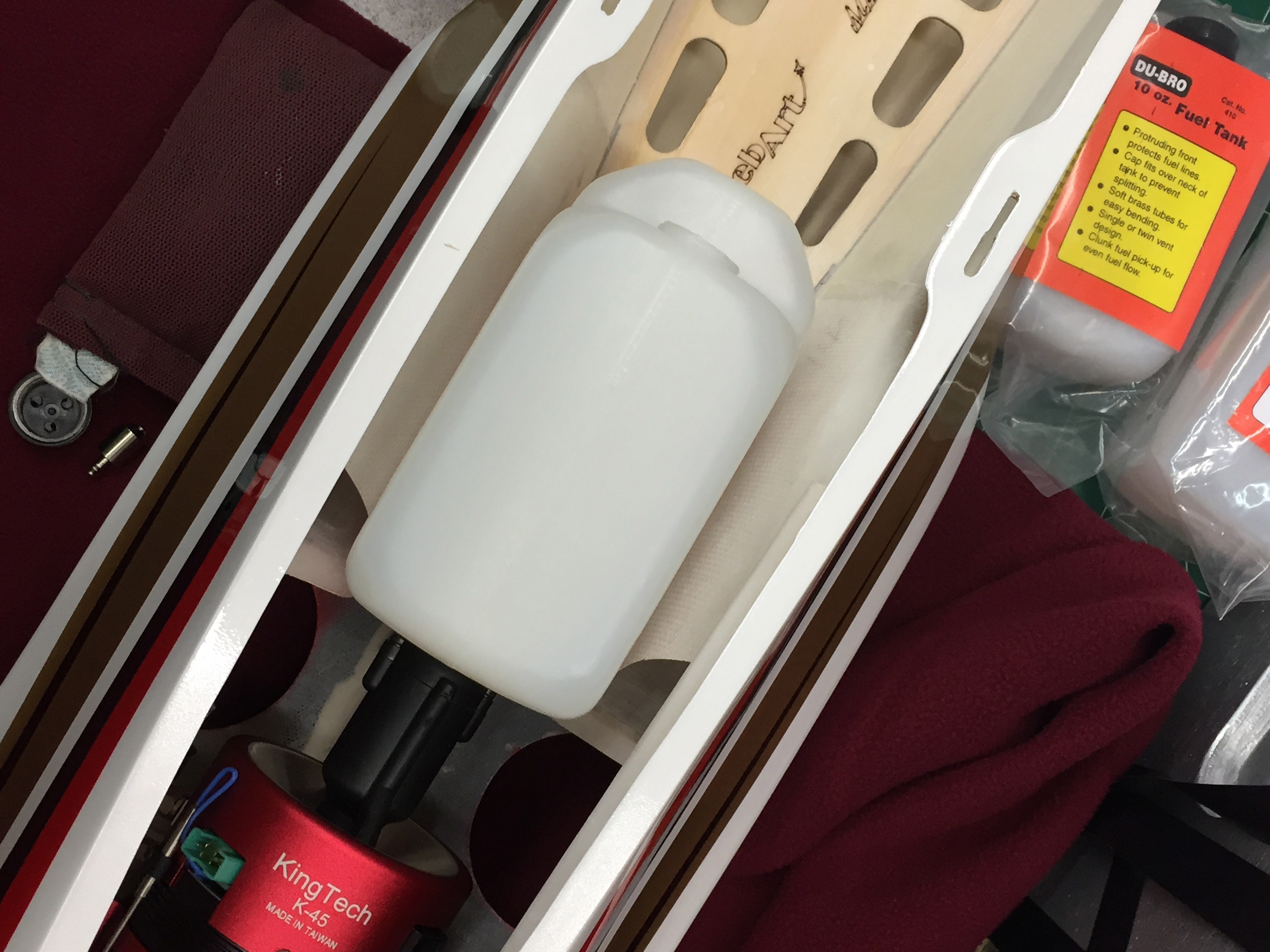

Had a chance to play with fuel tank positions. The intakes are very thin glass, they can deform easily. The 16oz dubro fits on the rails almost perfectly without pushing on the intakes. The 20oz does constrict them a little more than I'm comfortable with. So, I'm going to go with a 16 and 14 on top of each other. The cockpit floor that is provided will not fit without adjustment with the tanks in this configuration. I don't like cockpits on sport jets and will be painting the canopy glass a solid color like I did on its big brother. I'll do a small cutout on the tray for the UAT to sit flush. The fuel pump and UAT will be near the rear nose gear bulkhead.
I looked over the build thread I did for the medium sized avanti last year. I thought I would get 8-10 minute flights with the 150oz of fuel on board. Not even close. I only use full throttle on uplines and when I'm doing tumbles and flat spins, the rest of the time I cruise around at half throttle. with 150oz, I probably have 10-20 oz left with a 6 minute flight. So, I am skeptical of the published fuel burn. It would make sense if it was an average, not at a full throttle measurement.
With the turbine as far forward as I can put it, without making new rails, the distance for the pipe is 475mm from the back edge of the fuse. The two pipes that WREN offers are the wrong size. Already sent an email to Ilja at Grumania for a custom one. Price is around 100 euros.

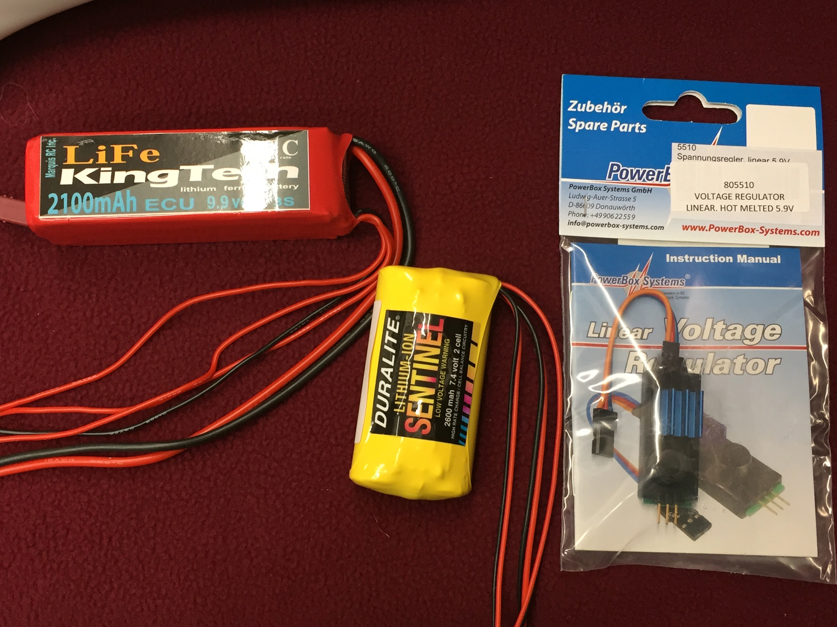

I am using a lion 2600 pack from duralite, and a small duralite inline regulator. The ECU pack is a 2100 LiFe pack from Kingtech. This battery is not supplied with the turbine, so don't forget to order it.

Dr Scoles.... can the retracts (door servos) handle Lipo direct. Since you are using A4030, as they are HV servos, I'm hoping to avoid a regulator...
Old 05-14-2015 | 08:36 AM
  #45
Joined: Jun 2004
Posts: 752
From: , INDIA
if not mistaken, a VR would be needed.

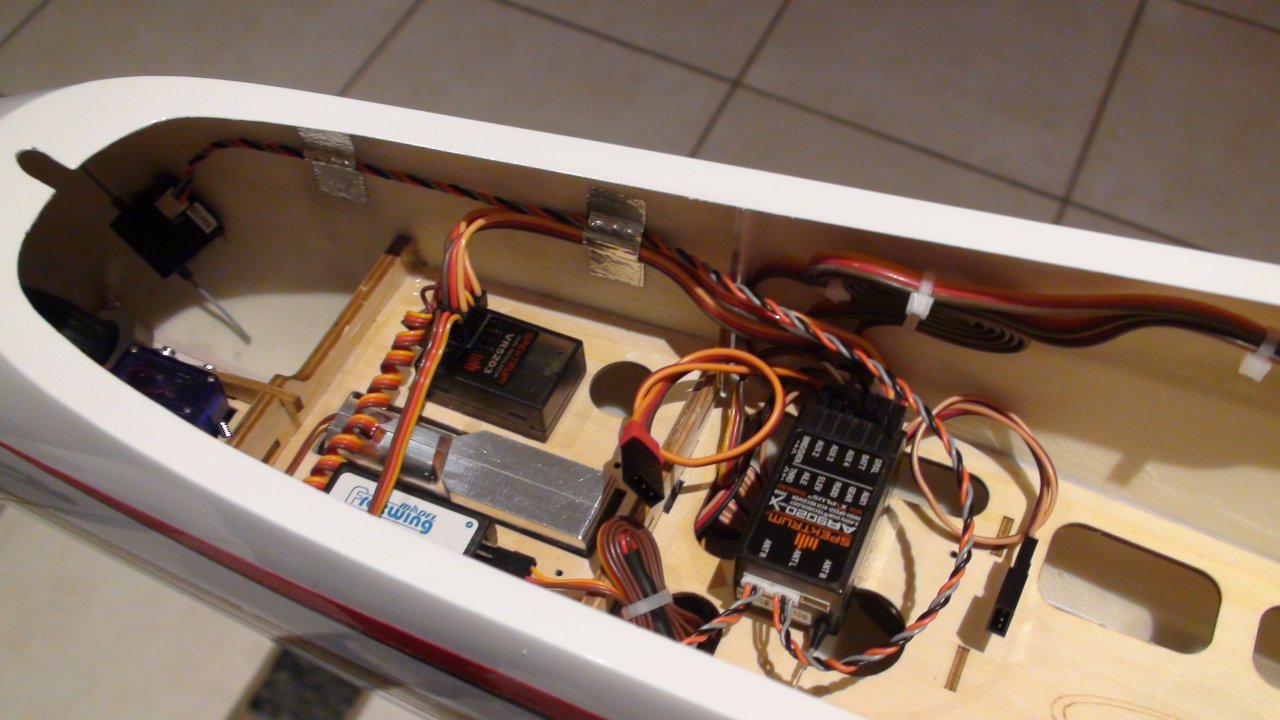

The factory-installed electric retracts, nose gear door servos and steering servo can NOT be powered by more than ~ 6.0V. So if you use HV servos for the control surfaces and want to power them with a 2S 7.4V LiPo you'll need to use a regulator to power the retracts, nose gear door servos and the steering servo. But because all of the retract units and the nose gear door servos plug into the included sequencer, you can plug the one lead from the sequencer and the steering servo into this Spektrum VR5203 two-channel/dual output regulator like Jack did in the EDF version build thread here:
http://www.spektrumrc.com/Products/D...odID=SPMVR5203

Thanks Jason.... I'll use "LiFe" or "A123" direct...
