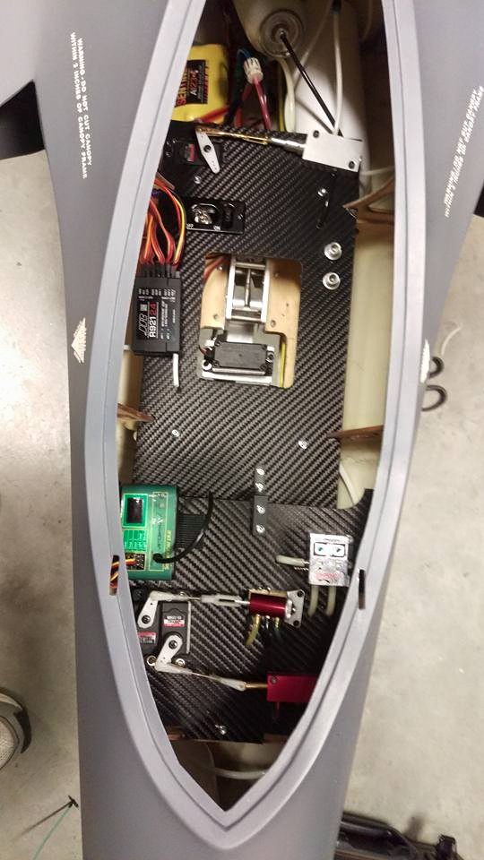

Getting ready for maiden. Since there are not that many out there, was wondering if anyone could confirm CG and throws.
Mine came out at 38.5 lbs dry, UAT full. CG at 100mm per print.

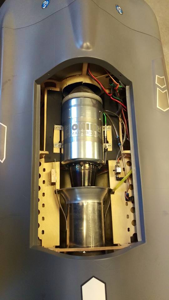

I have to say, this being my first 40lb size airframe......it was soooooo easy to install equipment! I could probably double the amount of fuel easily (or fly with smoke on for 5 minutes non-stop). Rhino looks tiny in there.

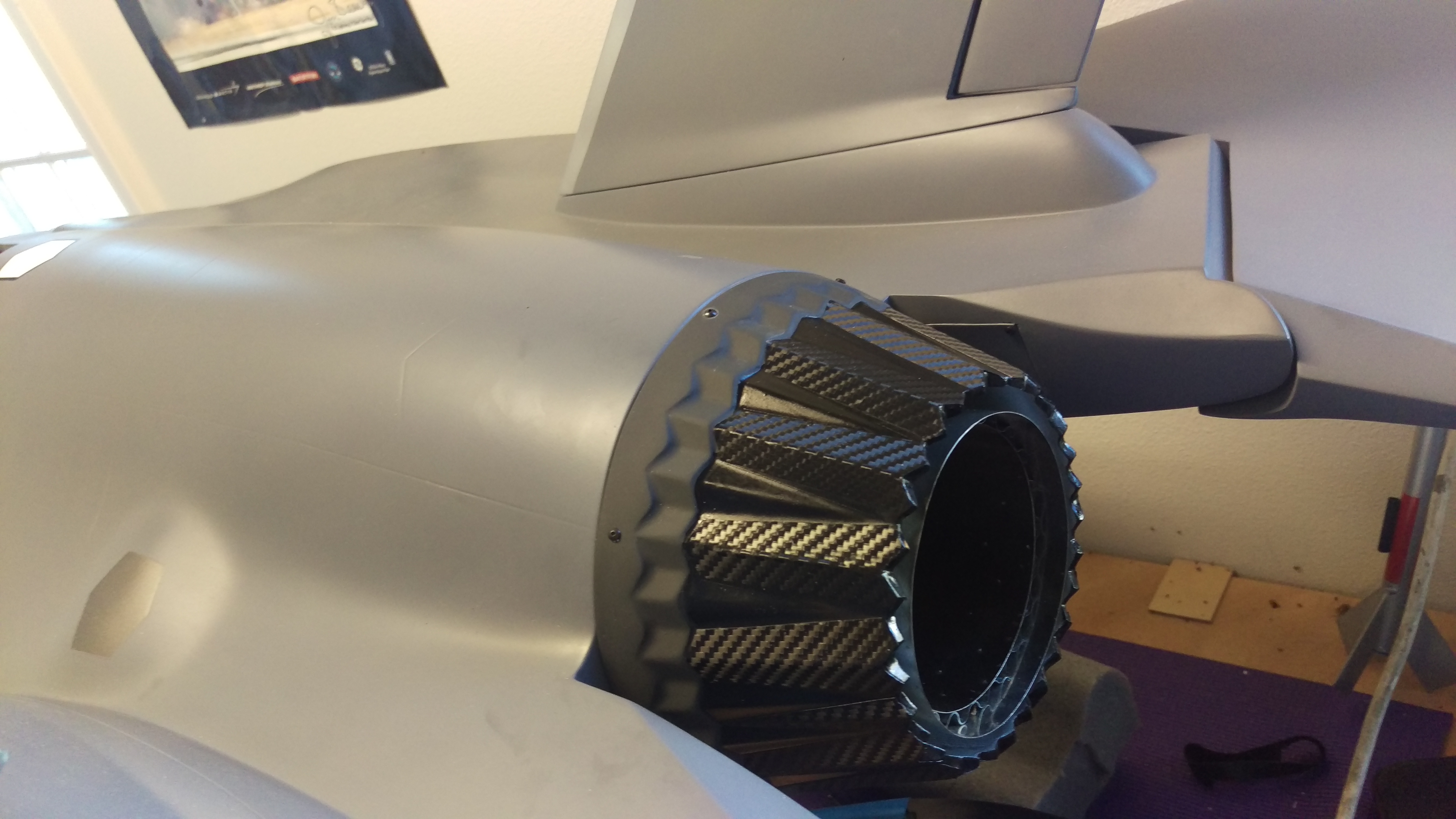

Well, I fell crafty today and decided to make a scale exhaust. BTW first time Im able to upload a pic from an Android device!
