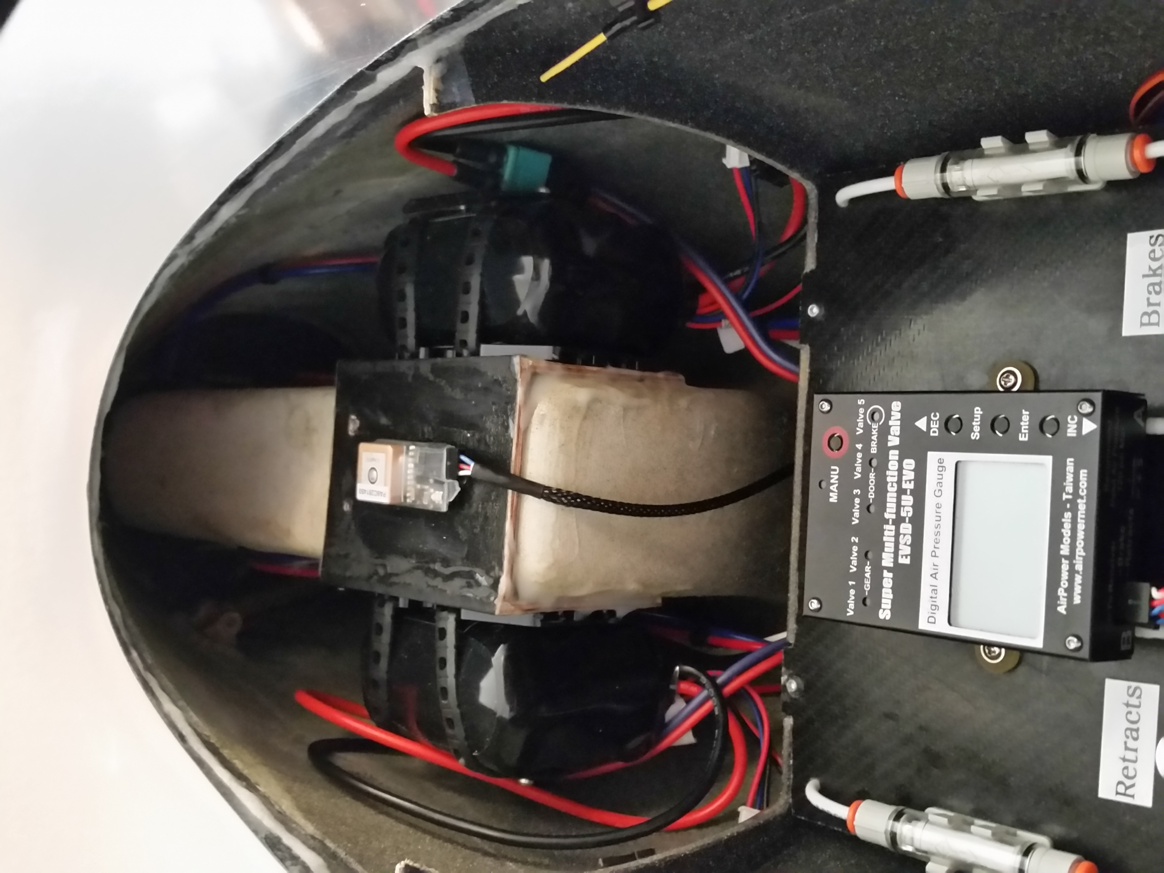

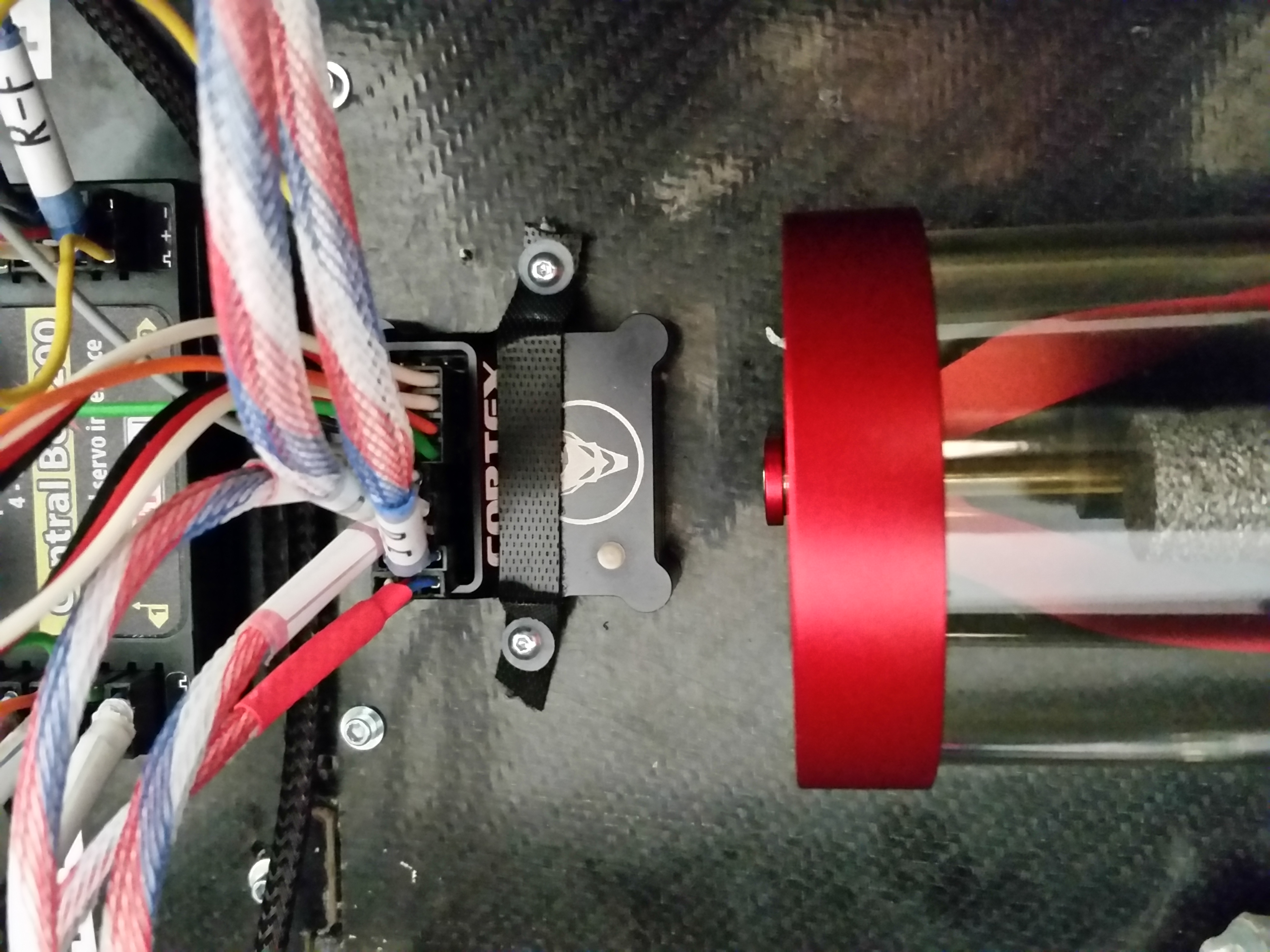

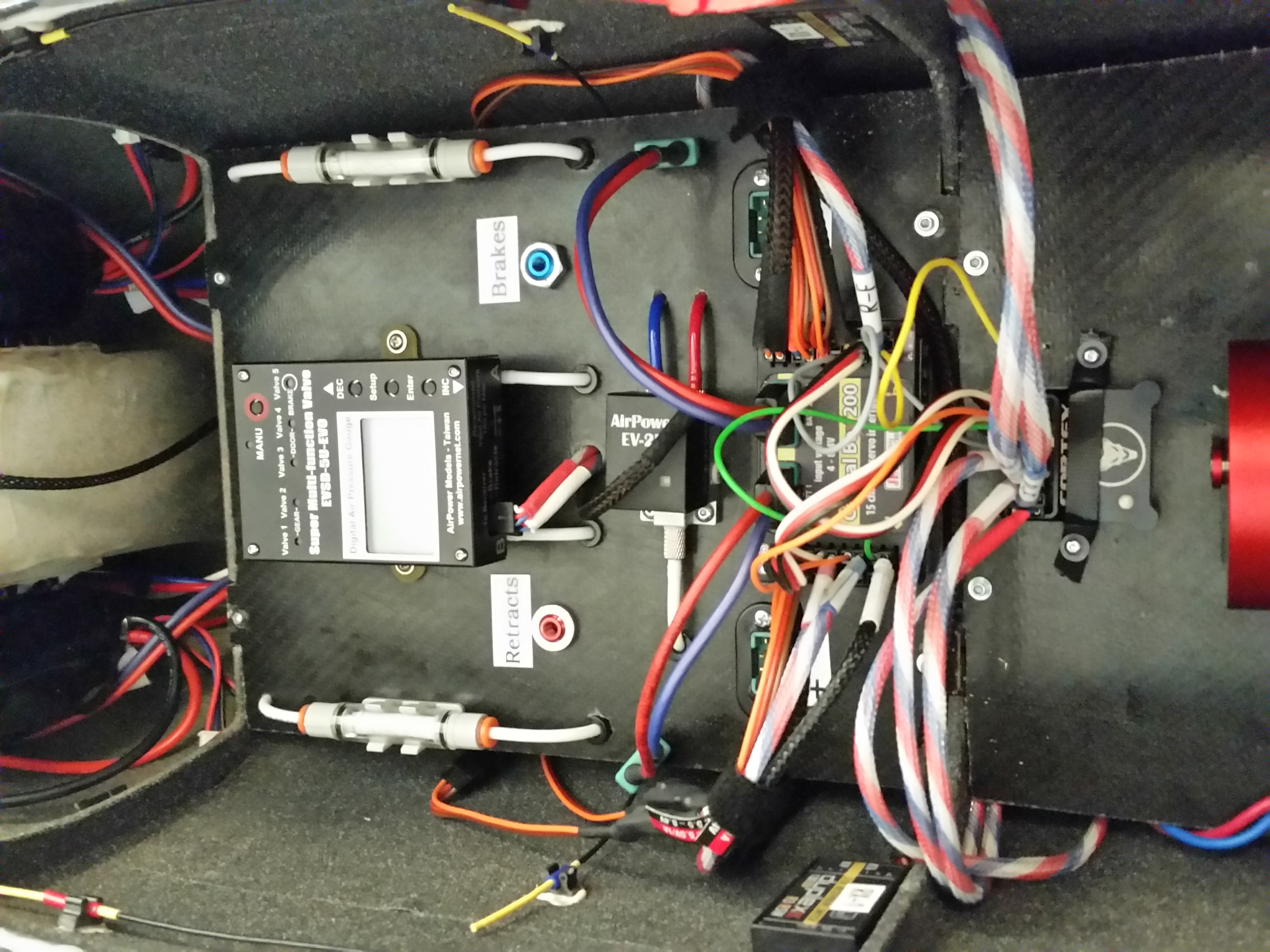

Here are a few more pictures. I recently added the Cortex Gryo and have it programmed. This passed Sunday was going to be the maiden but I had a servo wire break on me. I can say that the powerbox premium servo wire is very easy to break if not careful. So I fixed that and now I am hopping that this Sunday is nice and we are able to fly. If so we will put the first flight on this Viper!

So today was a great day! We got the maiden on the Viper. Now as the flight was very nice, I once again ran into some issues that I wish didn't happen. The first thing was my cortex gyro stopped working. It worked find the night before and that morning before loading up to head to the field. I get to the field turn the viper on and no movement on the controls. I waited for the 6 sec and went to move the sticks but nothing. I did that process 3 times and nothing. unplugged the gyro and put my control surface back on the CB200. Worked like it should have. The next issue that I had was that my retracts didn't want to retract. I am still trying to figure that one out. The air maybe bypassing the o-rings in the air cylinder. I will have to pull them out and check them. So the flight went with no gryo and landing gear down. A little bit below half throttle and pretty strong winds. I felt that that it flew nicely and cant wait to get these issue fixed to open her up. I want to give a big thanks to Duke from our club for conducting the maiden on for me and checking this thing out. Here is a video of the flight. It was taken on the phone so please forgive me if its not top quality.

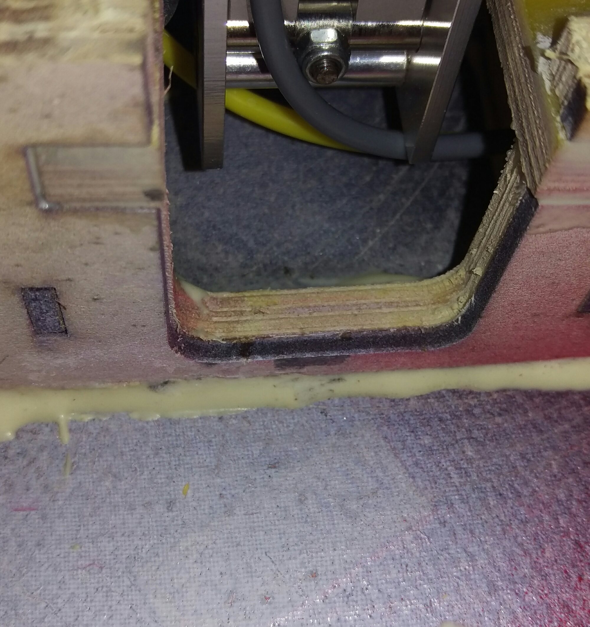

Just keep an eye on your landing gear mounts, specifically where it's adhered to top skin of the wing (U shape area in former). I've had some minor separation ill be bulking up.

This is the area in question. You can't see it in the pic but it the former has lifted from the top wing skin.
If you apply pressure it's easily visible. If yours hasn't come off yet I would strengthen with some additional ply.
