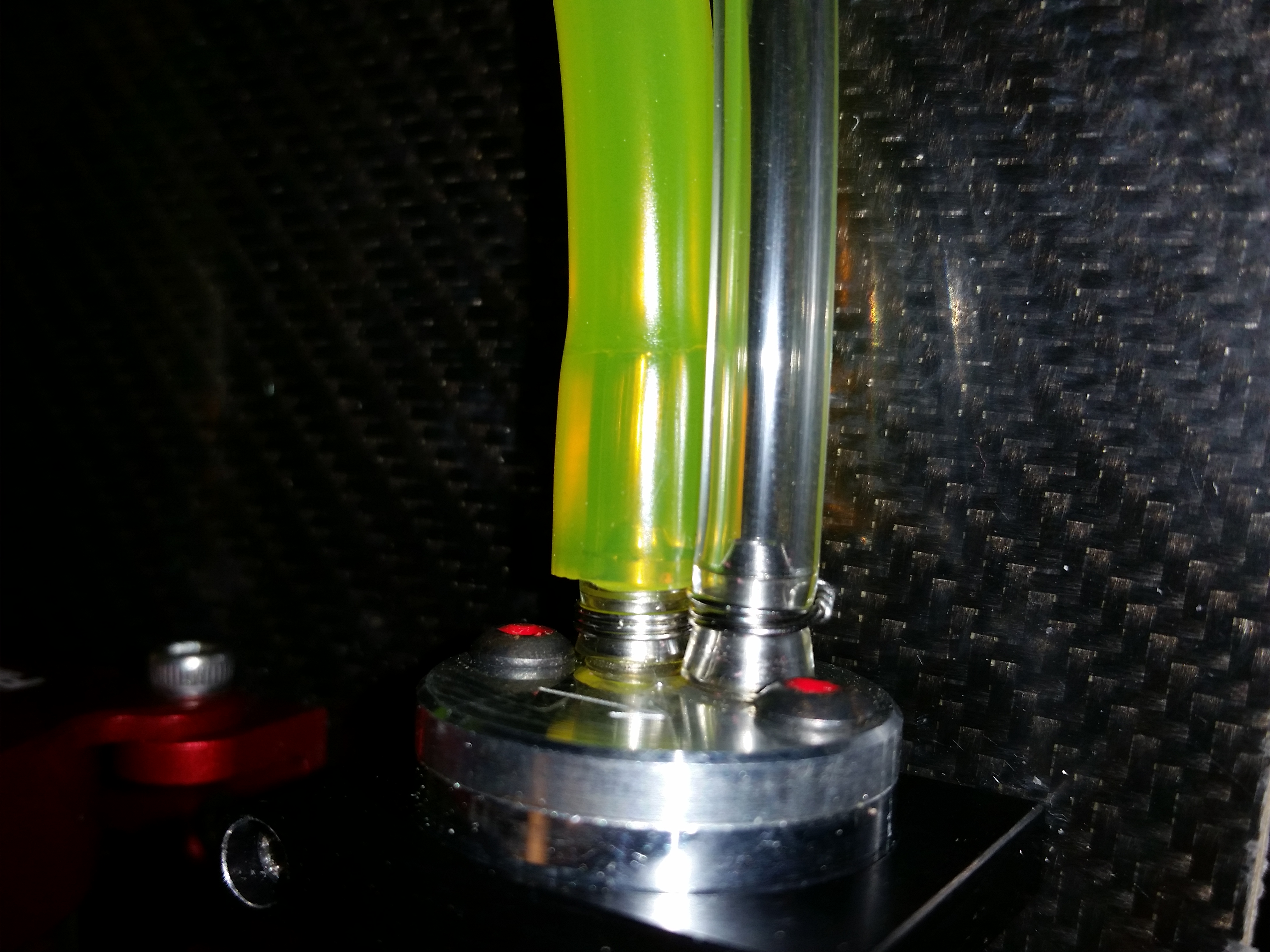

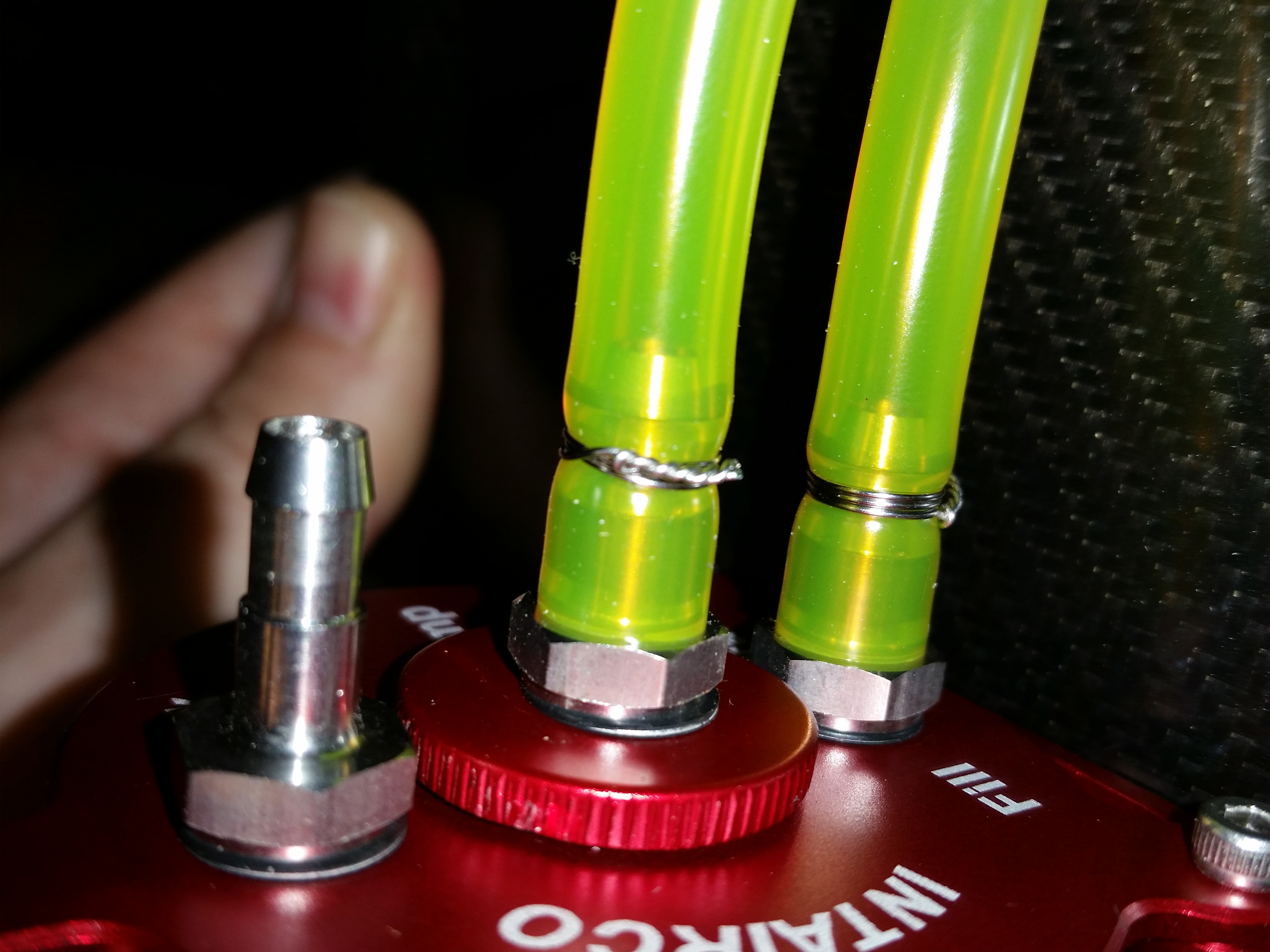

I NEED HELP!
Okay so I'm about to order my fuel line, trap, etc but needing a little help. I am putting in the K140g turbine but was wondering if I should you 3/16 fuel line for it from the tank back. I know I will have to replace the stopper in the tank that FB sent me due to the copper tubing not being 3/16. I need help figuring this out. pictures would be nice of your fuel setup.
Thanks guys/gals
Old 03-15-2016 | 10:43 AM
  #56
FenderBean's Avatar
Joined: Feb 2006
Posts: 7,213
Received 99 Likes on 65 Posts
From: Huntsville AL
This is a place I always over do it, I really over do it on the vent side. I would suggest just using the bvm high flow fuel line, clunk line and even there hi/flow fuel tank fitting. As for air traps I have used MAP hi-flow and now use the interairco hi-flow. Just because they are clear and have easily replaced filters. BVMs hi flow will work as well.

Thanks Keith. I will do that then. I was looking at ultimate jets fuel tank fitting and hardware but I was unsure about it. I will look into BVM and get the pricing down. lol I was looking at the interairco too. I had seen that you had one and was kind of sold on it after seeing yours and reading the reviews. I will be ordering one soon from Chief. DreamWorks is out of stock and has been for a little bit. Another question, do I use the 6MM (3/16) tubing from tank to trap then from trap to pump and from pump to shutoff valve then a reducer Festo fitting from 6mm to a very short 4mm run to turbine? I would think that this would help reduce the flow restrictions. On anther note, I got some items in to almost finish up the wiring. I got the items in form FB and reinstalled the air cylinders and about to hook the airlines up. I am currently working and getting the equipment plates fitted and put in so I can start laying out my placement of items. Here is a few pictures.

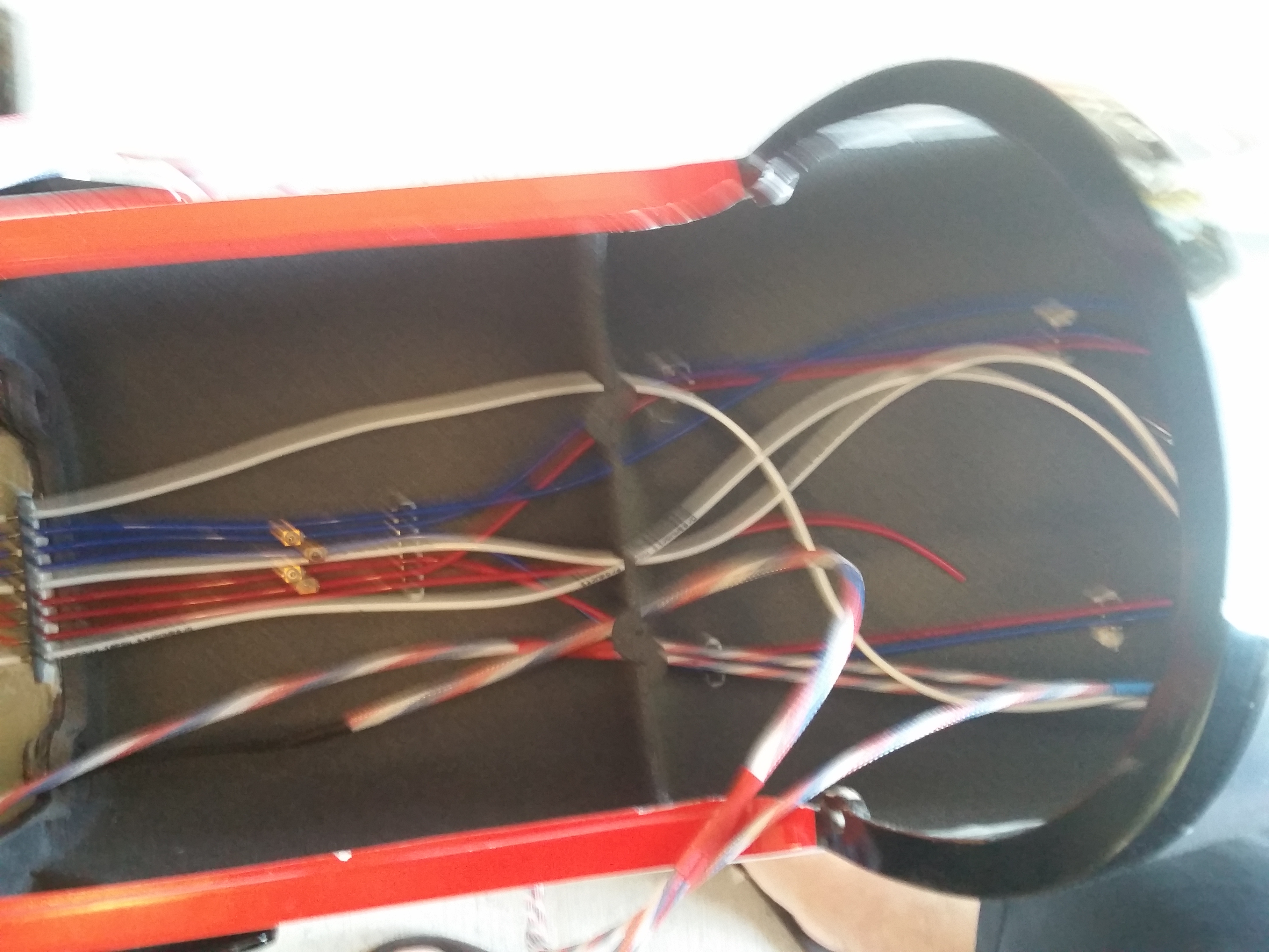

Okay folks, I am getting to the last stages in my build and will post pictures soon. I am still waiting on a few small things to come in. But on that note I am about to order my batteries for my Jeti CB 200. I have a mix of JR 8911HVs MKS 777HVs and one MKS 1220HV for the nose wheel. Input Voltage on the Control box is: 3.5-15V. The MKS servos are rated for 7.4V to 8.4V and the JR looks to be rated at only 7.4V. I need help figuring out what is the best or recommended batteries to use. I will being using two on the CB. Please help I am trying to order them this week. I have read other post and I am just a little confused. I like the Life packs but they don't come in 7.4V or does that really matter with life packs? I have also looked at the Lipo packs. This is my first time with all HV and its been a while since I bought any batteries. Thanks everyone.

If the receivers can handle the HV then go with 7.4 lithium ions. If you don't care about the HV servo torque or the receivers can't handle it go with the 6.6 A123 packs from electrodynamics

Thanks prabhat. I'll have a few more picture to post soon. Thanks Keith, I want to make sure I have the correct battery packs to feed the the servos

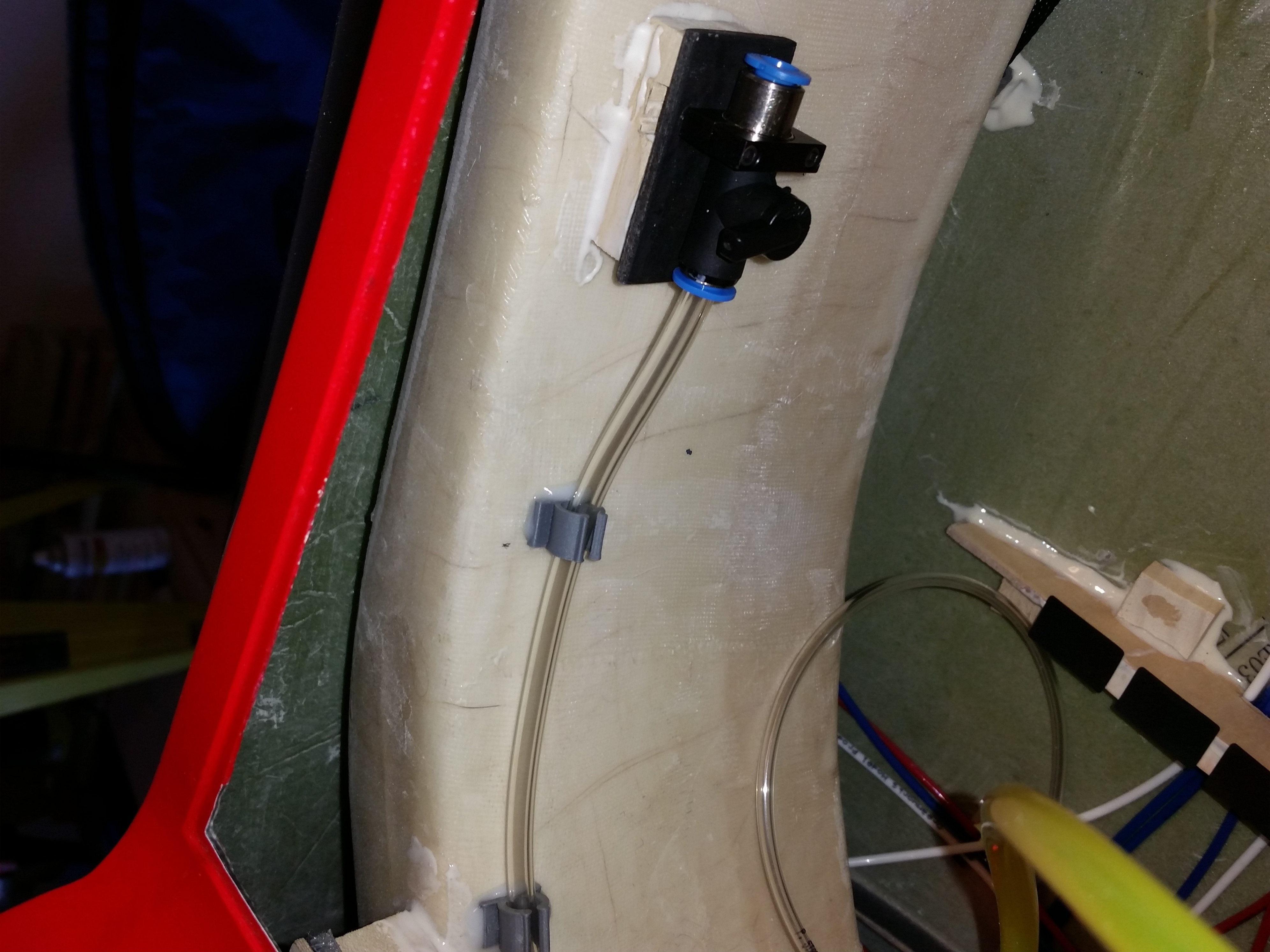

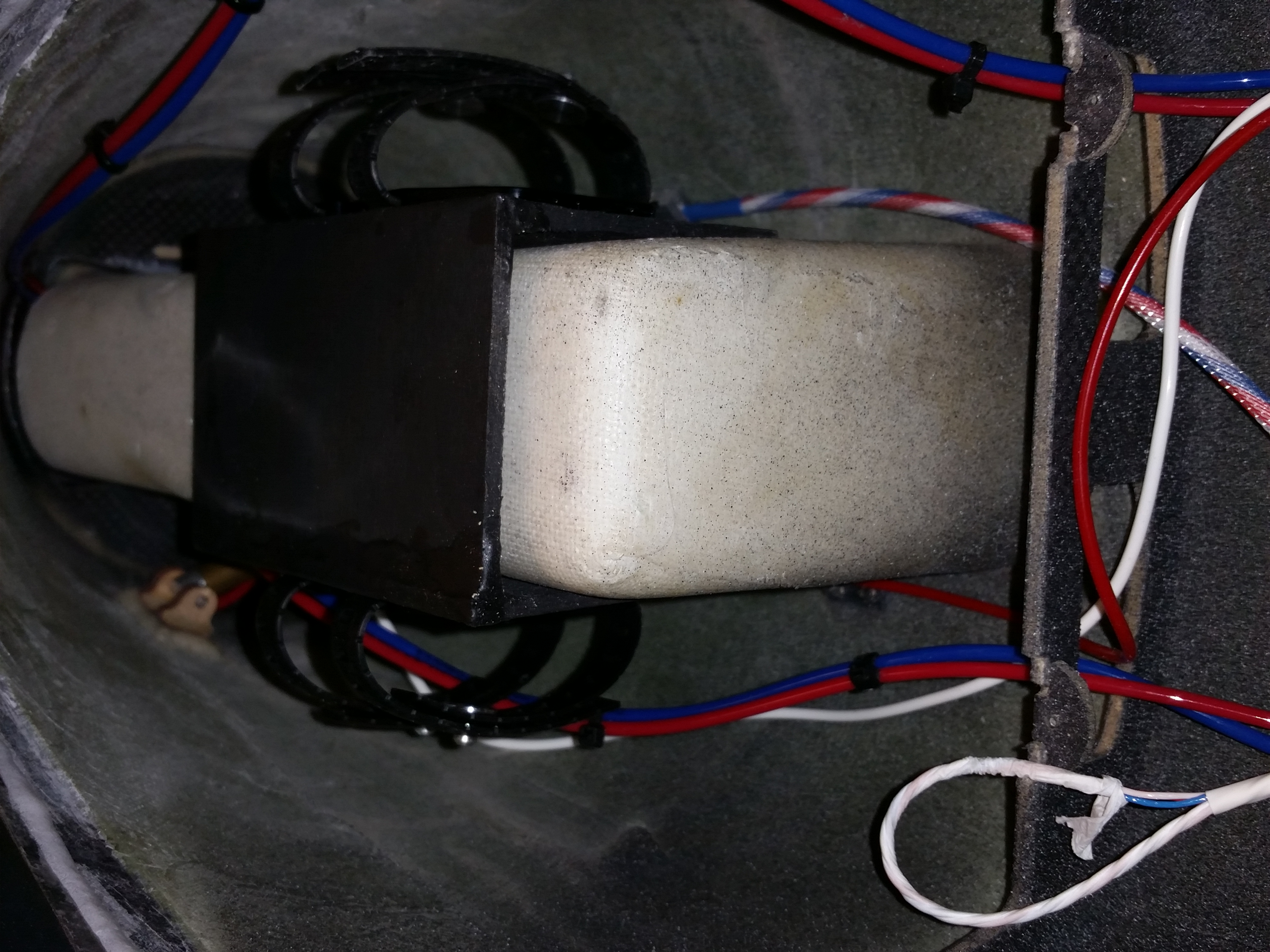

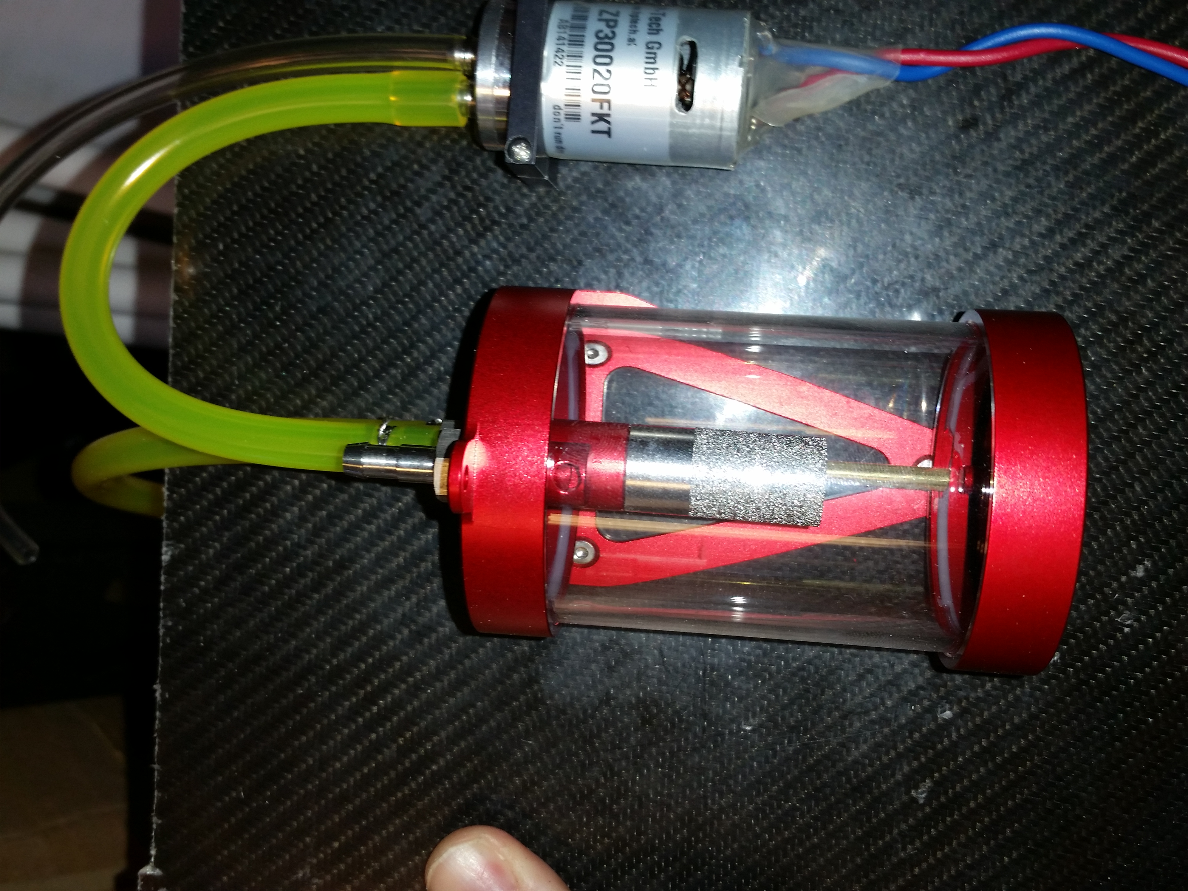

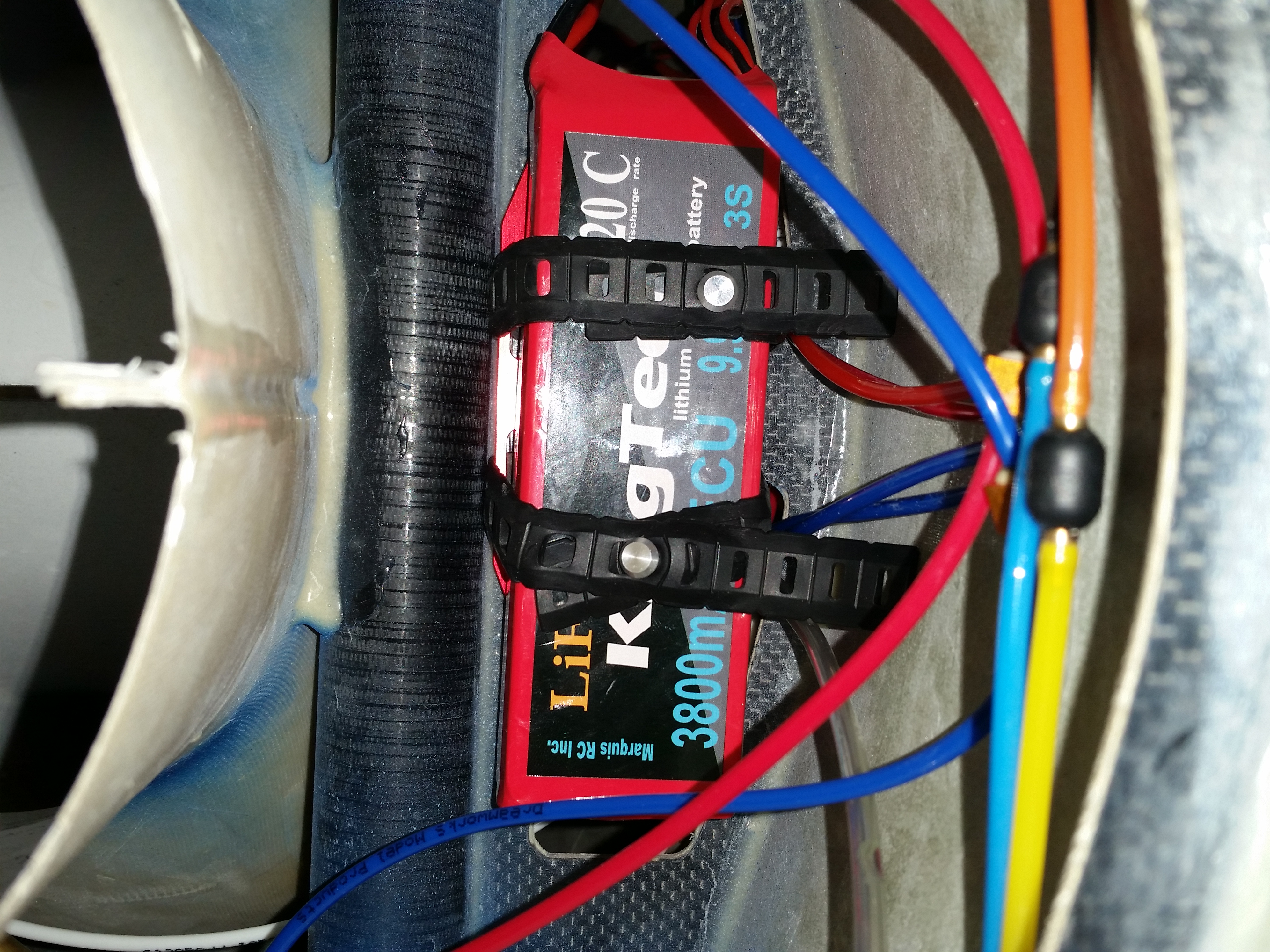

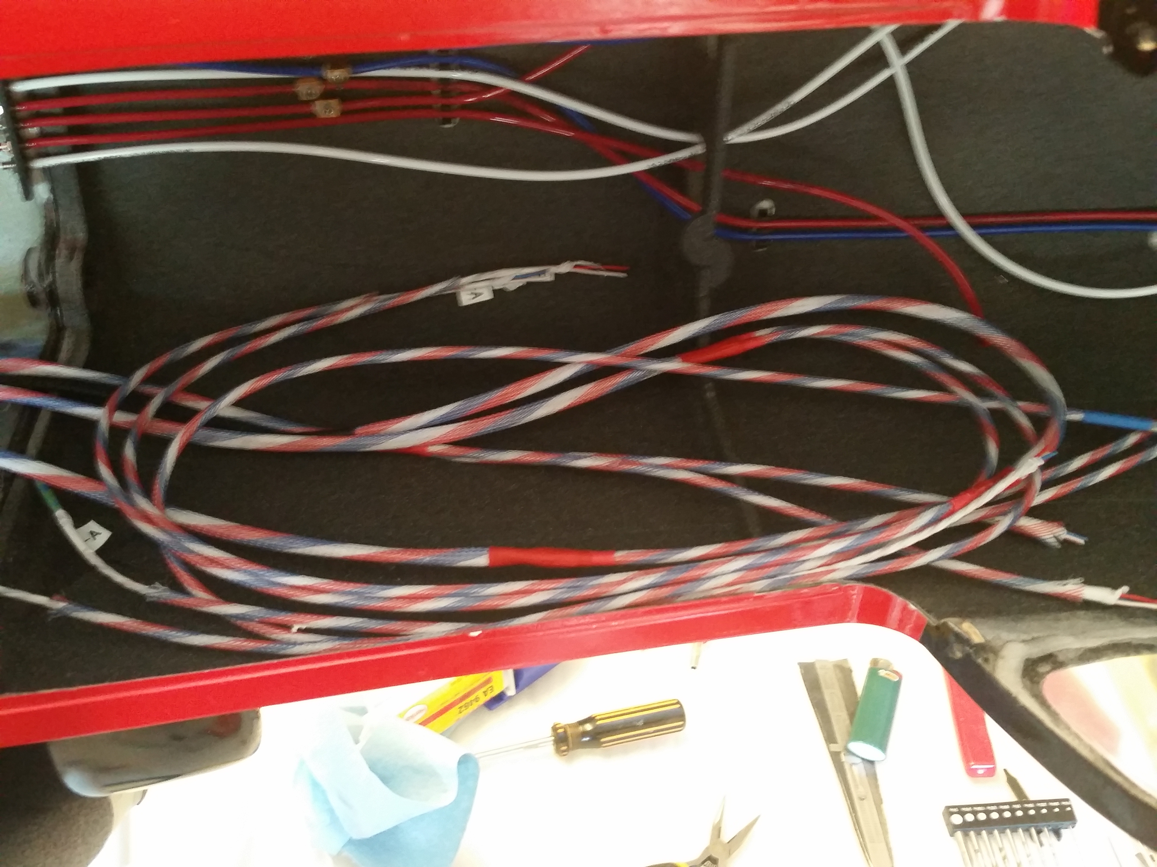

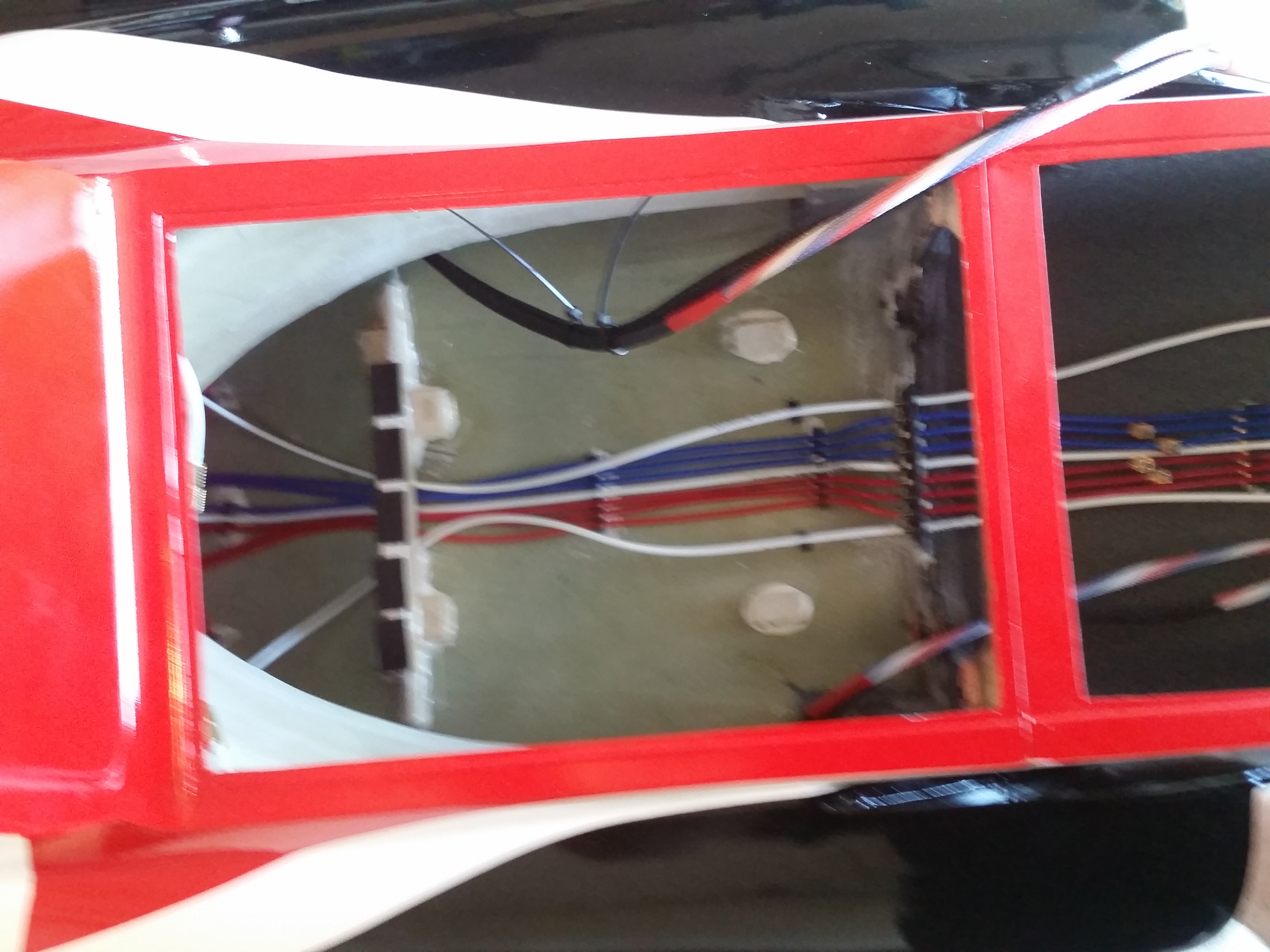

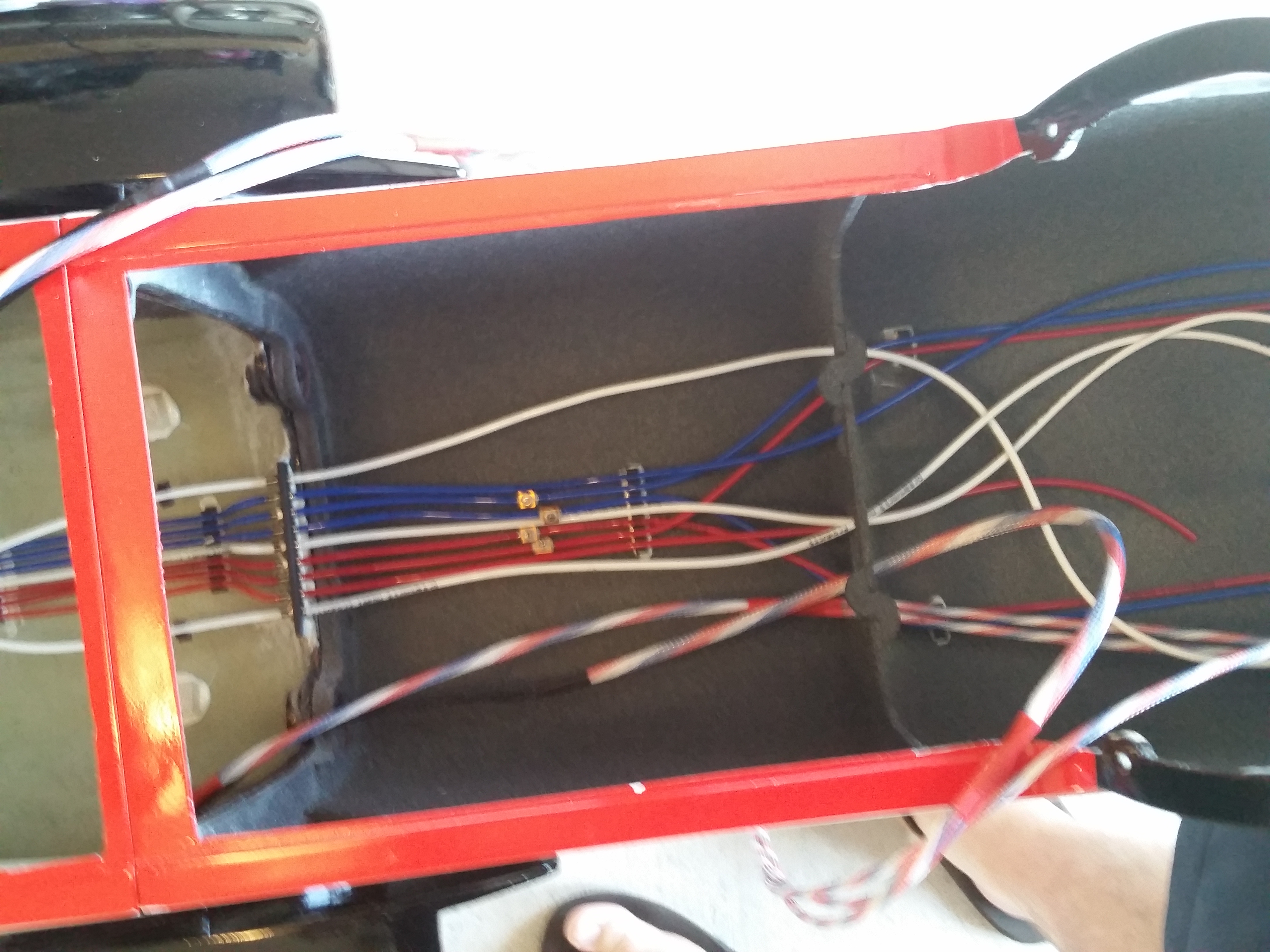

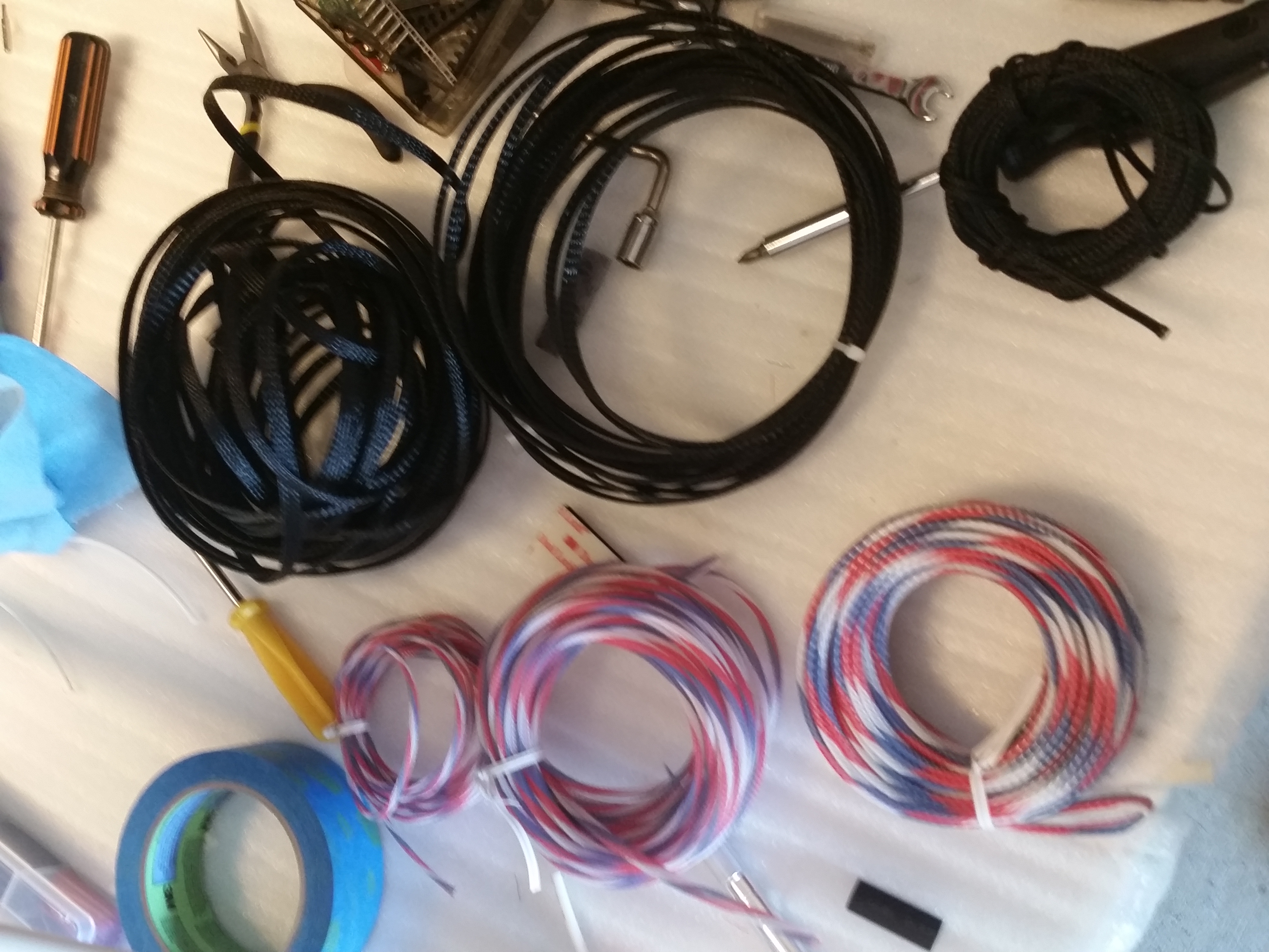

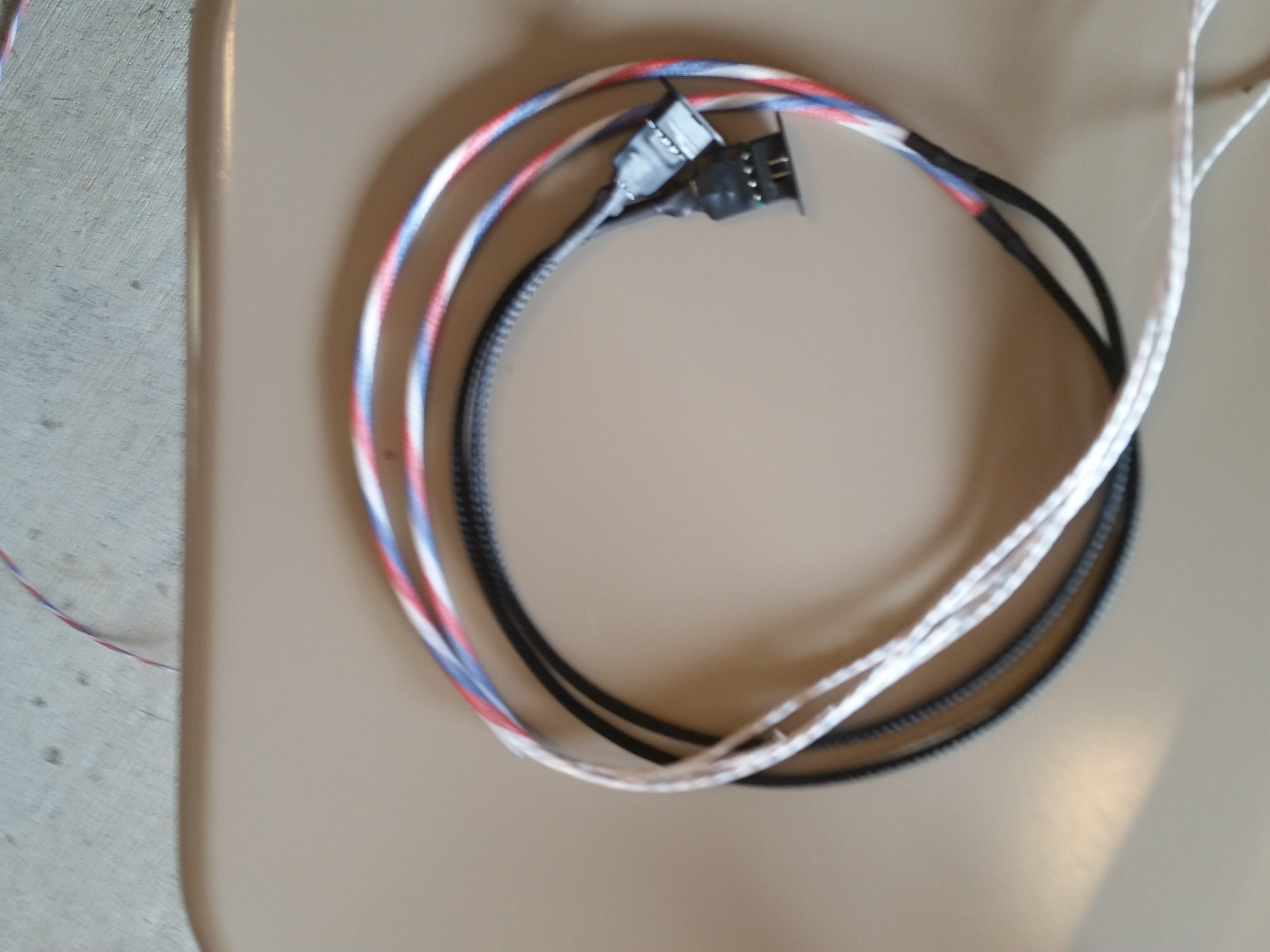

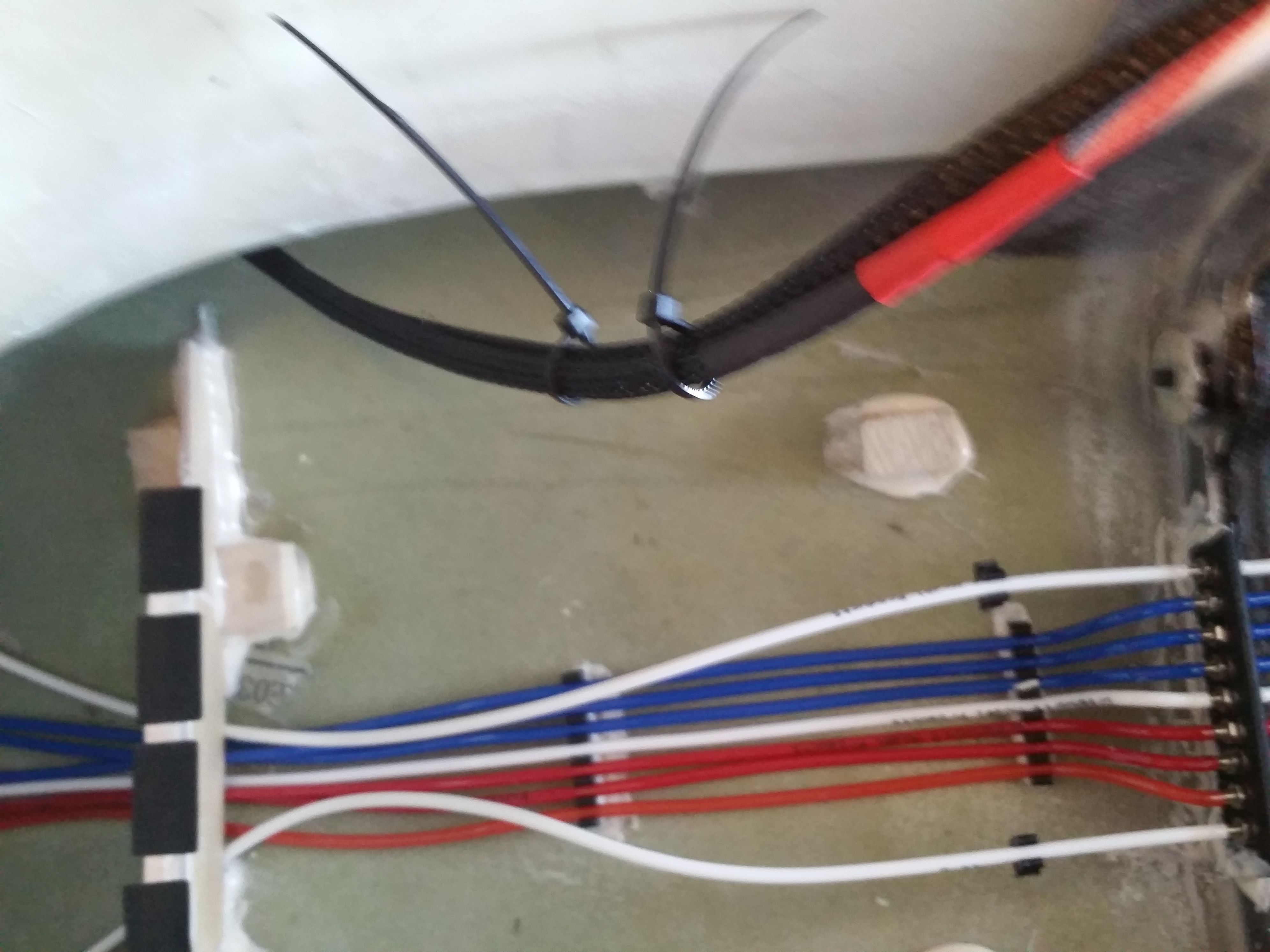

Okay so here are a few pictures of what little I have done since last pictures. I installed the turbine battery in the bottom behind the fuel tank or just on the other side of the bottom bulkhead. I have the turbine in place and centered. I also placed the Jeti Pilot tube in the font nose. It was not bad to put in. I used a small aluminum tubing that I cut to size. I tapped both the tubing and the inside of the drilled hole. I then put Hysol on the threads and screwed it in. The Pilot tube slides freely inside the tubing. If need to be replaced I can take the front will off and replace. If the aluminum needs replacing then I can unscrew it and place another in. I am waiting on xicoy cg meter so I can balance it correctly. I made a battery holder for the front but will not fix it perm. to the airframe until I get the cg meter. Keith (FenderBean), after looking at the battery packs I think I am going to go with either the duralite 2s2p lithium ion's or the 2s3p ions. with self balancing.

Old 04-04-2016 | 07:12 AM
  #75
FenderBean's Avatar
Joined: Feb 2006
Posts: 7,213
From: Huntsville AL
Looking good, I would probably move the turbine battery. In turbines if you have a failed start you have to tip the jet nose down to drain the fuel out of the front of the turbine. plus it will probably need to go forward for cg
