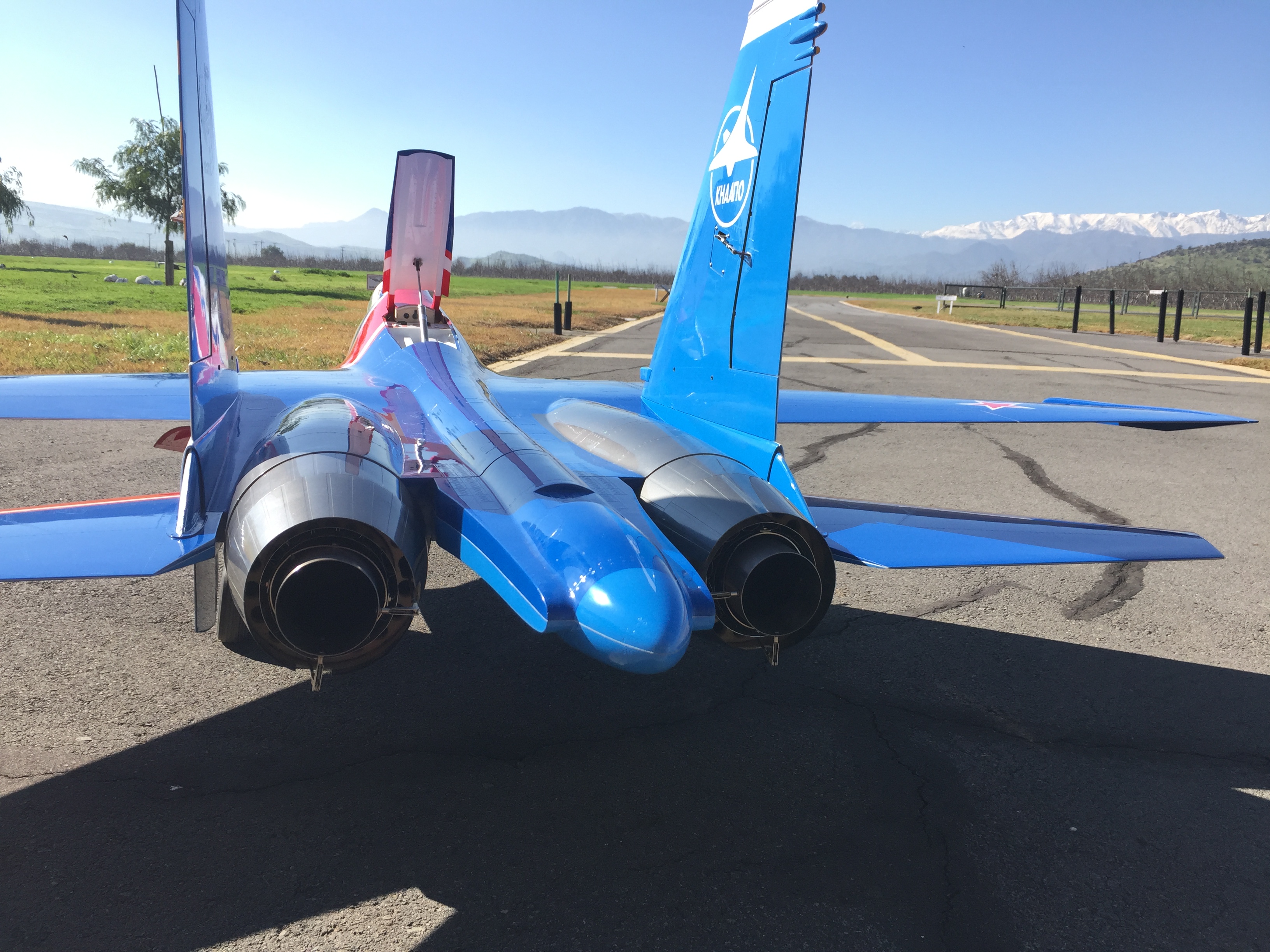

Anyone has setup them vector thrust pipes yet?
Would like to see how the tail cone covers are protected against heat...
Old 07-19-2017 | 03:43 AM
  #281
Joined: Sep 2003
Posts: 441
Received 21 Likes on 19 Posts
No protection on mine as the pipe ends after the cone...

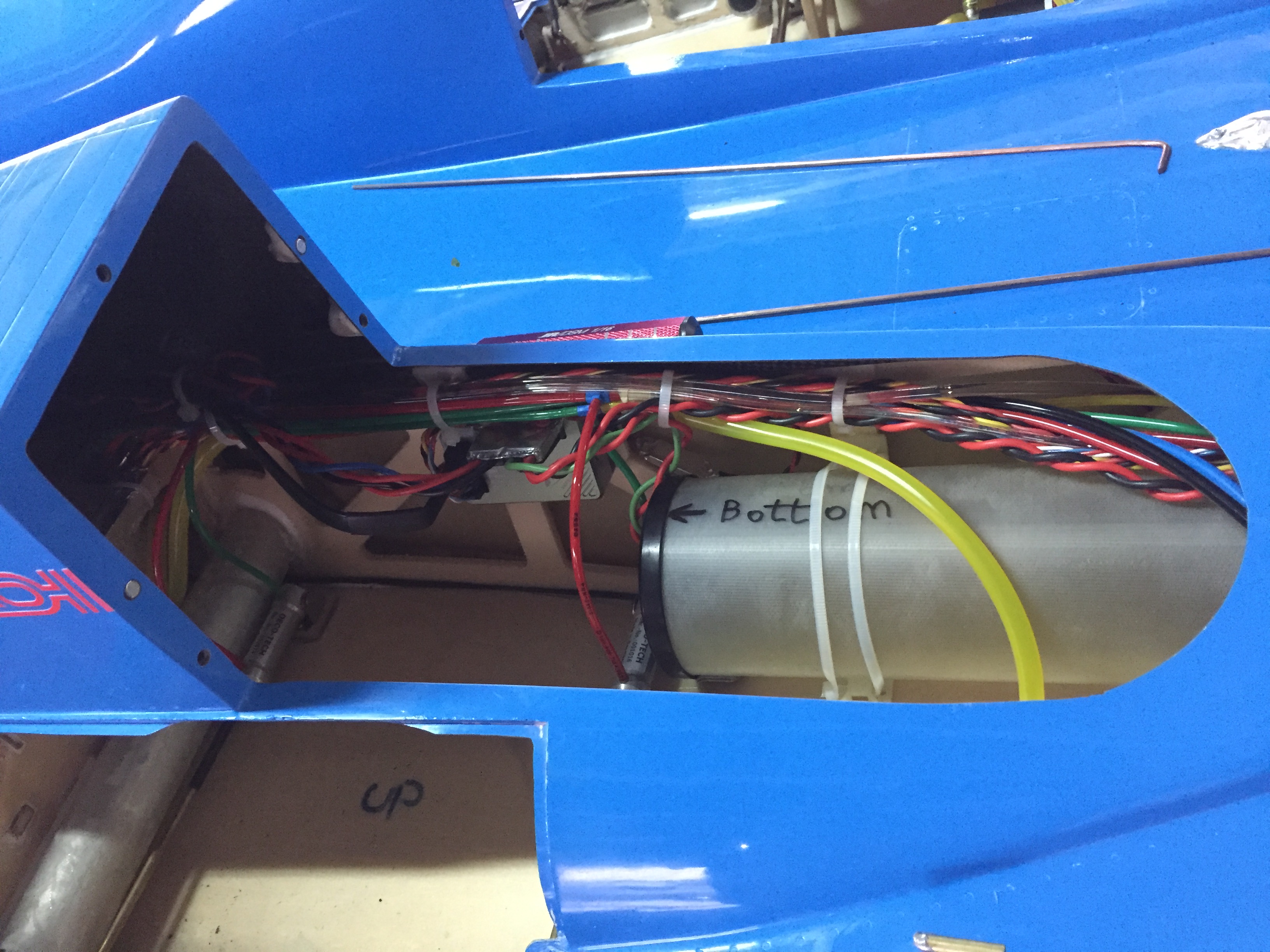

Guys who are flying this model already, do you have your service items (switches, air fill, fuel fill, fuel shutoff valves) all accessible through the nosecone or do you raise the canopy and remove parts of the cockpit between flights? With no hatches around center ship, been trying to figure out how to lay those items out without creating unnecessarily long runs for everything but there may not be any way to avoid it. As of now I'm looking at having probably 12 or more feet of fuel line per turbine when you consider going from fill port in the nose to UAT near nose gear, then back up front to a shut off valve in the nose before going back to the pump and then turbines.
I have not yet started on the cockpit - once assembled can it be easily removed to access fuel shutoff valves and such if I were to install them around the nose gear mount instead of at the nose cone?
Old 08-30-2017 | 12:38 PM
  #300
Joined: Sep 2003
Posts: 441
Here are some pictures I have of the building process and how I have what you are asking on my SU27.
I have the fuel shut off valves and fuel line under the speed brake unfortunatelly I don't have pictures of that at the moment, switches pwr box screen and air lines in the nose, the cabin is not easy to open all the time, unless you make some modification.. I have a 1/6 pilot made fromm Taylored Pilots
