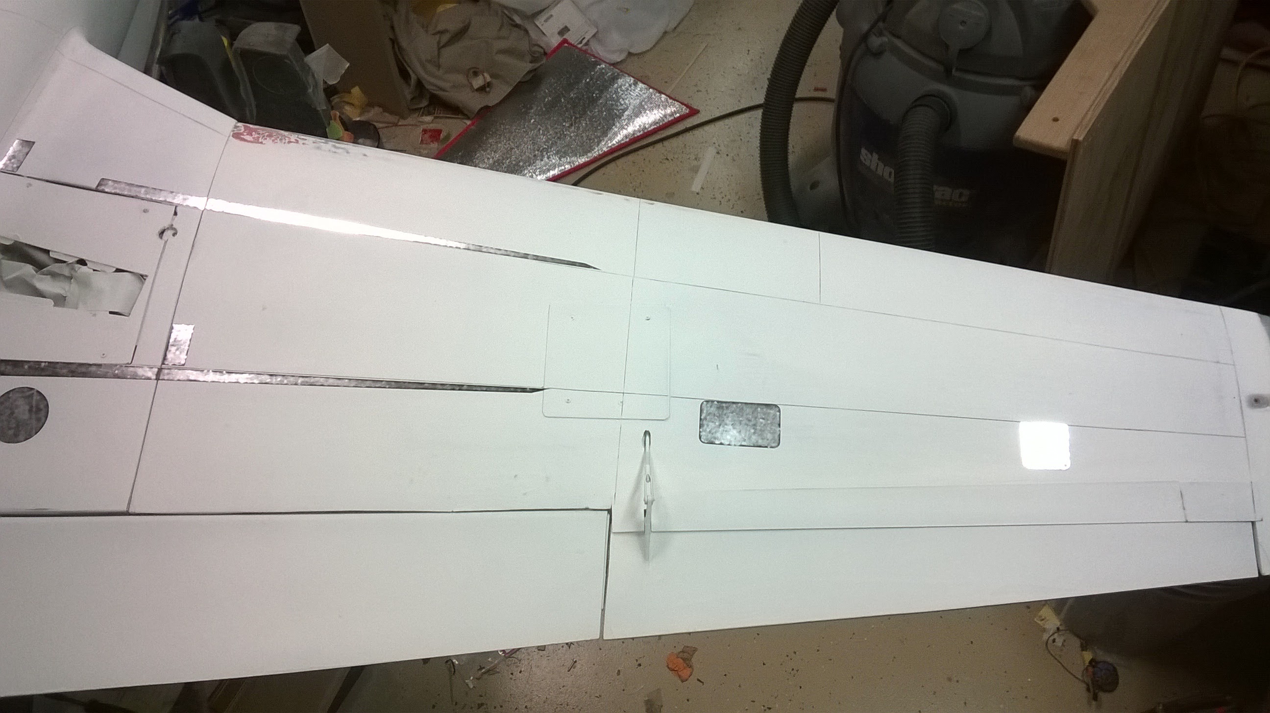

Can someone send me a picture of what the wings or fuse would look like RIGHT before you apply the base coat?? Should it be completely Covered in Primer or Sanded primer..

Old 05-11-2016 | 05:53 AM
  #37
My Feedback: (14)
Posts: 524
From: St. Mary\'s City, MD
This is what my wing looked like before color. The silver areas are stick on aluminum details from Pro Mark, the little bare area out at the tip was of no concern as it is covered by the tip tank, there is a bit of spot filler top left leading edge (red) and underlying gray primer exposed slightly. All the white is sanded 2 part klasscote primer.
Chordwise and lengthwise lines are panel lines cut into the primer.
Name:	T-33 primered wing.jpg
