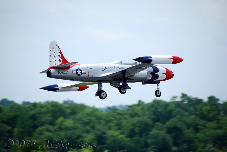

Hi, you need to move the CG back, it will land much better.

HI, I am flying with 202mm CG. It does not suddenly drop the nose.

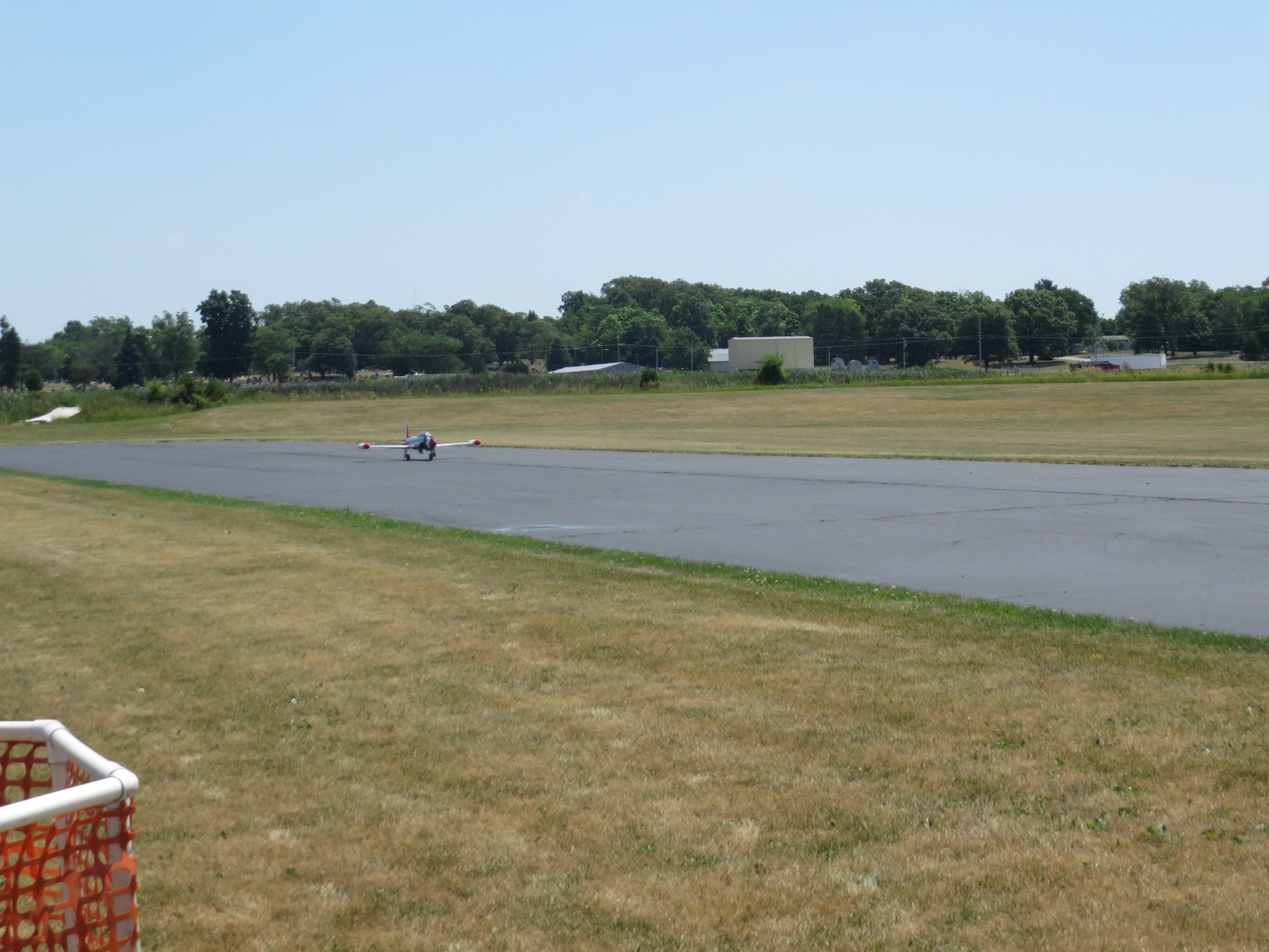

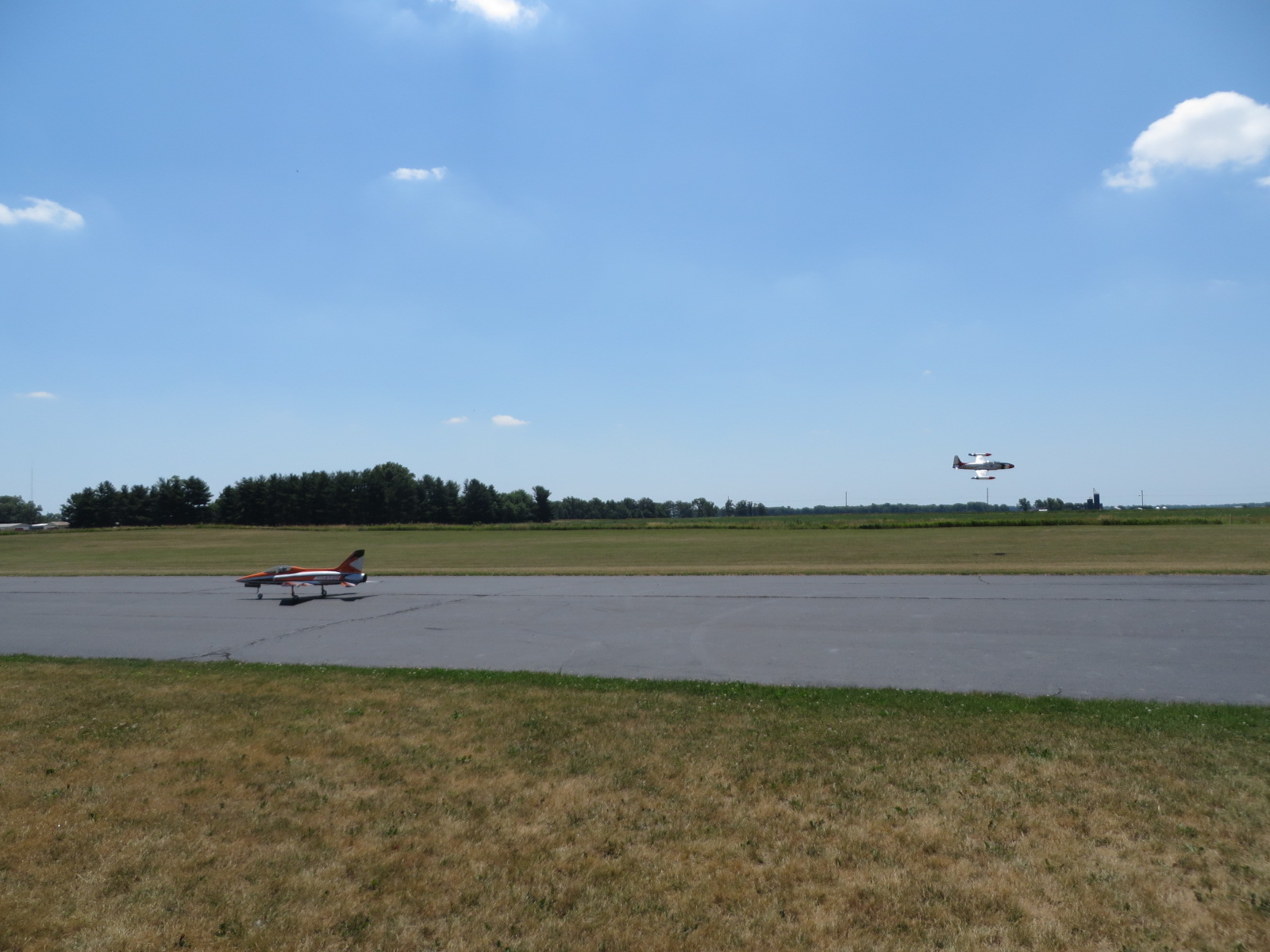

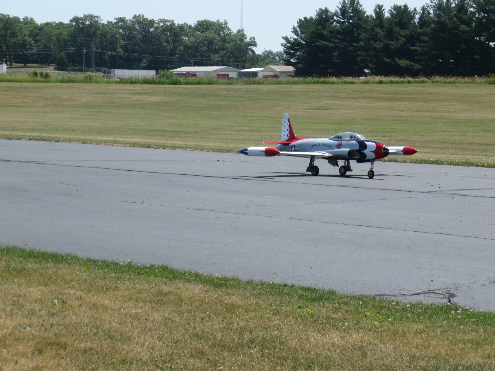

Got Ali to take a flight on my T-33, this past weekend at Winamac, perfect flight, the T-33 has presence in the air, which several people said, at 201CG. was good for scale, still slightly nose heavy,as shown by 45 degree upline and half roll on it"s back and the nose will start to drop slowly.
Rcpetehttps://www.youtube.com/watch?v=sER66CcOmeM
