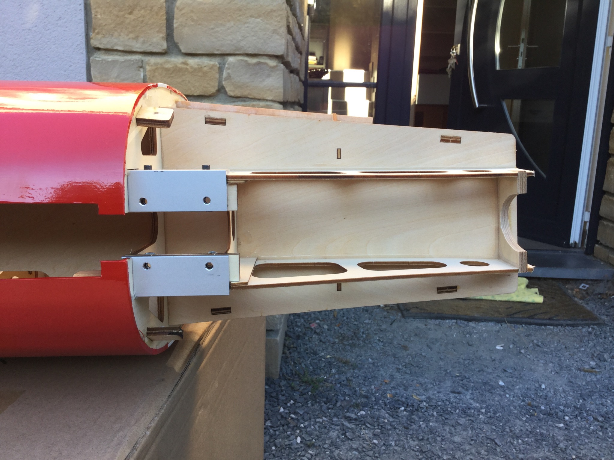

I have just started assembling mine and wondered if anyone has a photo of the underneath showing where the horns should be fitted to make sure they fix to hard points in the aileron and flap?

Old 05-12-2018 | 09:54 AM
Posts: 560
Received 20 Likes on 15 Posts
From: Guildford, UNITED KINGDOM
That’s true and a good idea.
I decided to carry on in the hope of finding a decent fixing and all worked out fine.
photo attached.

How did you find it?
Held it up to a light or very small pin pushed into surface?
I like the paint on the wheel well...nice touch
Old 05-12-2018 | 11:43 AM
Posts: 560
Thanks, I think I’ll paint the inside of the fuselage green as well.
I made up all of the supplied linkages and fitted the servos to the mounts leaving little choice of where to fit the horns. One of the screws holding the flap horn on nearest the hinge needs to be replaced with a longer one.

When doing the second wing I wasn’t as lucky and the flap was hollow where I needed to fit the horn.
To get around this I made a hole in the centre and filled the area with hysol before reassembling.

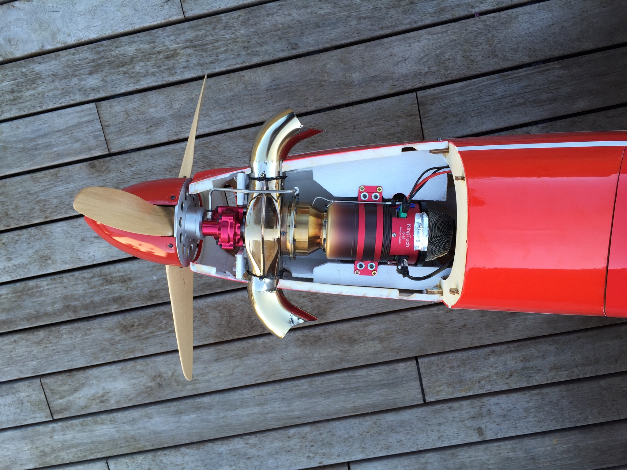

Kingtech 60 TP offered into the model and a Sebart Avanti combined kero and smoke tank placed on the CG. Now to decide whether to remove the canopy to switch on and refuel or put them on the
outside.

Cowl now cut and TP60 mounted. Painting the inside of the fuselage took a few hours but I’m pleased with the finish.

Nice job Neil - looking forward to seeing it at the field. If your OCD can't handle the exhaust angles I'm pretty sure you could fix it with a hammer

Funnily enough, the exhaust angle is bothering me, especially the way one hangs out further than the other due to the offset. Photos would be great!

Are you concerned about heat build up with the K60 vs the K45?
A lot of people paint the inside of the nose with BVM heat paint ... which is boring white, I admit.
Old 05-24-2018 | 10:18 PM
Posts: 560
I hadn’t really thought about the heat issue as the turbine itself is further back in the nose. I’ll have a think and maybe just monitor it when I first run it up.
