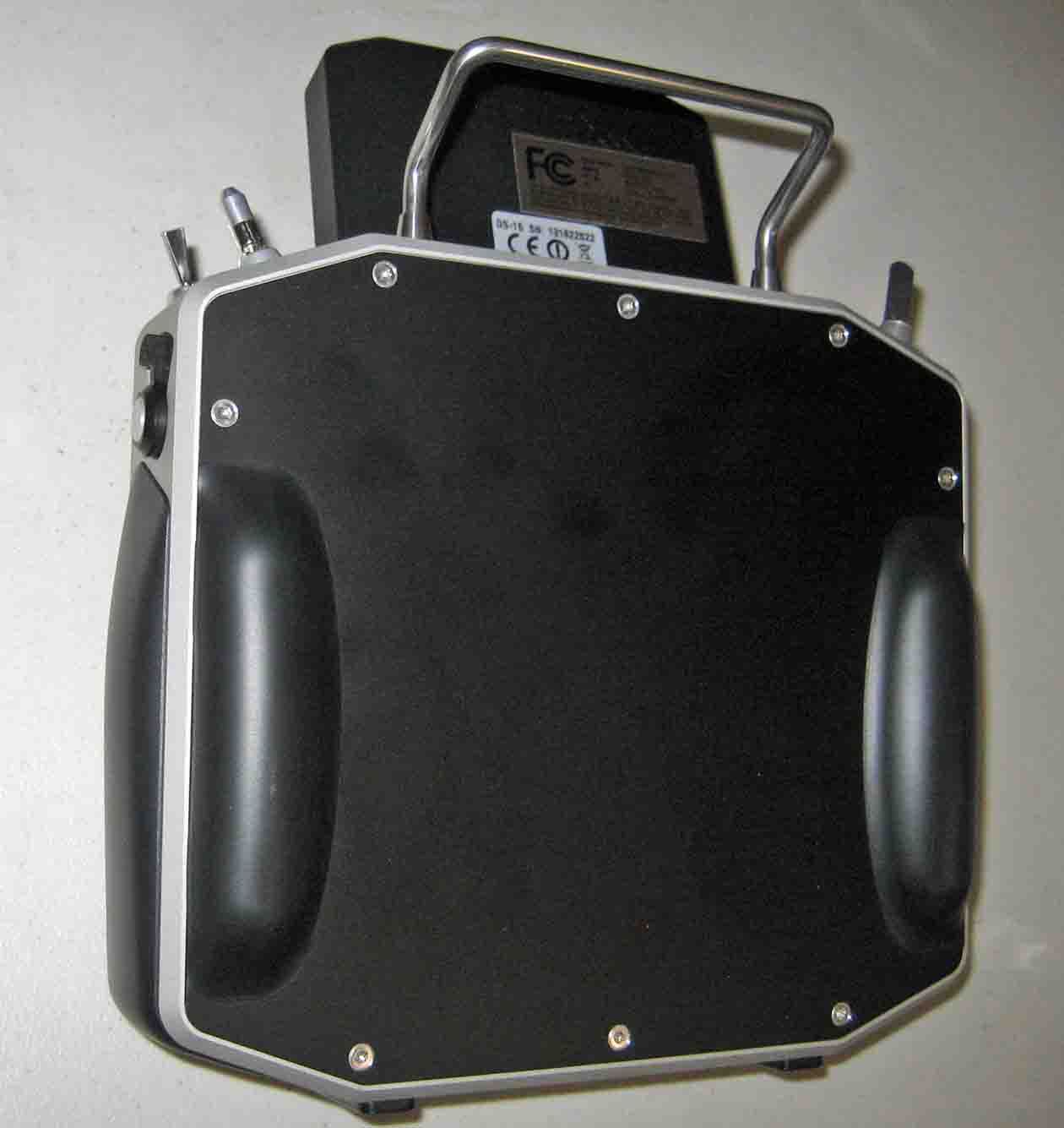

Emerich Deutsch personally assured me that PowerBox WILL redesign the BAT 60 tx to their own electronic standards ( which are of the highest quality) and all current Weatronics rxs will be compatible.
David, So very glad to hear this! I switched to Weatronic just prior to the Powerbox acquisition. Have two Bat 60, 3 Gizmo 10-22 Gyro III, and 4 Micro 12. All function perfectly, in two FM scale jets using patch antennae, as well as std painted scale and sport jets.
Has he given you any idea of timing?

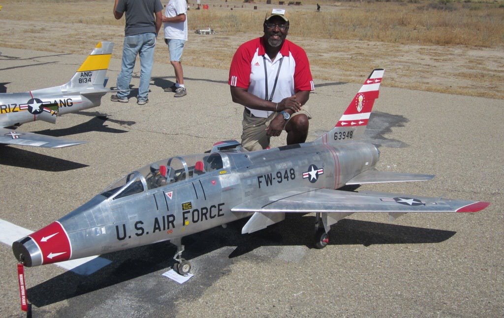

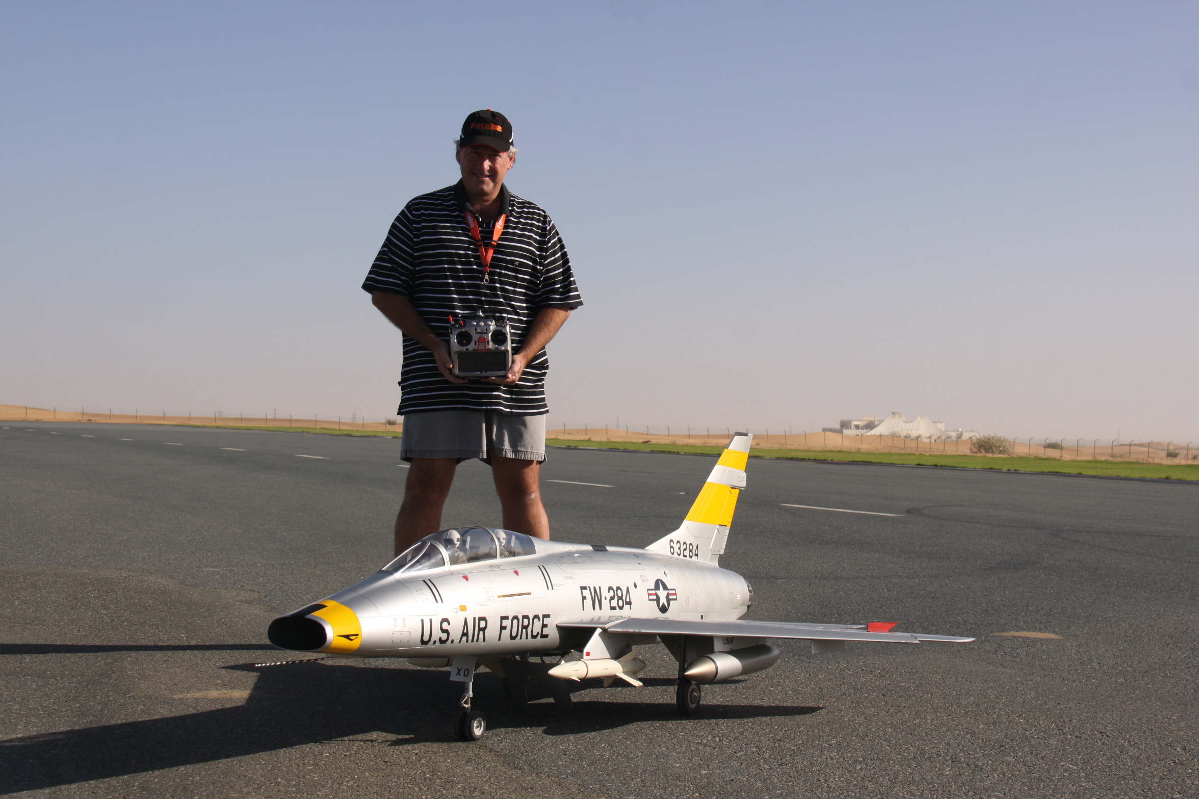

Some really nice information Gents, thank you.
Really nice looking F-100 David, mine is powered by the original JetCat P-180 (predecessor to the P-200).
I'm really looking forward to JetPower 2017 in the fall (Sept 15th to 17th), where I can catch up with old friends (David G, Dave W, Marc S), to name a few, and to also make new ones. Speaking directly to the manufacturers and vendors is also priceless IMHO, and I'm like a kid in candy shop when it comes to all the accessories.

I spoke to Emmerich Deutsch at Weaton Park last year about Weatronics, which company he had just acquired. He did not give any specifics of time or tecnicalities but said the BAT 60/ 64 will be upgraded by Powerbox with the assurance that it would compatible with current Weatronics receivers. He clearly held the Weatronics system in very high regard, as I do, but he will make the transmitter even better and make the electronics to PB standards, which are as good as they come.
It will not be rushed and will take time. As soon as I know details I will pass it on. In the meantime I continue to have great success with my Weatronics systems using JR12x transmitters and module systems,
My Bat 60 is in use but not in jets as at the moment it has no Giga Control or gyro capability, that may change after Powerbox sorts it all out.
That's all I know at the moment, but If I hear more I will post it here.
