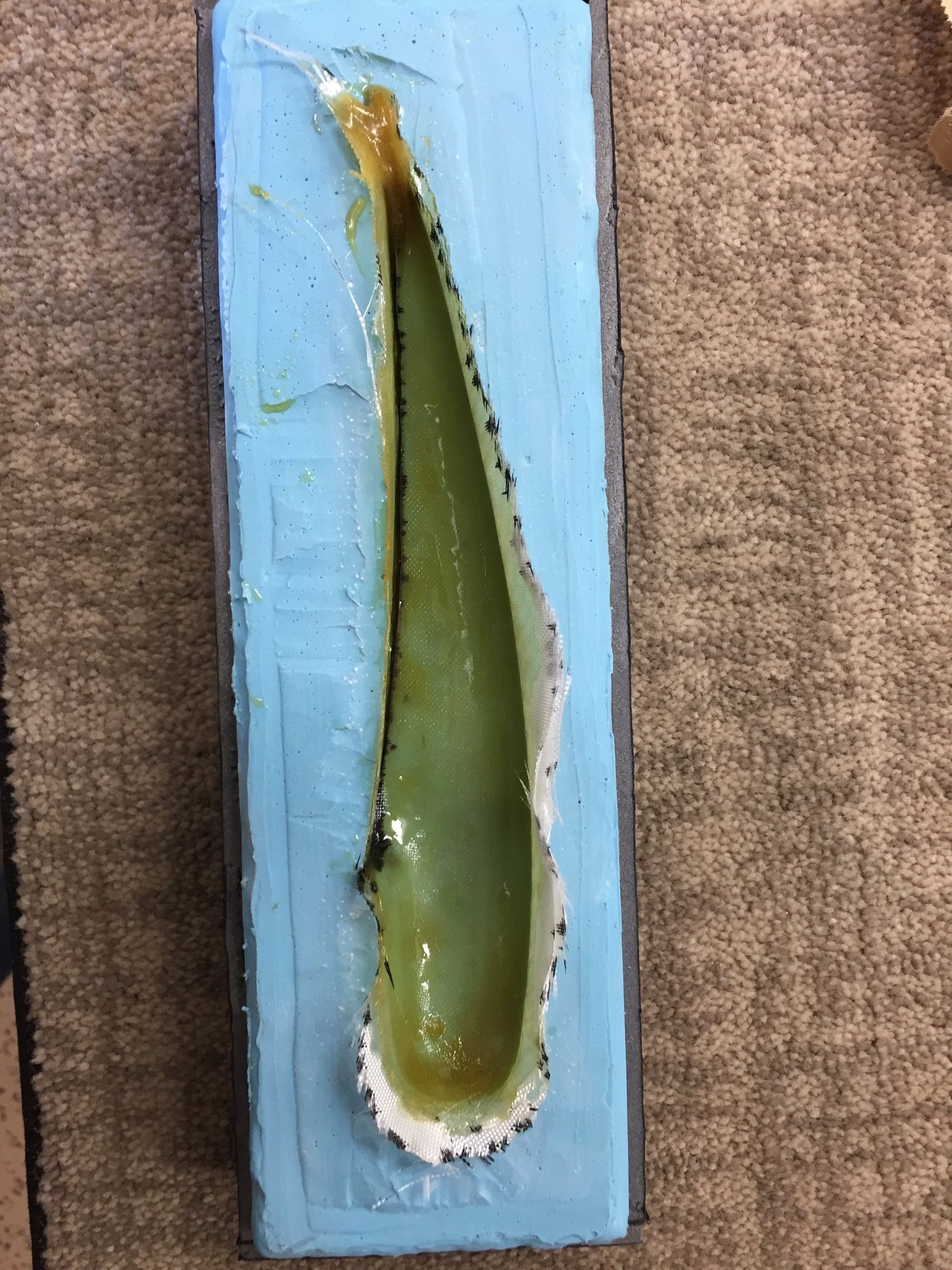

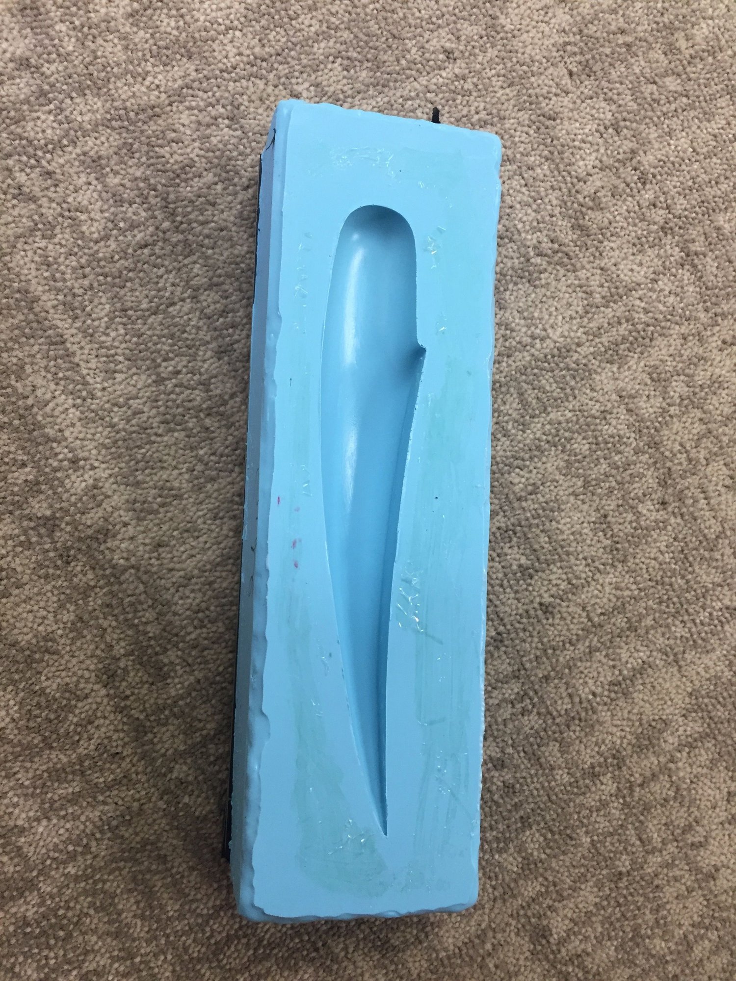

I have a Skymaster F4. I want to make a silicone mold of the EMS that hangs off the nose cone. If the nose gear doesn't lock it gets grounded down. My thinking is to use clay up to the part line and build a box around it and pour silicone over it. I would have to make a left and right mold. I was wondering if some one has had any luck doing that way. Once the mold is made I would use fiberglass in it. Would I need to use mold release for the plug and the fiberglass parts? If you have done this PM me your contact Info. Thanks Dan Avilla

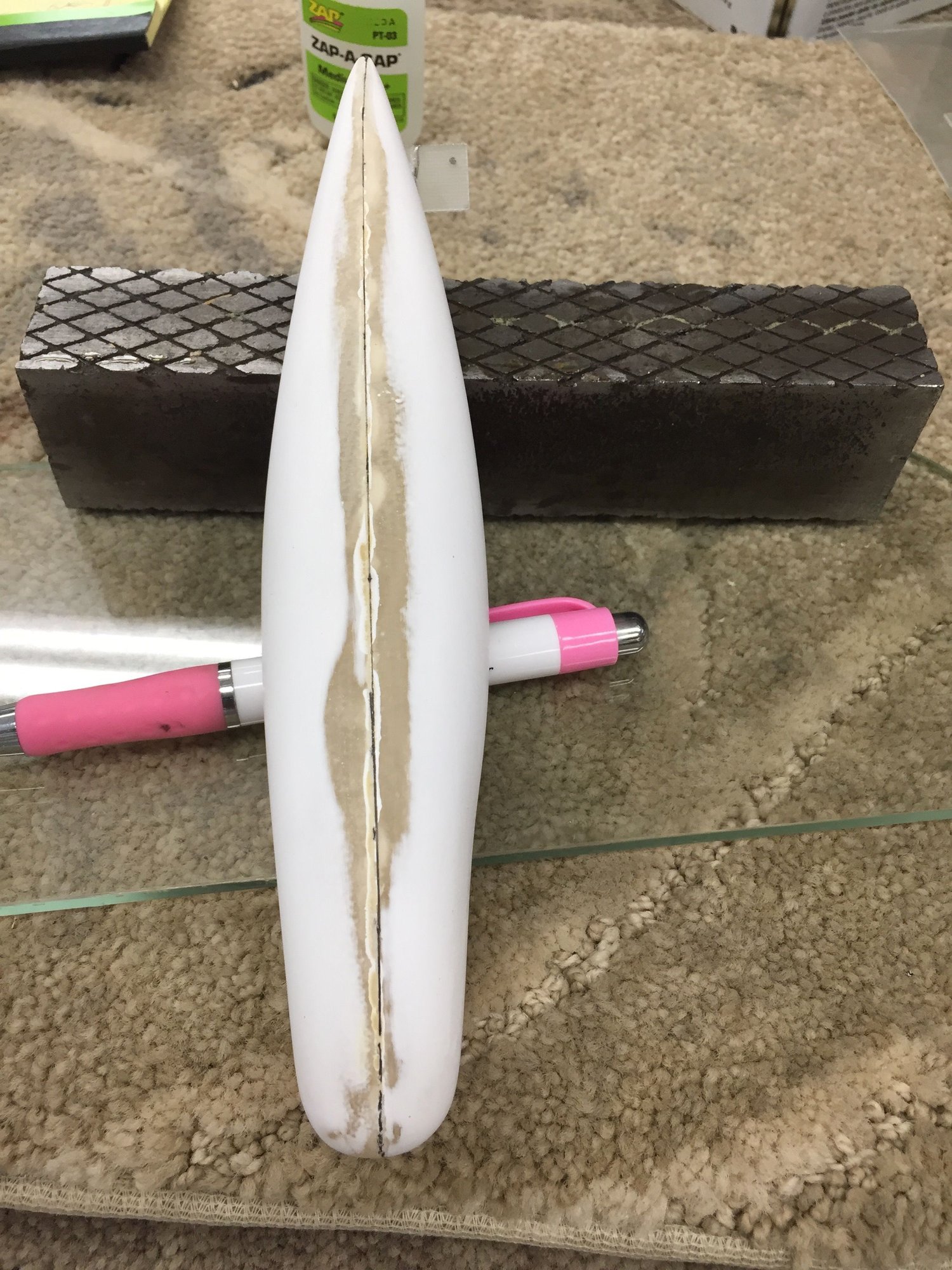

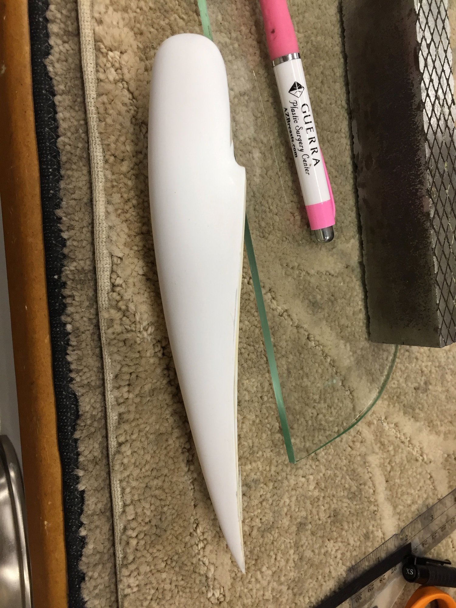

To all that responded thanks. At the time when Sid responded I all ready order the silicone. It cost me 100.00 to my door. I wish I knew about the great videos that were posted . I would have done it in glass. Im not sure the up front cost would have been cheeper but the supplies they used would have made a lot of molds in the future. The part came out good. The mistake I made was not doing my home work on the second silicone pour. It stuck to the original silicone mold. I had to cut it apart so the seam line was not as crisp. Good learning experience . Dan

Cool to see you experimenting with making molds and parts. Like others suggested, for making FG parts using a FG mold would be ideal and it’s not that difficult, just takes a few more steps than silicone and resin. However now that you have created and silicone mold you could do a test and make a resin part. I really like Smooth-on products for silicone and resins. Their website offers a lot of helpful videos but i’m Fortunate to live close to them so i can get help in person. Anyways, if you’re interested try some smooth cast 65D and use your mold and roto mold the new part. Mix the resin. Pour some in half the mold, clamp both halves together and manually rotate the mold in your hands 360 degrees round and round (basically a poor man’s roto molder) while the resin kicks off. 5-8 mins then let cure for another 5-10 mins before opening the mold. You will wind up with a complete resin part. To get a thicker wall just use a bit more resin, some experimentation may be in order, but once you get the amount to your liking you could knock out 3-4 parts in an afternoon and have some spares. Also you can tint the resin if you want (not sure what color you need your final part) but that also saves you some finishing time.
Just a thought. The fact you don’t have a clean part line isn’t a problem, in fact it helps the two halves key together better. I often use their sorta clear series of silicone to make molds and pour it around my part completely in a block then (because it’s clear) cut the mold apart to remove the plug.

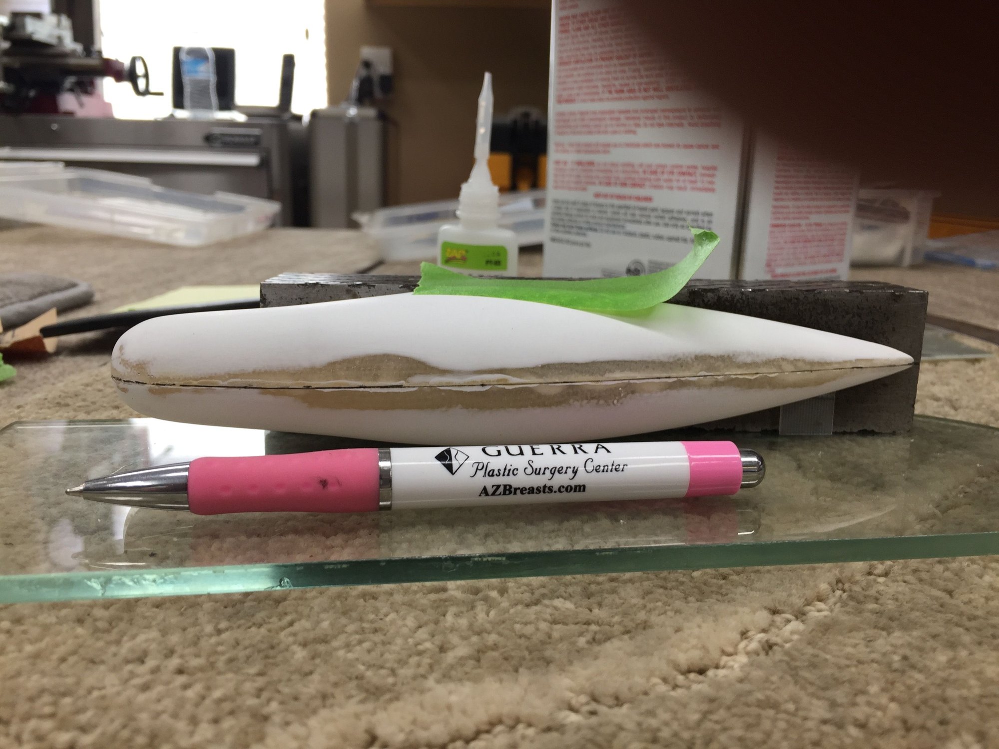

Dan- I don't know if your part is heavier than you want. It looks like there is excess resin in the layup. I have a rocket pod I made for my F-94C that is 13" long x 1 3/4" dia. Finished weight is 1 3/4oz. Lay up is first layer 3.2oz cloth, second is 5.0oz cloth and 3rd layer is 3.2oz. cloth. On my tip tanks I did 3.2oz on all three layers and they are strong enough. I am not criticizing, just saying what worked for me.

Sid it came out a 10th of a once heaver than the MFGs. I plan on doing another one with west system resin and one less layer of cloth

That is a good result, especially for first time. I used my BVM T-33 for comparison when I laid up the F-94C. I think my result was lighter and stronger.
