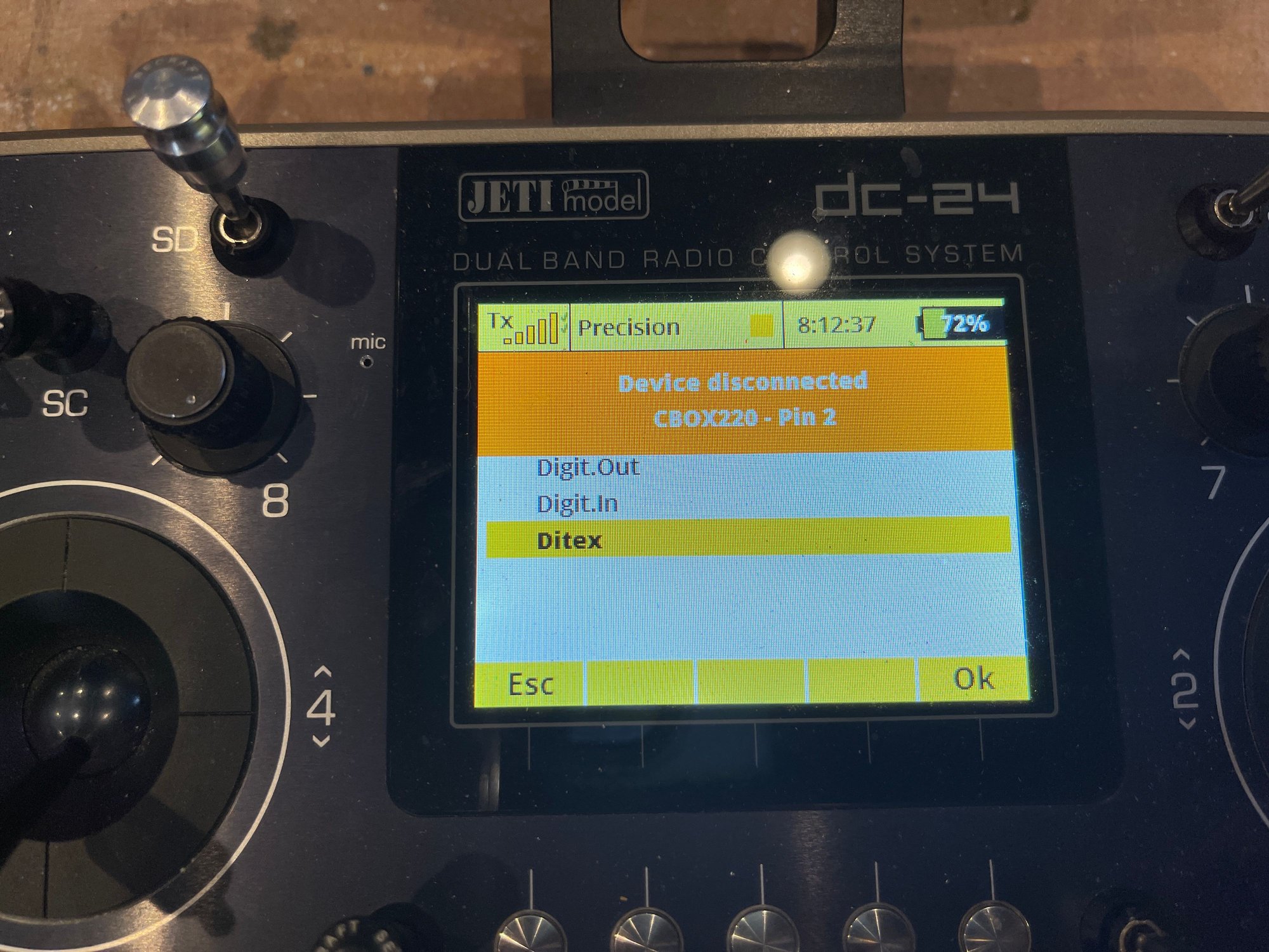

I got me the DITEX servos
Jeti Ditex TD 0806MD Coreless High Speed Mini 7.4V Digital Telemetry Servo
and they work great.
I was able to get the arms perpendicular to long axis of servo and program them there.
in my TX the servo set up has the center at ZERO for all the servos!!
that is awesome.
ok, when I went into device explorer, and went to alternate pin settings, I changed the appropriate pins from servo to DITEX, and now I can see the telemetry and I the servos function.
But, it beep with this warning?
I have already done updates on the servos, receivers, and transmitter, prior to installing them into the airplane.

It is due to the wrong default setting in an undocumented option in the pc software. Hook the servo up to a pc and using the pc software, go to the telemetry tab and change the telemetry from type 1 to type 2

thank you Harry
the problem is solved
it was due to my assignment of a pin that did not have a DITEX servo on the other end.
Done by accident.
Once I programmed each pin, one by one, and did not hear the alarm, then I knew i was good.
What is a bad servo temp?
anyone know??
