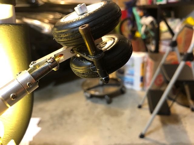

Hi All, here are pictures of the break design i did for the nose of the stinger. it works great wit one micro servo. I hope you can use it. The pull cable is from Pull Pull system. I cut the sleeve of it to 10mm pieces so it is really flexible but still works well.

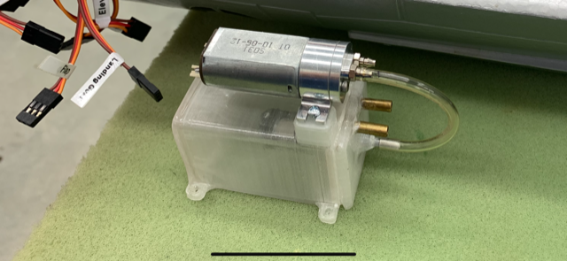

Here is the latest one I did back in March. Its the 90mm FW MIG-21. I got the already converted airframe from my friend Keith (Yellowbird911). He had been flying it on a K-45. He 3D printed the tank to sit on the CG, and installed an HAB single wall pipe. I dropped my K-45G3, Jeti REX12A, CTU, airspeed module, and JP brakes. I also used the new 3D printed air trap tank and pump mount that Keith made for me. See photo below.
It flies well but is quite exciting since I have to really focus and concentrate to see it and tell which way its pointed. I don't have the same issue with either the F-22 or the F-4. Not quite like cruising around with the big Havoc that I can see very well, but have to have a wheeled dolly to move it around!
I think its cool but it will be looking for a new home soon because I have a used FW 90mm F-16 on the shelf for my next foamie project using one of Paul's custom fiberglass tanks.
It flies good but hard for me to see and keep oriented.
3D printed air trap and K-45 pump mount with internal parts. The black part to the left is Keith's 3D printed festo ball valve mount.
Tank is 3D printed, then the tubes and filter are epoxied in the cap. Then the tank is coated inside and out with laminating epoxy, and the cap is glued on using Hysol. When cured it is leak tested under water.
Pump is mounted on top. It makes a real cool way to save limited real estate in the foamies for a combo air trap and pump mount.
