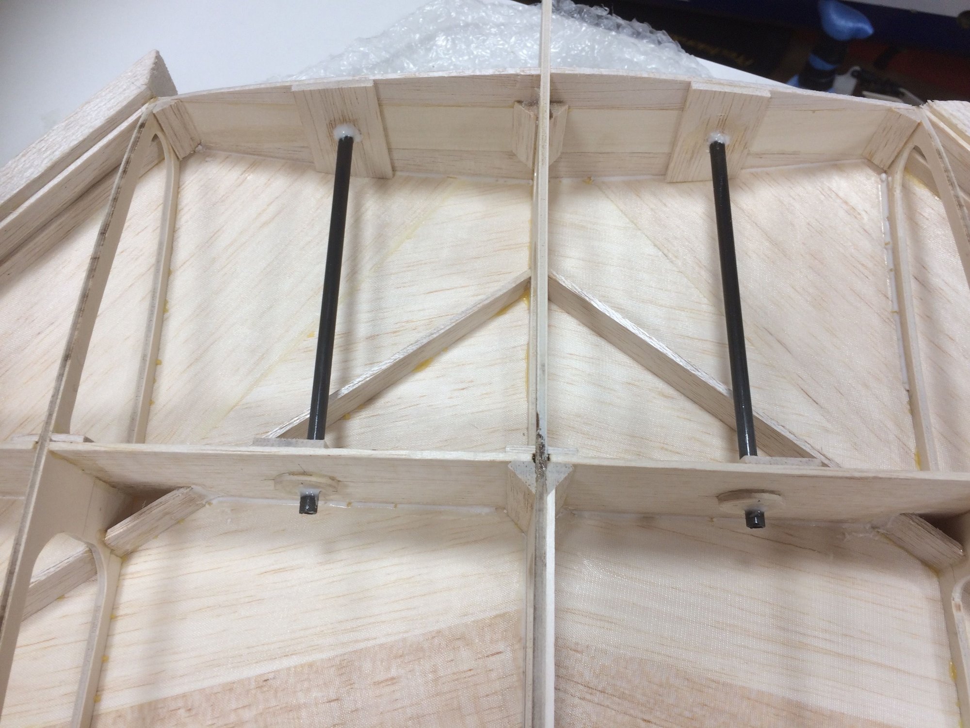

Default Wings
I decided to have a one pice wing, and I went for a symmetrical airfoil NACA 0009;
Balsa sheet 1.5mm for wing, 25gram glass both side. Once sheets join together, I glassed one side dope, this side would go inside. Followed by outside glass applying G4;
Surface hinges, for both flaps and ailerons. No horns coming out of wing and servoes would be linked to horns already installed on flaps and ailerons using their own thickness

Default Intake and air duct
Hello Guys,
As my plan is to have two turbine on back of the fuse, I have two choice to get the air to the turbines:
Option one: Not having any air duct, so from intakes air will go inside the fuselage and turbine will get the air; (too draggy for a not clean jet like F-4)
Opting two: add air duct and bring the air flow to turbines; (complex and adds weight)
I decided to make air duct, but the question was how?
After much thinking, I cut inside the formers in a way that I can create a duct air through the hols, while two side of the duct walls are balsa sheet & planking for fuselage and one side would be the wing itself. In other word, by this design, I only need to add one wall to create the duct, means adding only about 70 grams of a two pice of balsa sheet.
Please see the photos,
By running this two sheet of balsa, two main part of Fuse which have been mad before are connected now and fuse take shape :-))
