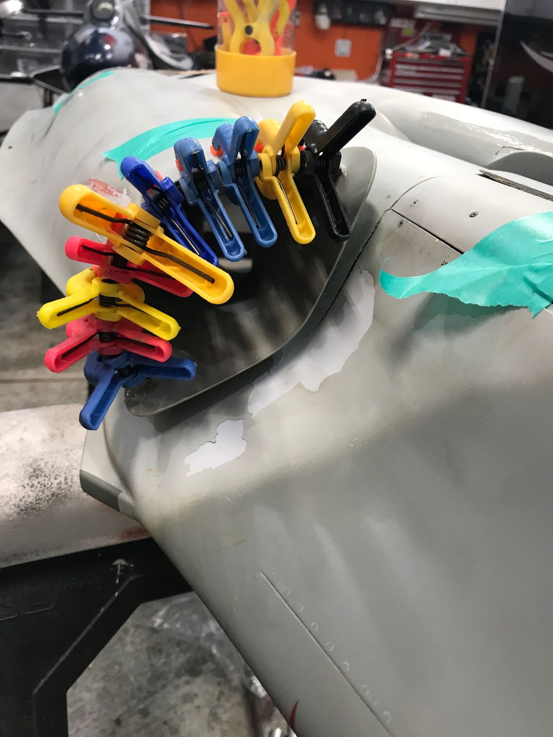

So I purchased this very unique those days Bvm rafale with some light damage and I decided to rebuild it specially for the more convenient size , so I started glued the broken areas using six10 epoxy and fiberglass cloth.

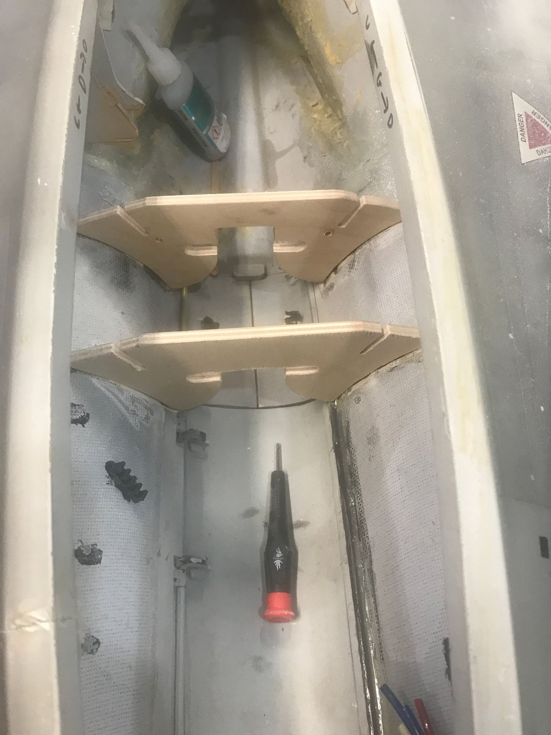

Not much today, just doing some epoxy and drawing for new formers

What's going on in this sequence of pictures? Are you using the epoxy to form a solid structure that you will then shape? I've never worked with that Six10 stuff, I presume it sands well?

The six10 it’s relatively easy to send out just like hard bondo and works structurally very strong and none brittle material

Not too much just cutting the front formers and some plan
