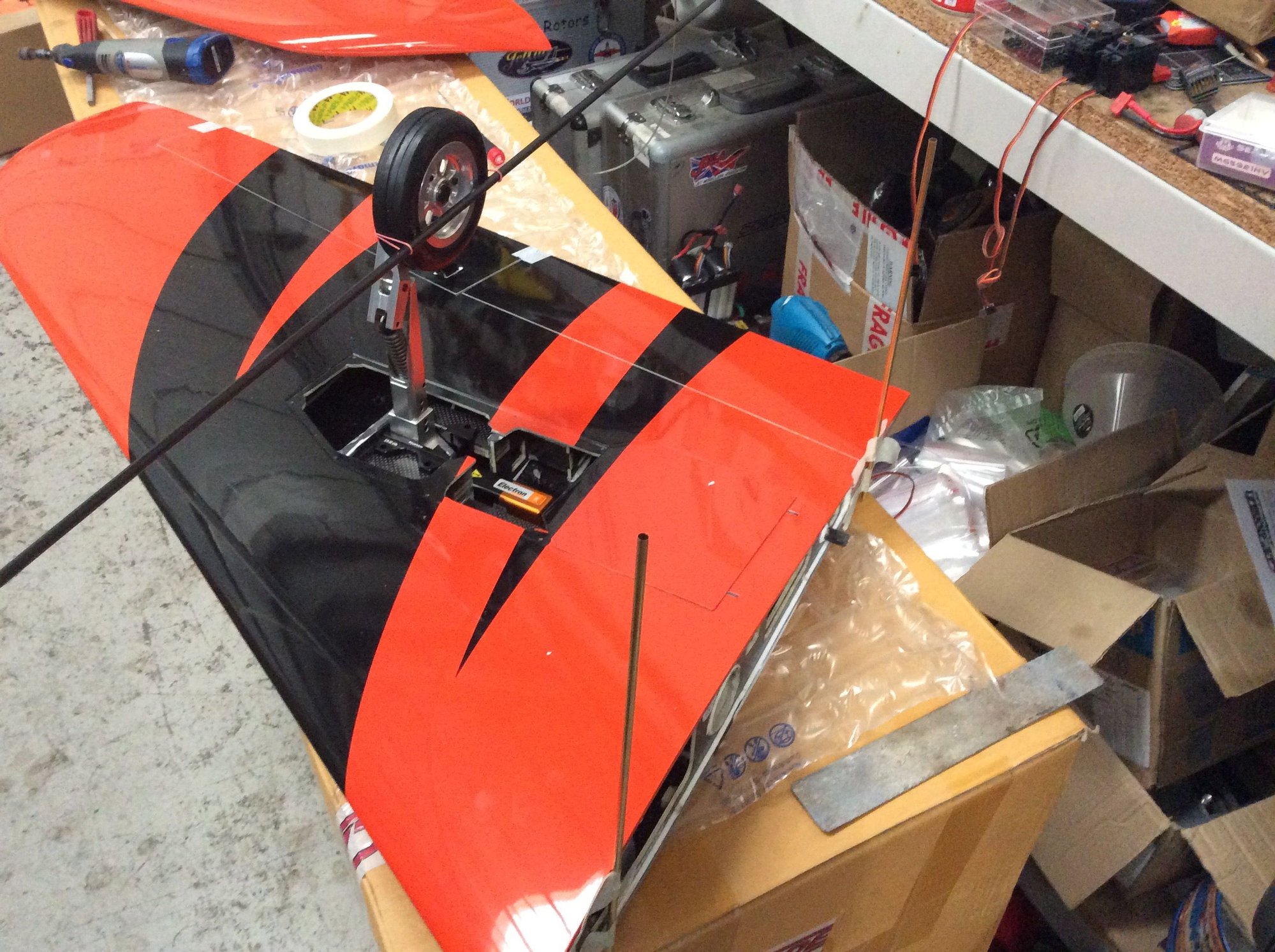

I have covered it in RCJi more than once 😉
Removable wings like this, one piece wing it’s best to put it on the fuselage and reference off each side. I use 2’ long rods and set around 3/8” wider at the rear.

Hi Dave,
This is exactly what I was looking for. I've just been eyeballing until this point. I did not have actual numbers to work off of. The 3/8" value at the rear using the 2' rod is a simple process I can easily replicate on all my planes. Thanks, Dave!

Toe out is is a complete no no! Toe in pushes down the light load/raised wheel.
Eyeballs can be good, but now airframes are generally straight measuring is better 🙂
