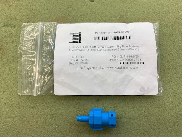

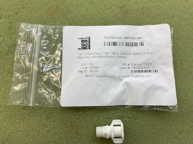

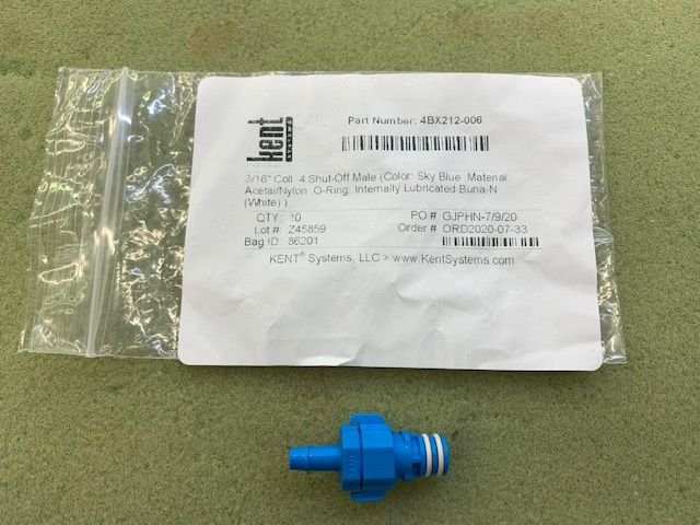

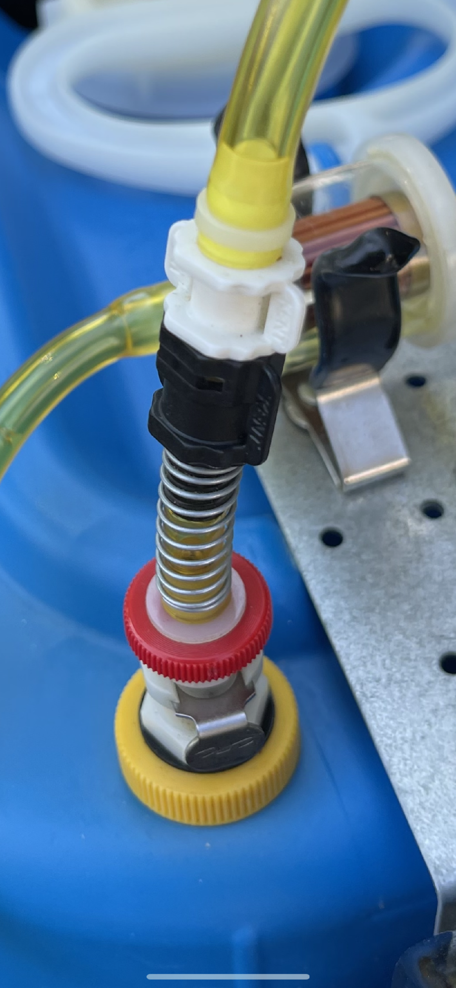

Originally Posted by jvaliensi
I noticed the connectors on my Jersey Modeler fuel system are made by Kent Systems. I wonder if they are the same family (Collection 4) that Viper recommended.
Here is the list of parts that my flying buddy Tim gave me when he told me about the Kent Systems fittings last year. I don't know if these are the exact ones Jersey Modeler uses but they are similar. Kent Systems is familiar with RC use of their fittings and was very helpful when I called them for help.
Fuel receiver fitting in jet.
Receiver fitting on vent line back into fuel jug.
Cap on fuel fitting in jet.
Fuel fill fitting on fuel line out of jug to the jet. I also use one of these fittings with the ball valve removed as a return connection for overflow back into the fuel jug.
Overflow return back to jug
Ball valve removed for return fitting

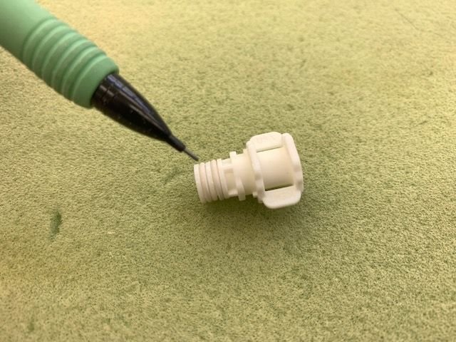

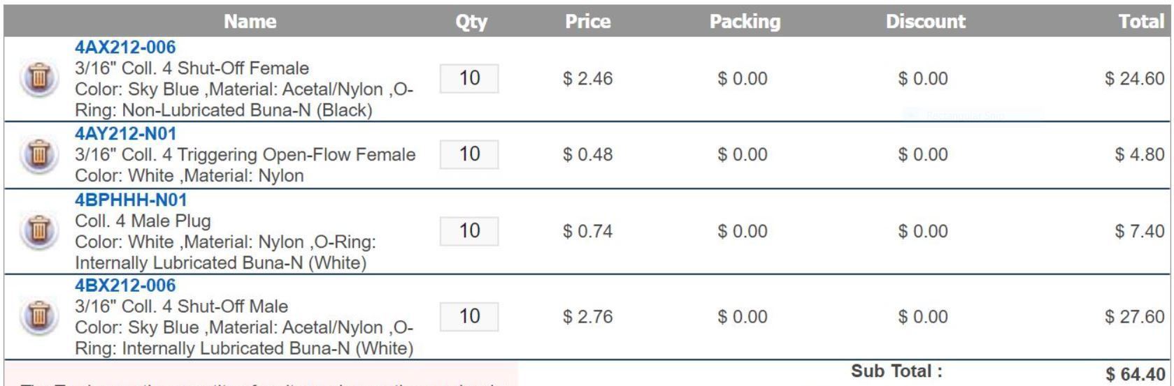

Old 08-25-2021 | 09:49 AM
Posts: 771
Received 58 Likes on 45 Posts
From: Ft.Lauderdale , FL
I got my Kent parts this morning and for Jersey Modeler cans they use the same parts. all i need to to use is 006 and NH1 part and I'm good to go, they will attach to my in fuel line inside the jet.
The white connector unscrews and fits into 006 part, the N01 is just the cap you will use. Just need to make sure its airtight which I will check later.
