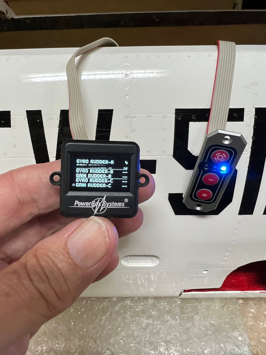

Originally Posted by rc4flying
What Channel and to what switch to you have the gyro assigned to?
Here is a pic of screen showing channel 10 as switch

I think you have a channel conflict somewhere. The manual states to use the auto setup assist, but you can manually setup through the input and output function manually. The gyro switch should be assigned its own channel not assigned to any other function.

That pic is the gain channel and not the gyro on/off function. in my opinion

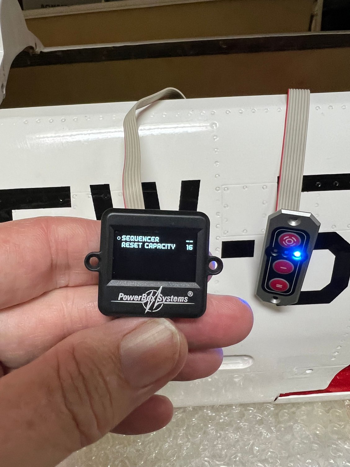

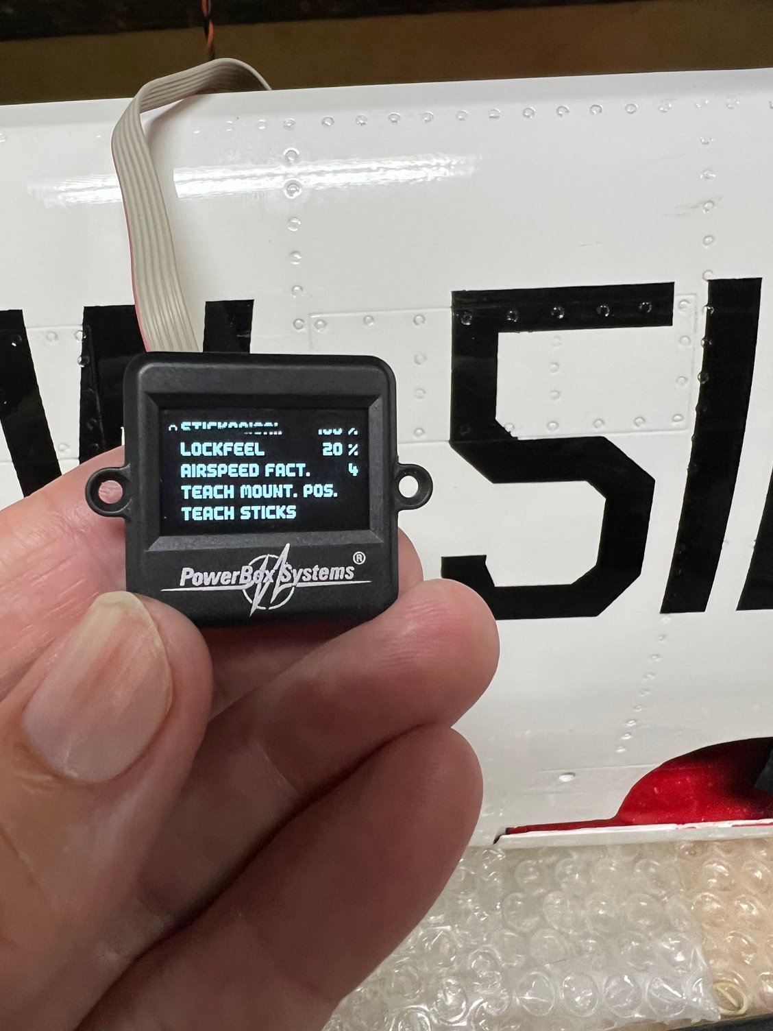

Originally Posted by Dave Wilshere
Scroll down through Aileron, Elevator and Rudder. Then there is the control channels
Here is what screens say on SR2

so if channel 10 is set in Input mapping to control the gyro and each axis in the iGyro Ail/Ele/Rud that should be it.

If channel 10 is your transmitter's Gyro control channel, you have to program channel 10 into each PBox's Gyro surface. The pics show that has NOT been done. (i.e. Gyro Rudder A is programmed to 4 and the rest of the PBox surfaces are NOT programmed to any channel.) In the PBox, select each Gyro Surface and program it to 10. If you are not using Rudder B, then that one can be left blank. I assume you are not using any Y harnesses.
The setup program A.K.A. "assistant" does not take care of gyro settings. The assistant will give you a general idea about what the crappy manual is talking about. But it does not do the entire trick. I gave up on that "assistant" about 7 or 8 Pboxes ago. I do all of any PBox's programming manually. Then I know what I have.
But, the first thing I do is set up a channel input and output map in a spreadsheet. Then I go into the PBox and set up the inputs and outputs manually. Once I have all the control surfaces working correctly, I set program the Gyro. The Gyro has to be programmed manually anyway. Also, the direction of the Gyro correction often has to be reversed (e.g. at least one elevator, etc.) You cannot depend on the "Assistant."
