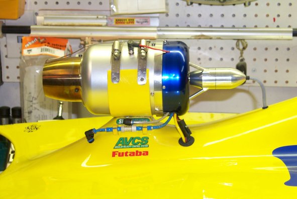

Hi,
I'm putting a RAM 500 on my Roo and would like to know if anyone has this set up. Is there a mount available and are there any mods that I need to make? Also what size fuel tank?
THANKS
Luke

Making a mount for this setup is quite simple. What I did twice was take 1/32 ply cut into 5 or six same size rectangles. Wide enough and long enough to make a good cradle for the engine.
Then I took 30 min and double sided smooth the epoxzy on and put all pieces to gether with the outsides dry.
THen take wax paper and put it between your engine and the ply and roll the mount around the engine.
Use a 4" metal tightening strap and tighten the cradle to the engine (don't risk tearing the wax paper between the two, be carefull).
Let it sit for 6 hours outside or overnight whatever.
Next day, rough up the roo mount area they provide with 80 grit. Get it good and rough.
Clean it up a little with methanol or equal. Dry. Place aeropoxy all over the area.
Put your mount and engine on the aeropoxy. Mount does not need to be with metal strap at this point. You need to be worried about lining everythingup perfect at this point.
Stick a popscicle stick between the new mount and the ROO into the aeropoxy about 1/2" an inch on the back side to raise the back of the engine a little. Let the stick cure with your new mount all day or night long. Do not touch anything for 12 hours or so. If you do, you could totally get that thing unalighned and you'll have to start over.
Good Luck,
Sean

A couple of layers of 8oz glass around a can the appropriate size works just as well. Line the inside of the mount with 1/16 ply and use hose clamps to strap the engine in place.

call the Jetcat people they have a mount for their P-80 which works great for my RAM~750

Very nice combination.
Attached is a picture of my mount, currently with a PST J600 installed. It was built and originally used with a RAM 500. I wrapped a few layers of wax paper around the Ram 500 and then laid layers of 6 ounce glass half way around until I got the thickness I wanted. I finished with one layer of carbon. The Carbon looks great, but not really needed. The thickness ended up to be 3/32. After it dried, I cut it to final size. It is screwed to the Roo mount surface with four sunk 4-40 screws. If you don't plan on changing it, you could also glue it along with the screws. Don't forget to put about a 1/16" shim between the mount and engine at rear of the engine.
I use a 50 ounce water bottle and a 16 ounce tank next to it. If you really want to use kevlar, I believe Garry Mueller makes a 68 (somewhere around there) ounce tank. I used the 100 when I had a Roo with a Ram 1000, but think that is overkill and just additional weight for the 500.
BTW, the P80/750 mount would be way too big.

Hi Luke, FTE located in Florida can supply you with exactly the correct size 500 mount you are looking for. Heres the website url - http://www.franktiano.com and phone# 863 607 6611. The T-500 mount used in my MB339 (see pic) will work great on the Roo, Just drill mounting holes into base of clamp and screw to the molded in Roo mount.
