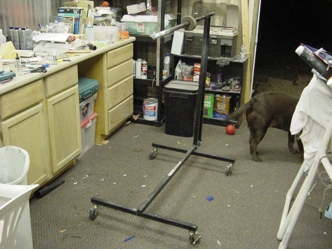

What do you guys use for a paint stand for the fuse, and more importantly, what do you use when spraying small pieces (like flaps etc) so you can paint the whole piece in one go??
Tim.

I use Robart hinge points for all my flying surfaces. I drill the Hinge point holes then take a piece of welding rod of the correct dia, bend a loop in it. ( A coat hanger will do)Then I push one end in a hinge hole at one end of the "Flap/ Aileron/ rudder" and the other end of the wire in a hole at the opposite end of the surface. Be sure to have some tension on the "Spring" in the wire. Makes a nice handle to hold the part with while spraying and also adjusting the angle of the part so you can see the shine (or lack off).[8D]

I built several of those stands and have also built several additional fixtures for mine for holding wings etc... I had not thought about the casters but will add some to mine now.

I put casters on mine when I got it a few years back. I want to add a tray to hold my paint gun on the back as well.

Off to Home Depot to get casters for my jet stand (Robertsons). Going to start painting King Cat tomorrow. Figured a way to get fuse on the stand.

I did not use the stand at all when I painted the Kingcat. I hung it with a piece of 3/4" conduit shoved through the forward wing tube. If I would have had time I would have built a fixture to hold the fuse then bolted it to one of my short pipes that mount in the stand. FWIW a piece of 3/4" galvanized rigid conduit (or sch 40 black pipe) fits perfectly through the top.
