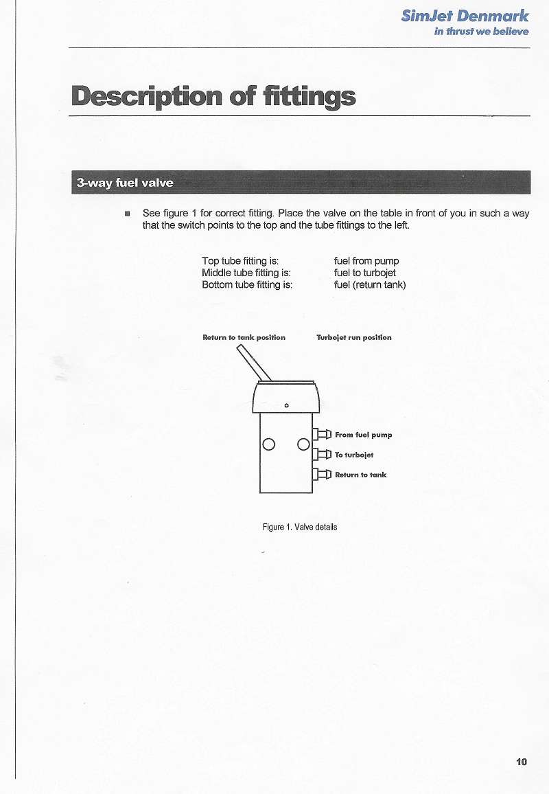

This is what I use as a manual/servo controlled bypass valve in all my airplanes. It is what Simjet recommended for use in the old pre-electonic fuel valve systems.
Chris

Cairoman, I'd love to get some of those valves. Do you know of a source? Thanks.

Hi Mark,
It's a Festo three-way valve, Type:33003 KH/O-3-PK-3 for 0-115 psi. I bought a bundle of those, four years ago in Toronto from Festo Canada.
Chris

Chris that is brilliant, Just what I was looking for as well.

Hi John,
Glad, I could contribute with something here. Please note that these valves do not last too long. I change mine once a year. The good thing about those, is that they will not put stress on the pump, just by-pass the fuel supply.
Chris

Why don't they last long? What craps out? Thanks.

The rubber stoppers inside them become hard after prolonged exposure to our fuels (turbine oil).
