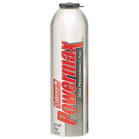

I've got a question for all you guys out there and want some feed back on this. If someone were to build a truly "REGULATED" propane control valve that screws onto the propane throwaway canisters and deliver a constant pressure "ALL" the time. Would you guys buy'em or not? The setup would deliver the same pressure the second the valve is opened as it would after continual use. This would not be a Needle Valve setup that would give a punch of pressure when first opened - then settle down to a desired pressure after flow has commenced. Thanks for the feedback.

Old 06-11-2002 | 10:39 PM
Posts: 235
From: Leetonia, OH
Default This isn't in reference to the Powermax
This is in reference to the straight propane ie: Bernzomatic propane, and yes, the Coleman propane - not the Powermax cartridges which are a different setup completely.

You are right WM: Your needle valve is acting a bit like a regulator. 100% propane sits about twice the pressure of the mix. Propane's 200+ psi might starting popping lines. Im more interested in regulation for use with smoke and such but see no reason why it could not be used to start any turbine if it is controlled a bit. Even with the JC you fill the start tank up full and usually get a pop when starting.
