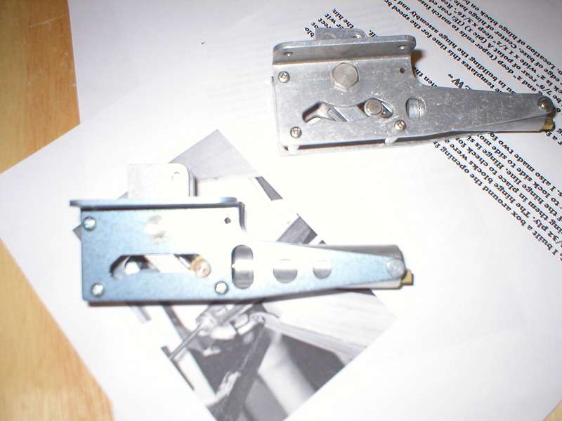

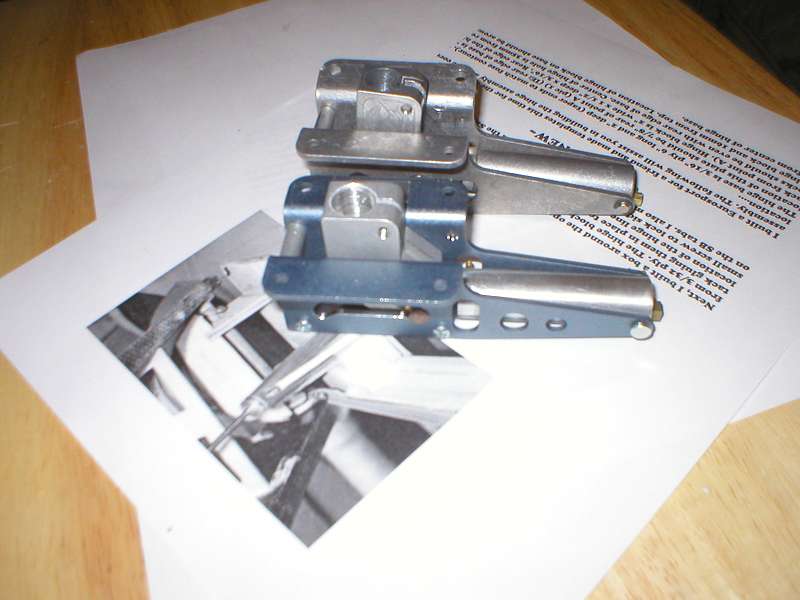

Well, here is some pictures of Robart gear sitting next to MM gear. There are several ways to tell. I made my presumption based on the missing holes near the end of the cylinder (at least I couldn't see them in his pictures). Upon inspection of what I've got here, it's possible that you just simply can't see the holes in his picture as it's not detailed enough. One thing that does support that he has Robart gear is the hole near the sidewall that you can see. That does seem to match up with my attached pictures of Robart.

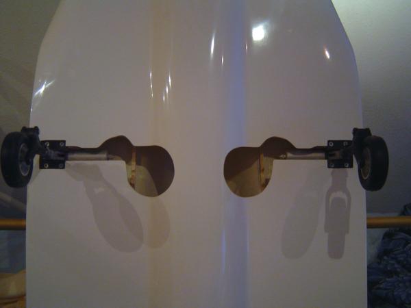

Hi Sean, to be truly honest, I didn't think that the main issue here is if my gear is Robart or M&M's, but , setting this aside, our real problem about the landing gear are legs that bend like they where built of butter. As you saw already, I put the rubber strips that worked so far, but I think that this is not the best solution. I think that the knee-action type of landing gear would be the best technical solution. We are trying to find here a machinist pacient enough to do for us something like this,

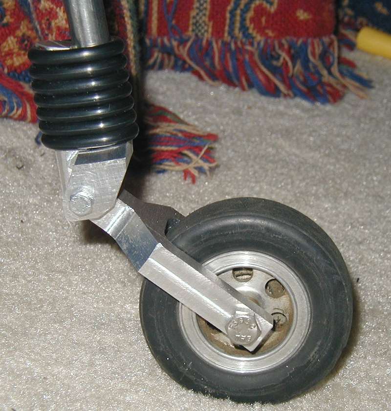

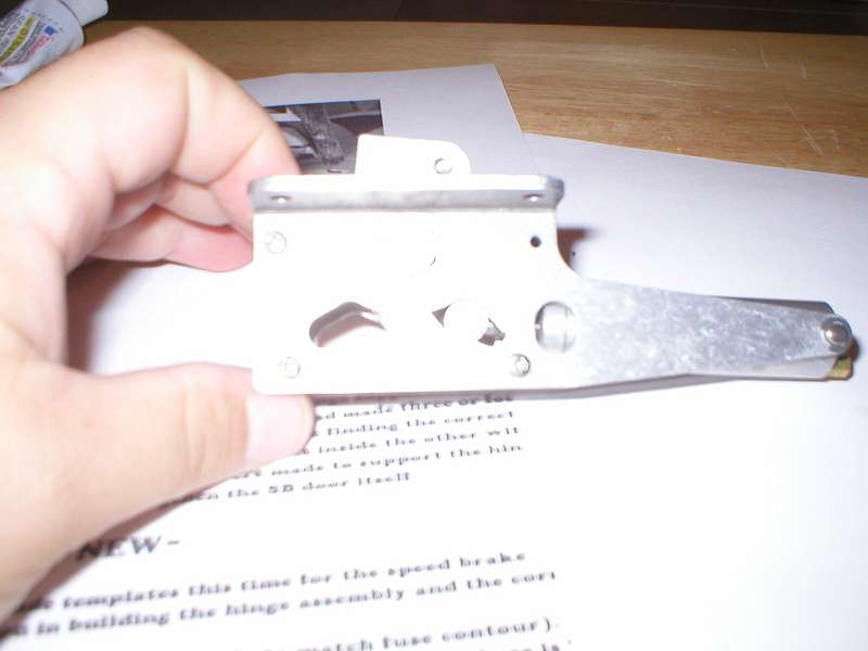

I designed, built and tested (on an Isobar) some gear that do what you want. See the photo below. It has knee action and you can vary the stiffness by adding or deleting O-rings.

Nice! how did it worked??? are you currently using it?
Old 08-14-2004 | 10:44 PM
  #35
Posts: 5,437
Received 8 Likes on 6 Posts
From: Slidell, LA LA
Default RE: Modified Hotspot
It worked very well. I built it to use on my Boomerang that I still have yet to complete. I tested it on the Isobar for a few flights with the gear down. The Isobar was not designed to work with this gear so the retract openings are wrong for it and I could not retract the gear. I just need more time.

My idea about the variable stiffness is to be used by me this way: Depending on the weight of th plane I will add O-rings until I can not see the strut flexing under normal taxiing. The idea being that normally, the strut stays closed and only absorbs shock during higher loads like a rough landing.

Yes, that's why I liked it, you can easily fine tune the stiffness depending on the plane's weight
without chaging coils, etc.

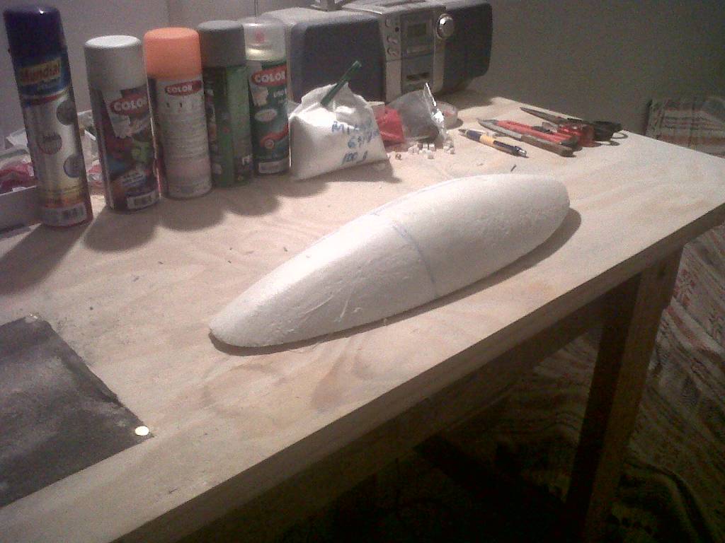

Well, after some years another one is getting ready... It was left unfinished for a good year or two, because some parts where missing, like the canopy.. found somewhere a interesting article on making fiberglass parts with foam and brown tape, and it worked well. Also the local graphics guy had a new machine with improved resolution and all this led to finishing this one and probably selected as the weapon of choice for 2010:

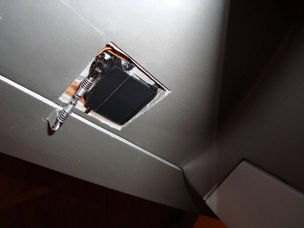

A problem that I just found in the project. in this version I select a naca 0008 airfoil for the elevator, instead of the 0009 I used on the first one, and the servo now didn´t fit.. it is likely that I will need to make a aluminum cover with some kind of bump. oh well...

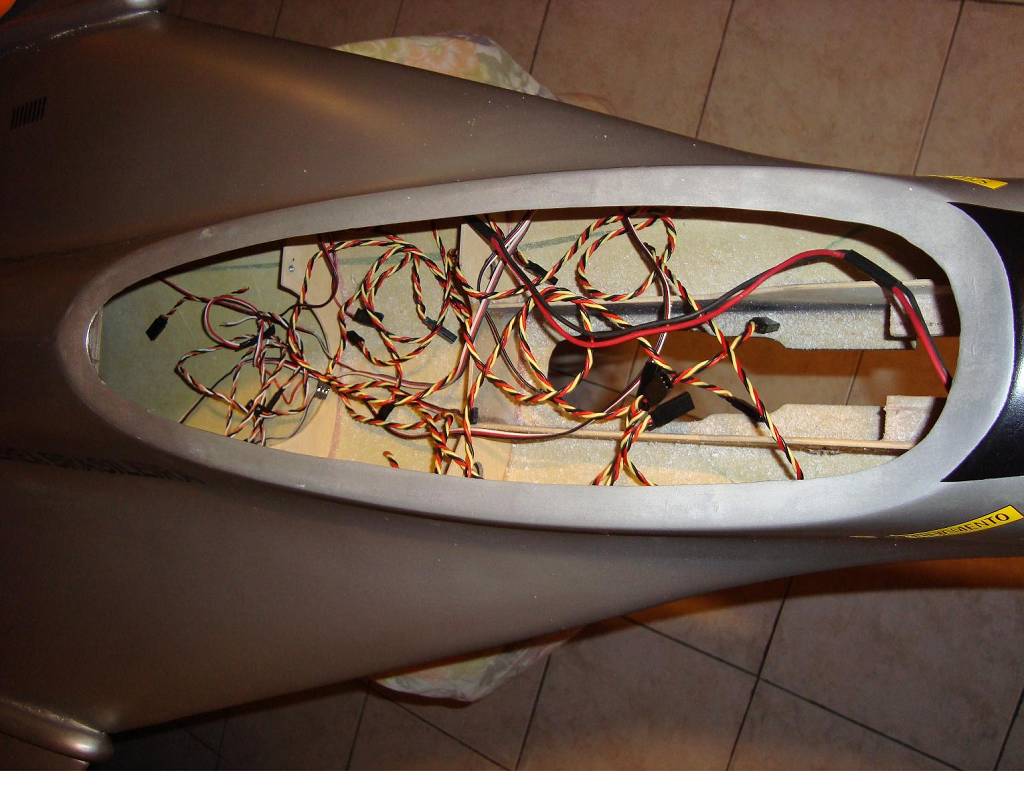

powerbox anyone? no thanks, I prefer my auto-organizating systems...

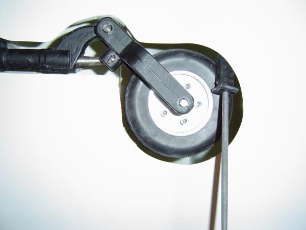

I had a custom set of trailing link struts made for my Hotspot. I believe the springs are too soft on the main struts as they deflect back on the takeoff run/fast taxi and the worst part of that seems to be that it changes the cg relative to the axles causing the it to be hard to rotate for takeoff. I can't get any help from the guy who made them for me as he has disappeared, left rc. I will need to get the length of these springs measured and see if anyone has any suggestions for getting stiffer ones.???
I will take some decent pictures of my struts, for you all to see .
Roger
