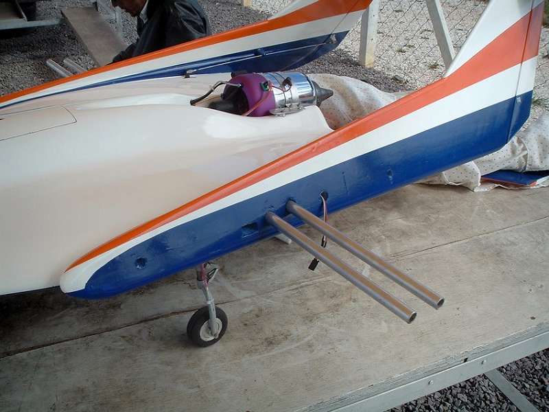

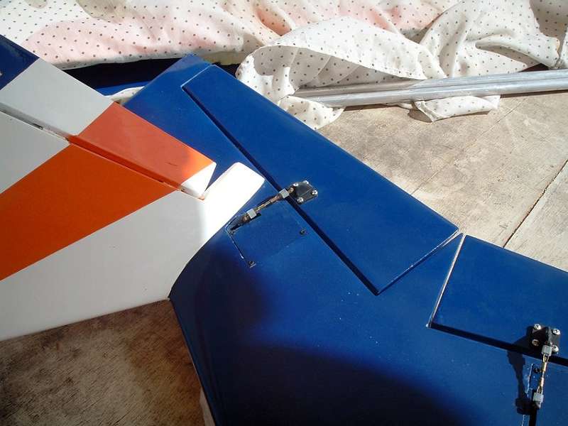

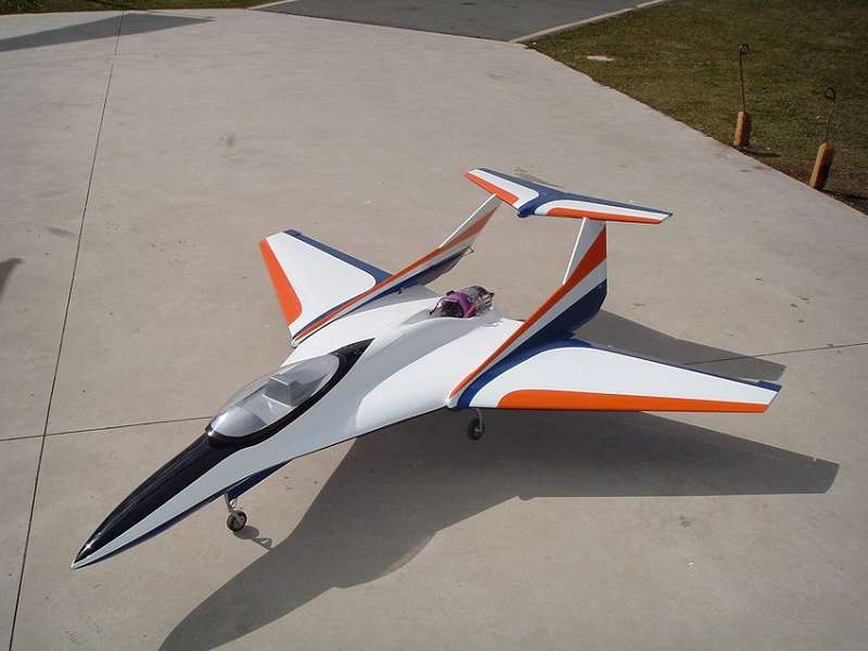

Hi to you all, I want to share with you guys some pics of a modified Hotspot, we are calling it here Hotcat. This plane was inspired in the BVM bobcat, the Tango and the Rig from Eddie Weeks. the plane was just finished and I am going to test flight it in the next weeks. The specs are: 78" wingspan, 91" lenght, 23 Lbs dry weight. a old p-80 was selected for the initial flights, and there is a p-120 ready for it if everything goes well! :-)

Looks very cool! But what part of it is Rig inspired?

how about doubling up on the wings one on top of the other, roots at center, and give the bottom one -15-20deg of dehidreal, and upper the oposite of positive ! go for the X-Wing look ! .....
let us know how it flies !

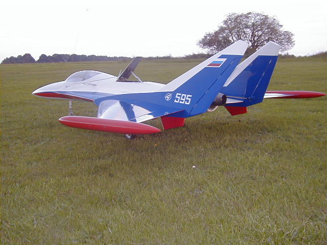

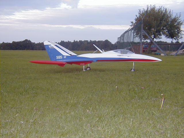

hi, i have also some pics of my modified hotspot, in su27-look of corse....
hope it works
harald huf www.su27projekt.de

Hi Wocketman, the Rig was certainly a main inspiration of this project, because of his engine disposition, his twin booms and the elevator at the top of the rudders. I didn't intend to go VTOL
yet, but Eddie's disposition to try new things and doing it very well was also a inspiration.
Regards, Enrique

Hi Harald, you can't go wrong with this mods, It sure looks good too!

Sure you will know how if it flys well or not, I am anxious about this too, to say the least!
now, let's hope that the tie fighters didn't show up at our club!
