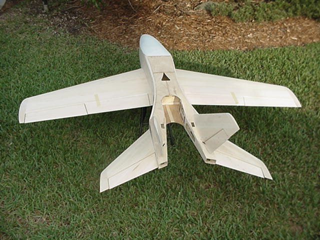

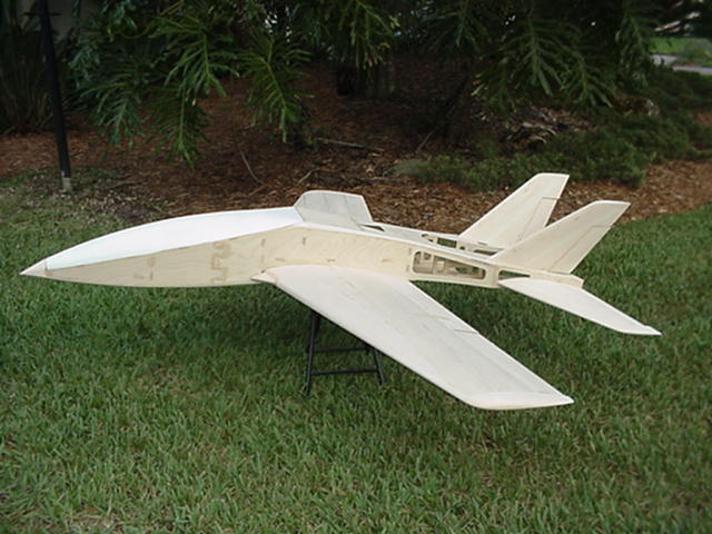

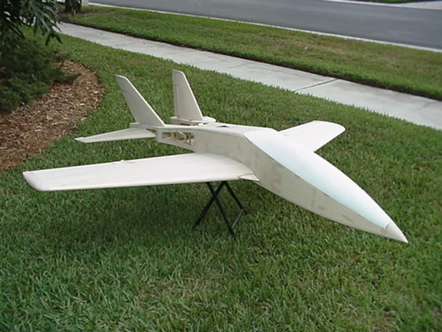

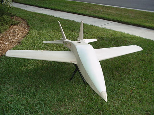

DV8Rs,
Here are some images of my DV8R RTC although not quite like it came out of the box (smiley).
I will comence ultracote operations tonite to the tunes of AC/DC per factory recommendations.
I am still on course to complete the ultracote cloud prior to FIJR. Let the fun continue.
Jay Smullen

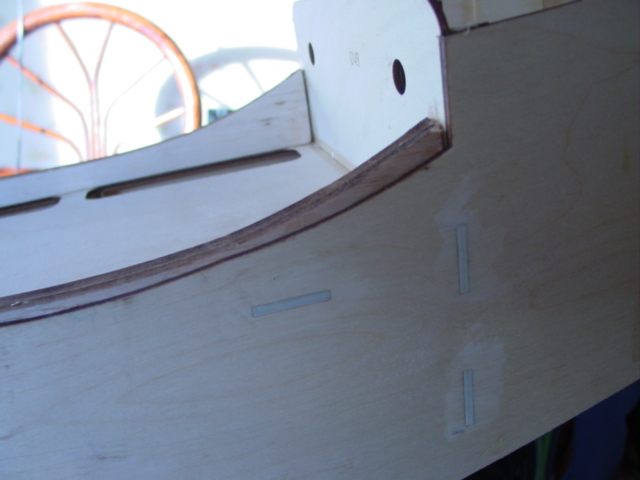

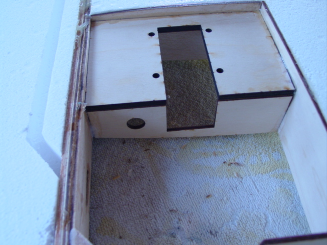

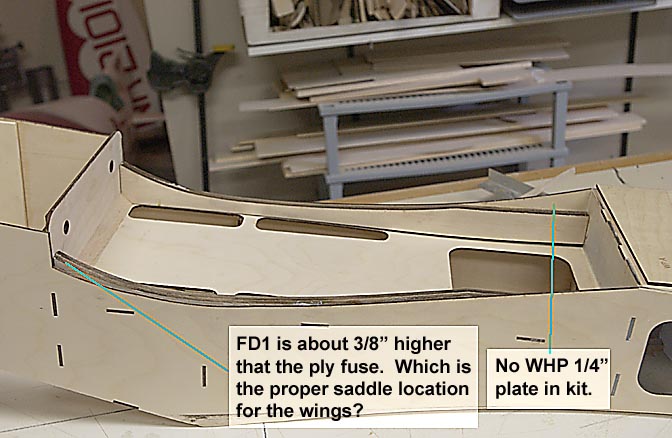

Pat asked if I had any question to post them as it will help others during construction. So here goes... I went to install the FD1 balsa formers to the wing saddle area but they extend about 3/8" above the fuse in the front. This will change the wing incidence a fair bit so I was wondering which was correct, the fuse of the formers. I also noticed there's not WHP (wing hold down plate) in the kit and there's no mention of it in the parts list. That got me to thinking maybe this has something to do with WPa and WPb, which I have no idea how they are mounted lol! I know the idea is to prevent the wing from moving and alignment, but their installation escapes me. I can just cut a WHP from scrap, but a picture of how the WPA and WPB are mounted would be great! Oh ya, this jet is going to be very cool when it's done
Shaun Bell

Shaun,
I sanded the balsa wing doublers down to the plywood fuse sides at the same angle the the top of the wing hits it. If you are missing the wing hold down plate just cut one from a piece of 1/4 inch thick plywood. I will take a picture of mine tonite and post it tomorrow morning for you. I will measure the length of the plate for you also. The hold down plate is secured by the precut balsa triangle pieces. I will also send a picture of the flap servo and linkage.

Unlike the prototype (lightening holes in the center of the fuse) shown in the instructions, all the lightening holes are located in the tail booms. There's 8 to fill in so you might be better off going with the covering. I prefer paint for most my model as well, but for a rough field sport jet lightness wins over looks. Monokote and Utracote have some pretty cool colors... Just put the gun down and plug your iron in LOL.

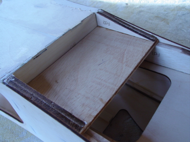

Hi Shaun, I echo your comments, also had to guesstimate which way up the wing goes from looking at the root section.
Could also have used a little more detail for construction of the u/c mounts so I may have got things a little wrong in this area, perhaps Patrick could comment. 8 u/c anchor nuts were also missing.
On the whole though an excellent quick build kit which I am very much looking forward to flying. Any of you got any color shemes yet ?

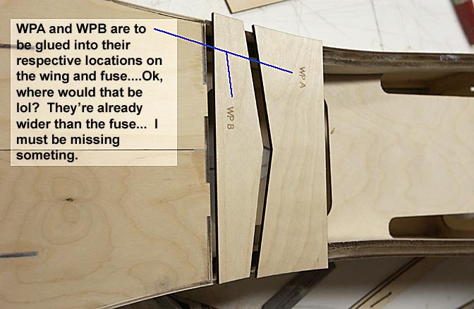

Jay,
The pictures will be great, now if I could just find some 1/4 ply kicking around. I 'm getting low on scratch build supplies lol. Could you shoot a picture of how WPA and WPB are mounted? I just skinned the wings and fins so there's a little work ahead yet. BTW, how did you fins turn out with a 1/2" overhang? I found with the 1/16 sheeting, it was a little flimsy. I think I'm just going to trim most of it off as it shouldn't make too much difference. How's that color scheme coming? I was thinking of copying something from my old MavPro. This might actually look better with twin tails.
