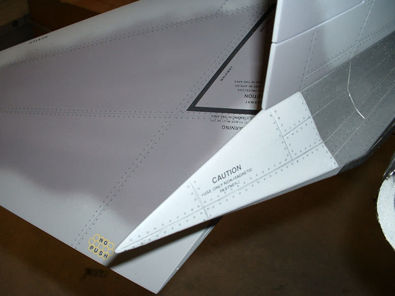

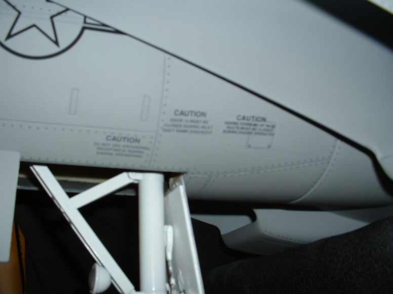

It's kinda funny....I am in the middle of putting Aeroloft transfers on my SM F-15 right now. I thought I'd take a break and see what was shaking on RCU. Let me toss it around with the suits and get back to you.
BTW....where do all of the "no step" and "warning" transfers go?![X(]

a few examples, you will have these on your Aeroloft transfer sheet

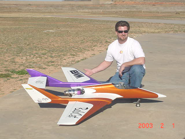

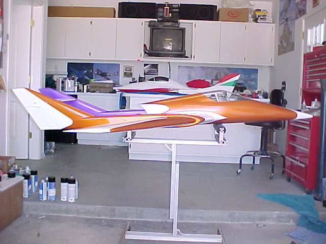

I bought gal sizes to do multiple planes, Here is the website if you want to read about the paint.
http://www.autobodysupply.net/Matrix/Matrix.htm
What I have done is gone to the paint store and had them mix the colors I wanted in spray cans. (about 10.00 a can-- usually takes 5-8 cans depending on the paint job and size of plane.)I Paint the colors with them, it is easier for me than mixing paint in the spray gun especially if I am using multiple colors. I then Spray the clearcaot with a spray gun. I painted my bobcat the same way and it turned out very nice.
