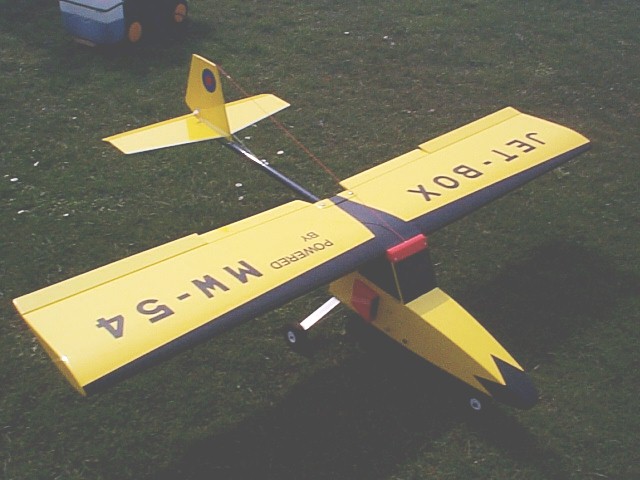

Does anyone know where I can get brakes to fit standard wheels (dubro,robart etc).
I am building a jet trainer (Jet-1 from Wren Turbines)
and don't want to go the the expense of BVM or glennis wheels. I am sure I have seen an advert in one of the magazines somewhere. Any input would be appreceiated.
Tom Watson

Default Wheels
Kevin,
thanks for your post. The model I am putting the wheels on will weigh no more than 10 pounds dry. It is a high wing trainer for my Wren 54. I was not going to use brakes but I think it will help me get used to their use.
I have Glennis Wheels on my Sabre but I don't want to use them. Also the Main gear is a regular alluminium gear, so most jet wheels won't fit.
regards
Tom Watson
Sydney Australia

Wow, now there is something different!
Old 07-07-2002, 03:32 PM
Woketman
Join Date: Dec 2001
Location: Slidell, LA
Posts: 5,432
Received 8 Likes on 6 Posts
Default Brakes for standard Wheels
Cool, "Jet Box"! I love it!
