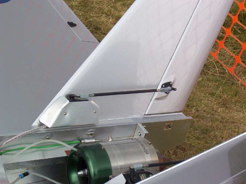

found a reaper with rudder control on it so i took some pictures they had lead in the top of it for balance .going to do mine this week also my reaper in the back ground no cannards on it flies great but needs a rudder

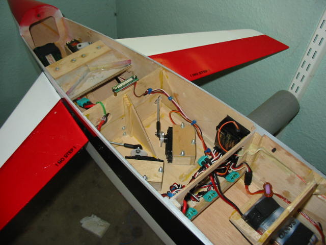

RE: Reaper: magnitude for control surface throws?
hi DJ, here is my ruder setup, just for inspiration:
I'm using lead for balancing it aswell, just as Mick sugessts.
and the carnard setup aswell, since I deffently did not belive in Mick's standard construction.
